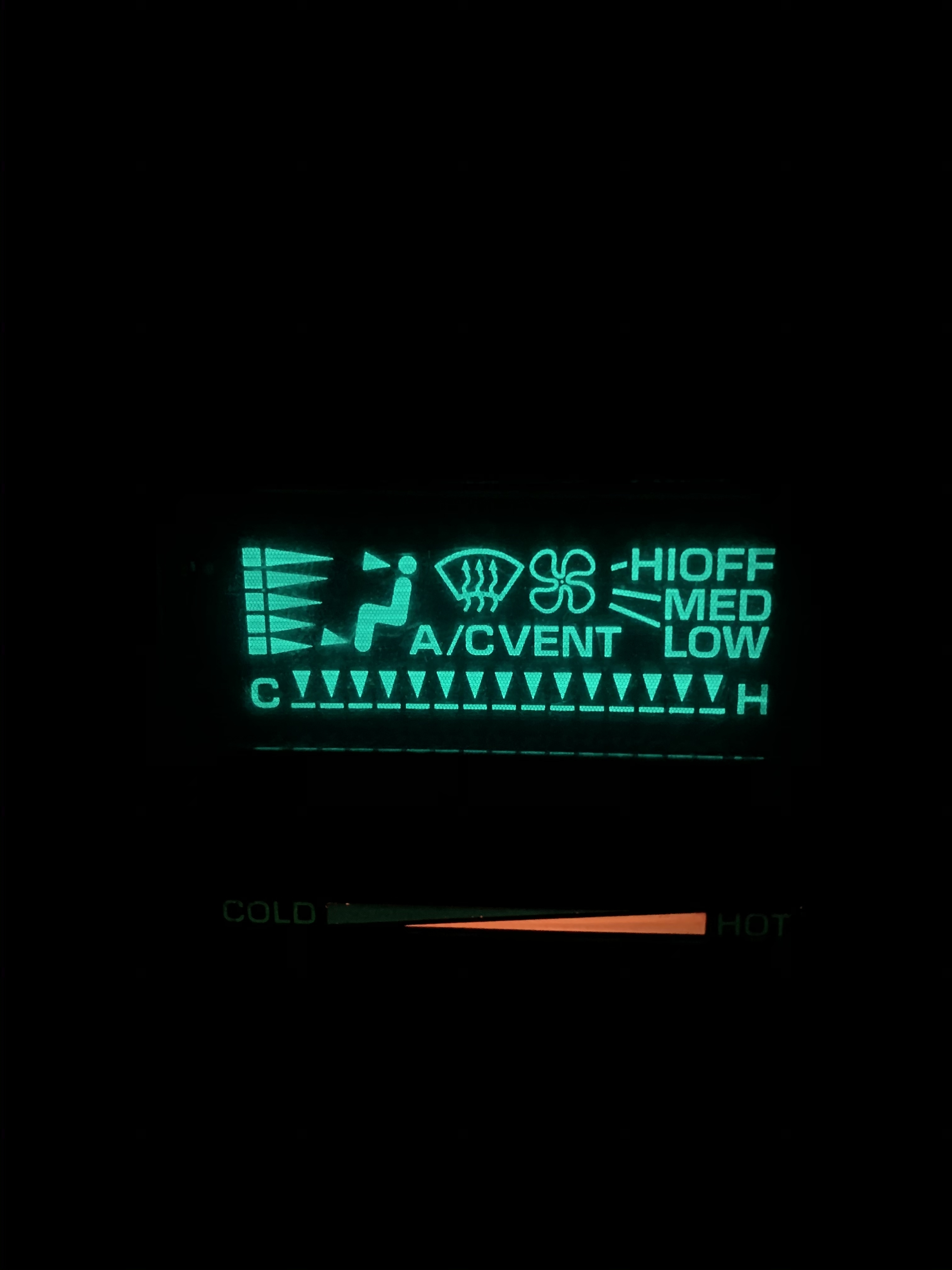

Just bought the truck listed above 1500. The blower fan was apparently getting stuck. Sometimes it would work Sometimes it wouldn’t. Usually it would stay stuck on one of the 3 positions-High, Med, or Low and not shut off. My husband replaced this whole module, and now the whole display lights up all at once. You can’t select anything, it just stays lit up.

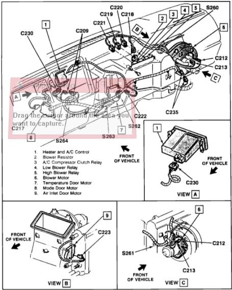

Sure thing, hopefully it will work but you always have to be careful with used electronics there is no real way to tell if they are good until you install them and they can be damaged in either shipping or when It was removed from its original home.
In view A in the upload below there is the control for the heat, is this the part you bought? If it is doing the battery thing wont deal with it.
Are the fans turning on and the system is working and just the display is haywire or is it not turning on?
Let me know,
Tom

That looks like the part we replaced. We haven’t tried the reset with the battery cables yet. We should have time this weekend to work on the truck. We were going to pull the module back out and inspect the wiring and plug and try the reset.
The fan does turn on. And you can change where the air exists the vents- floor, dash, defrost. It appears to blow hot air all of the time but our weather has been nearing the 100 deg range, so it’s hard to tell if it is the outside air temperature or actually producing heat. The A/C wasn’t working when I bought the truck and hadn’t been working for several years. Right after I bought it and before we replaced this module, I had our mechanic diagnose some problems for me. He determined we need a new compressor kit and condenser. We were going to order we these parts this weekend.
A couple times this week, the display has gone dark. So it went from everything lit up to nothing at all. I will check it later and see if it lights back up when i start it. It was unlit all day yesterday, I probably turned the vehicle on and off a half dozen times over the course of the day. Thanks for your help!

All off, there might be a bad connection right at the plug. When you do take it apart again look into both the male and female sides of the plug for corrosion or debris of any kind..
keep me posted.

My husband took the part out this weekend. We did not see any corrosion or debris on either end. Just so happens we have an inoperable Chevy of similar vintage. He installed the module from the Chevy and it works without any problems so far. So we didn't determine what was wrong with the module we bought, but we have working controls now. Thank you for your help!
