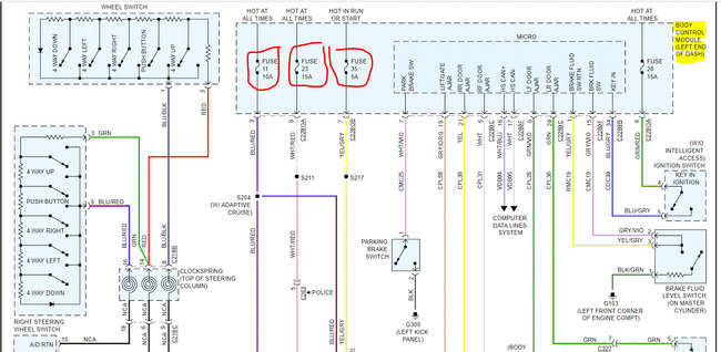

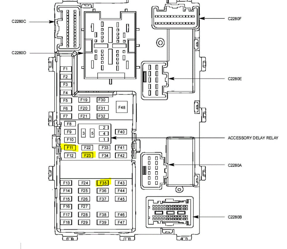

After a very hard freeze my SUV will start but the instrument panel is not working at all.
Feb 21, 2021 at 7:42 AM
  • 110,240 POSTS
If everything stopped at once, it sounds like an electrical issue. Looking through the wiring schematics, there are three fuses I need you to check. In addition to just checking the fuse, confirm there is power to it.
Here is a link to help:
If you look at pic 1, it shows the fuses that power the instrument panel. Pic 2 shows the locations of the fuses.
I hope this helps. Let me know what you find or if you have other questions. Also, let me know if there are any other electrical components not working.
