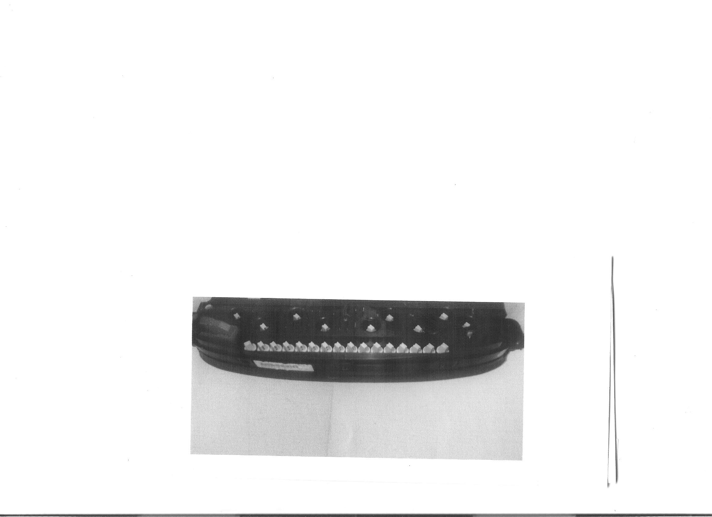

In winter when it is cold the top quarter of my instrument dash does not light up along with the other three quarters. Is this a bulb fault and if so which one should I change? It all comes back on after I have driven for about fiufteen minutes. Thanks for your help.

Hi, This may help. It is a copy of a Picasso Zara similar to mine. Thanks for your help.

It sounds like it is not a bulb problem because once a bulb is out it does not come back. I would say the driver inside the instrument cluster is bad I would try to find a used unit and install it to see what happens.
