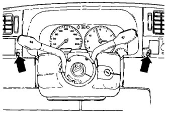

I will post the images in the order as the instructions.

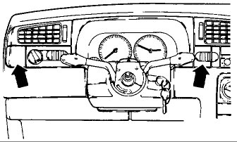

Carefully pry off left-side trim panel (left arrow), press release button on side of light switch and remove light switch -E1-. See: Lighting and HornsHeadlamp SwitchService and Repair
Carefully pry off right-side trim panel (right arrow).
Note:
Left and right-side trim panels may be replaced by additional switches or warning lamps, depending on equipment level.
On vehicles equipped with heated seats, the driver's heated seat regulating switch -E94- and passenger's heated seat regulating switch -E95- are located on the right side of the instrument cluster.

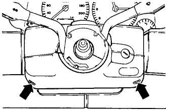

Remove screws (arrows) and remove upper part of steering column trim.
Remove two screws (arrows) from instrument panel.

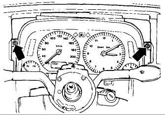

Remove mounting screws (arrows) from instrument cluster.
Tilt instrument cluster downward.
Disconnect two multi-point connectors from back of instrument cluster.
Remove instrument cluster.
