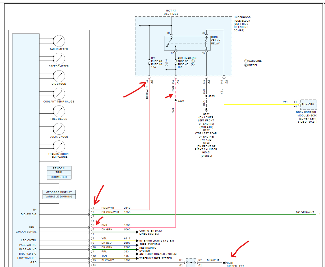

How can I tell which is positive and which is negative on the circuit board?
2007 CHEVROLET SILVERADO
123,456 MILES • 5.3L • V8 • 4WD • AUTOMATIC
JCAMPN05
MEMBER
1 POST
Instrument panel.
Feb 17, 2025 at 12:11 AM
Experienced Mechanic
55,649 POSTS

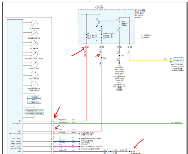

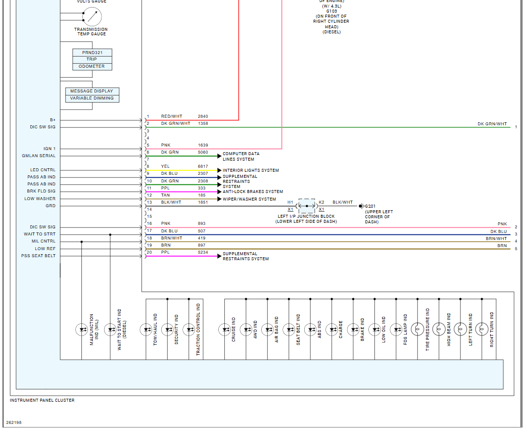

Sure, here are the power and ground locations for the instrument cluster which I have marked in red for you. Check out the images (below). Let us know if you need anything else.
