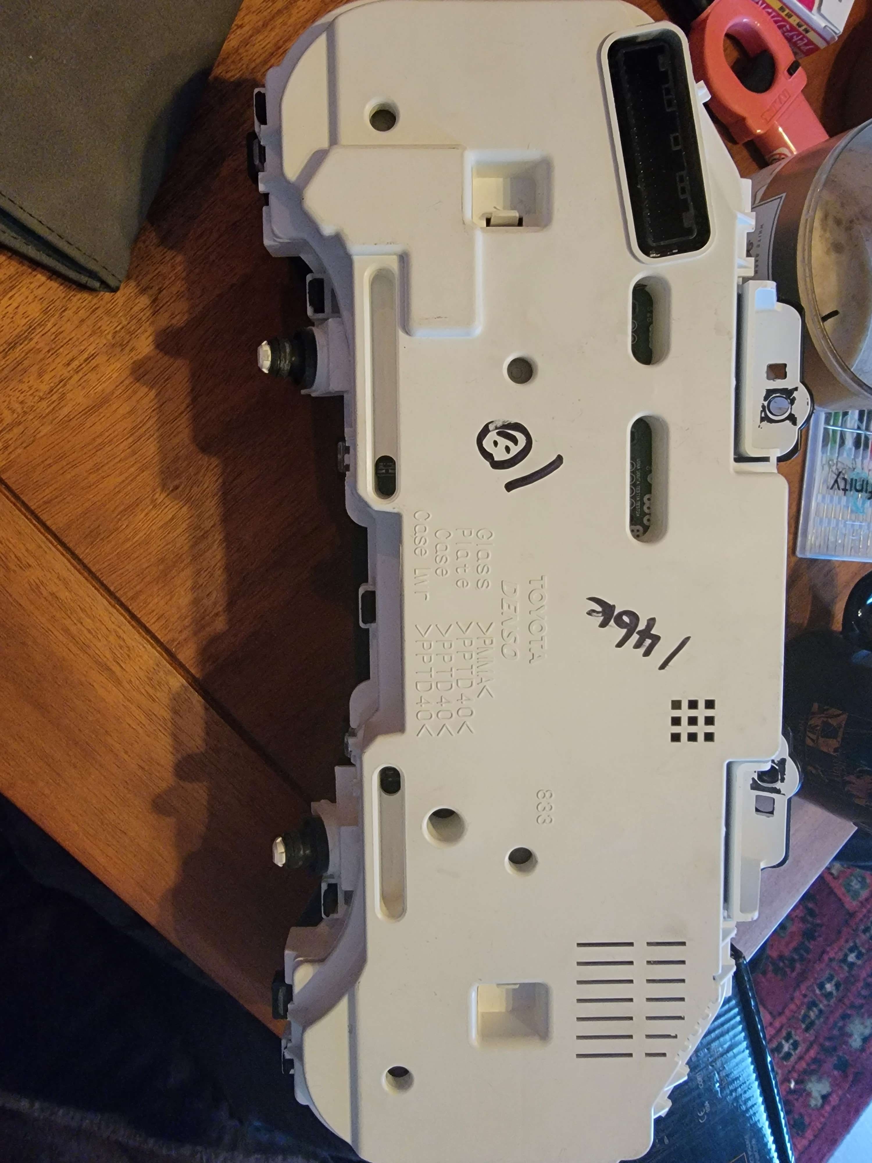

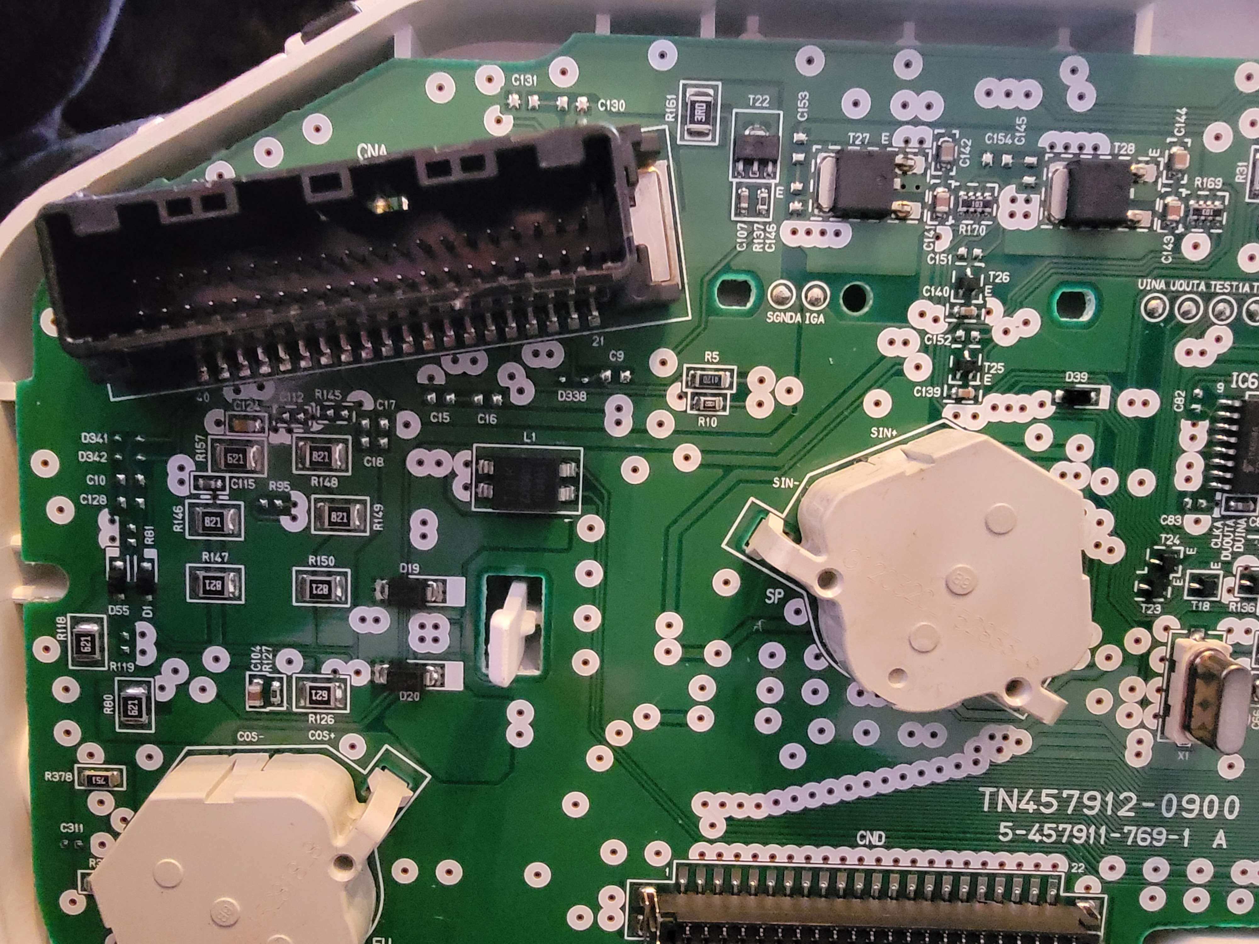

Hello, I have an instrument cluster for the car listed above. I would like to set it up on a test bench for research, but I cannot find information on the pins. I just want to power on the instrument cluster and connect to the CAN pins on it, but I cannot find out which ones are the power pins and which ones are the CAN network pins. Any help is appreciated.
The only connector on the device is a 40-pin connector, with 20 pins in each row.

Hi Joe, thanks so much for the quick response. I believe the one I have is a TMC, but I've attached another photo. Could you confirm that my suspicions are correct? Thanks for all the help.

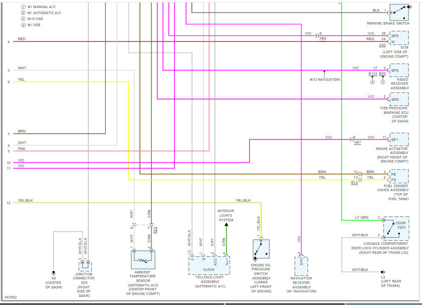

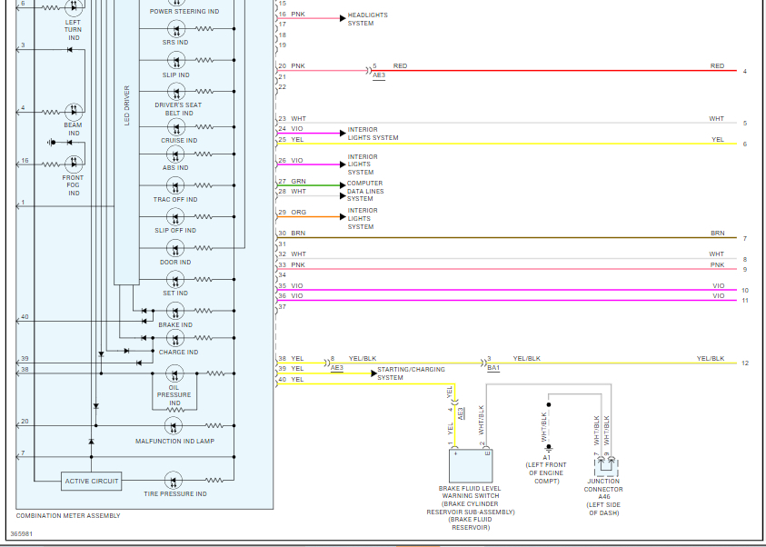

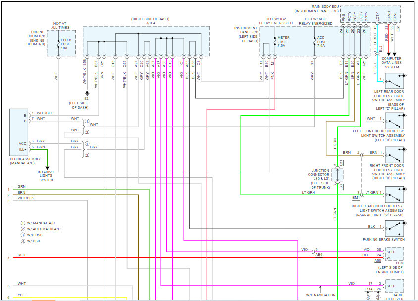

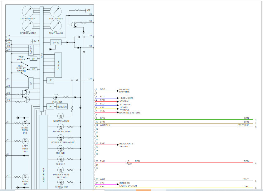

I went through all the cluster connector views and none are 40 pin. When I look at the wiring schematic, it shows there are.
I attached the schematic below. Let me know if it helps.
See pics below. Note: There were two pages of schematics for this. I had to cut each page in half to make it readable. I did overlap them so you can follow from one to the next.

Hello, thank you again for your help. I think I was able to identify the pins that hold the CAN bus data in this connector. I'm not sure how to power on the device though. I have a 12V power supply that I could connect to the GND and 12V pins, but i don't know which ones those would be on this device. Do you know how I could find those?
Jan 5, 2024 at 10:43 AM
  • 110,244 POSTS
If I'm reading the schematic correctly, power from the meter fuse goes to pin (pink wire) at the combination meter (cluster).
Let me know if that helps.
