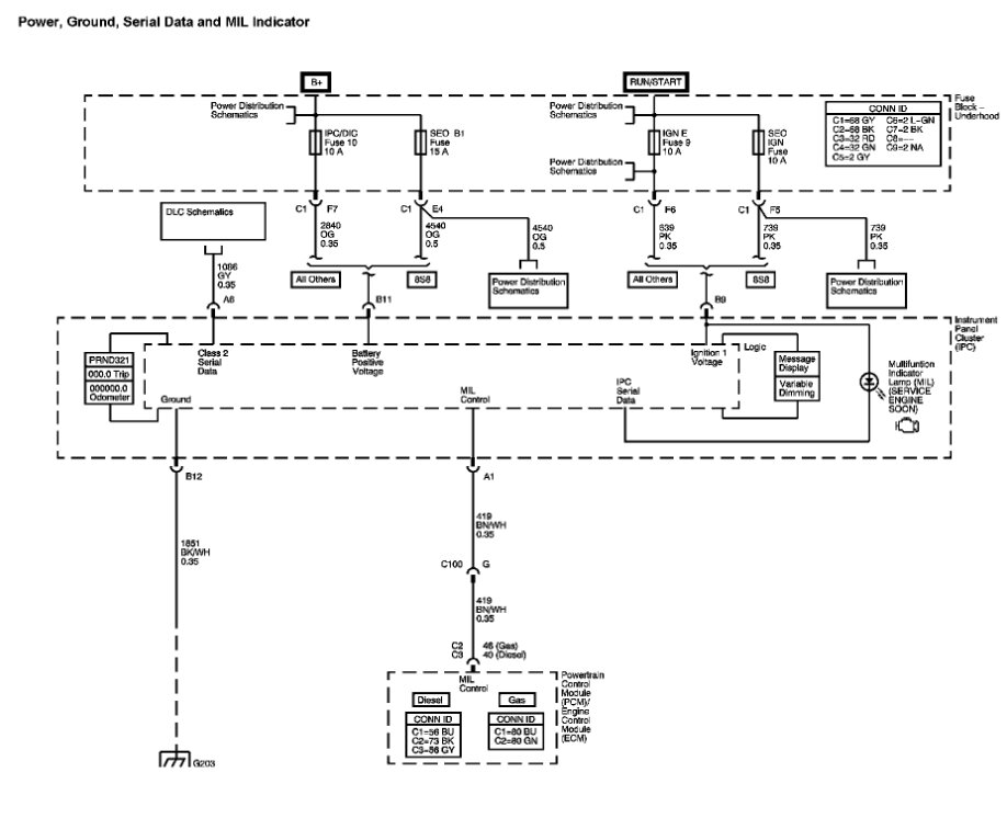

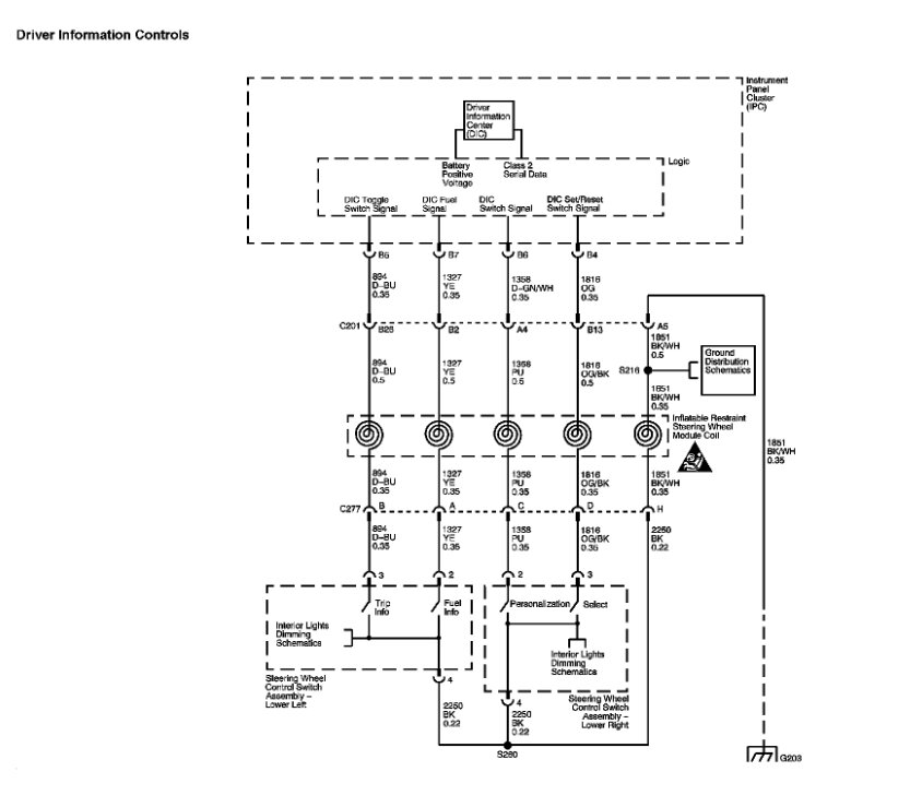

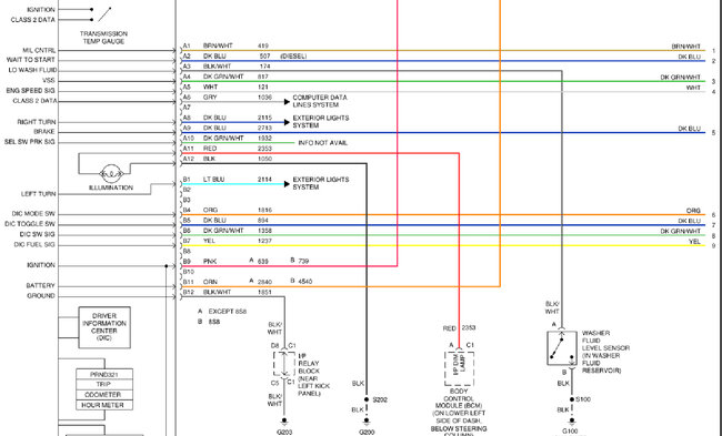

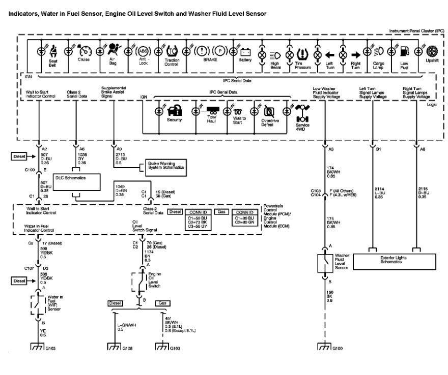

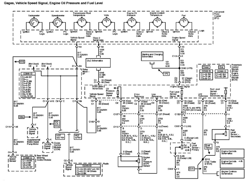

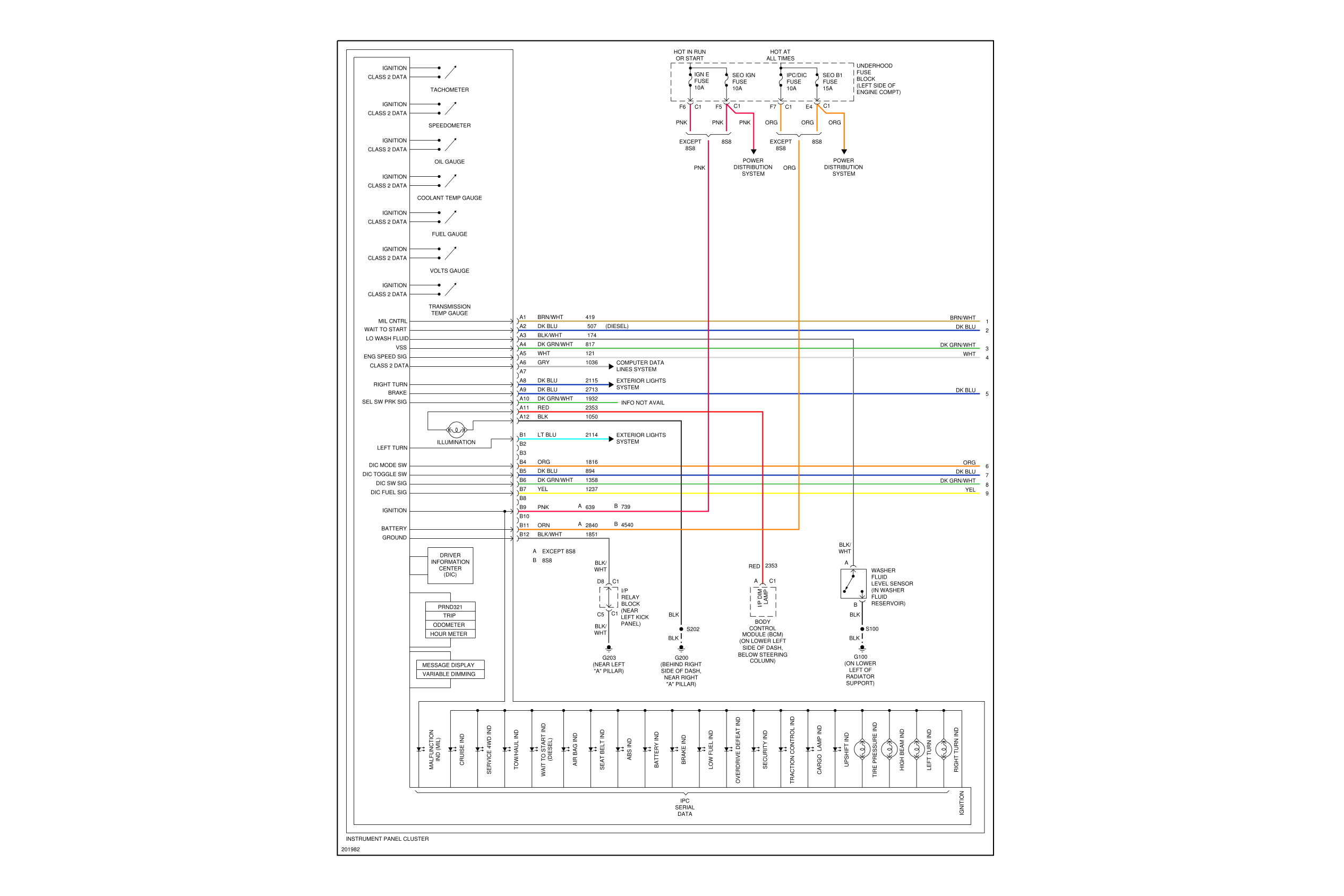

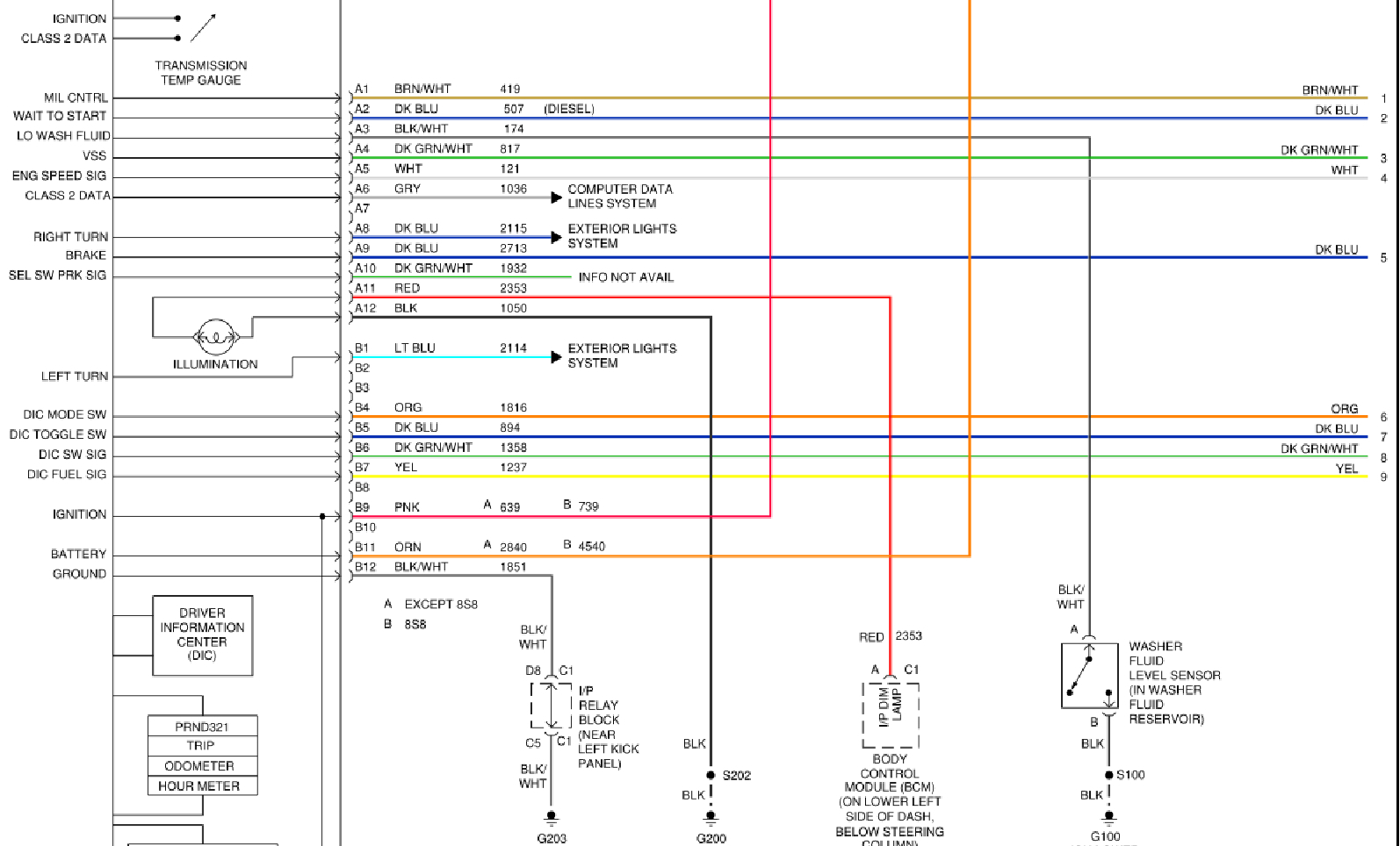

All of the wires are out of my instrument cluster wiring harness, and I can't seem to find an accurate pinout to put them back.
Jun 13, 2023 at 5:19 PM
BORIS K
  • 836 POSTS
See below images for the wiring diagrams.
Please let us know if you need further information.
Cheers, Boris

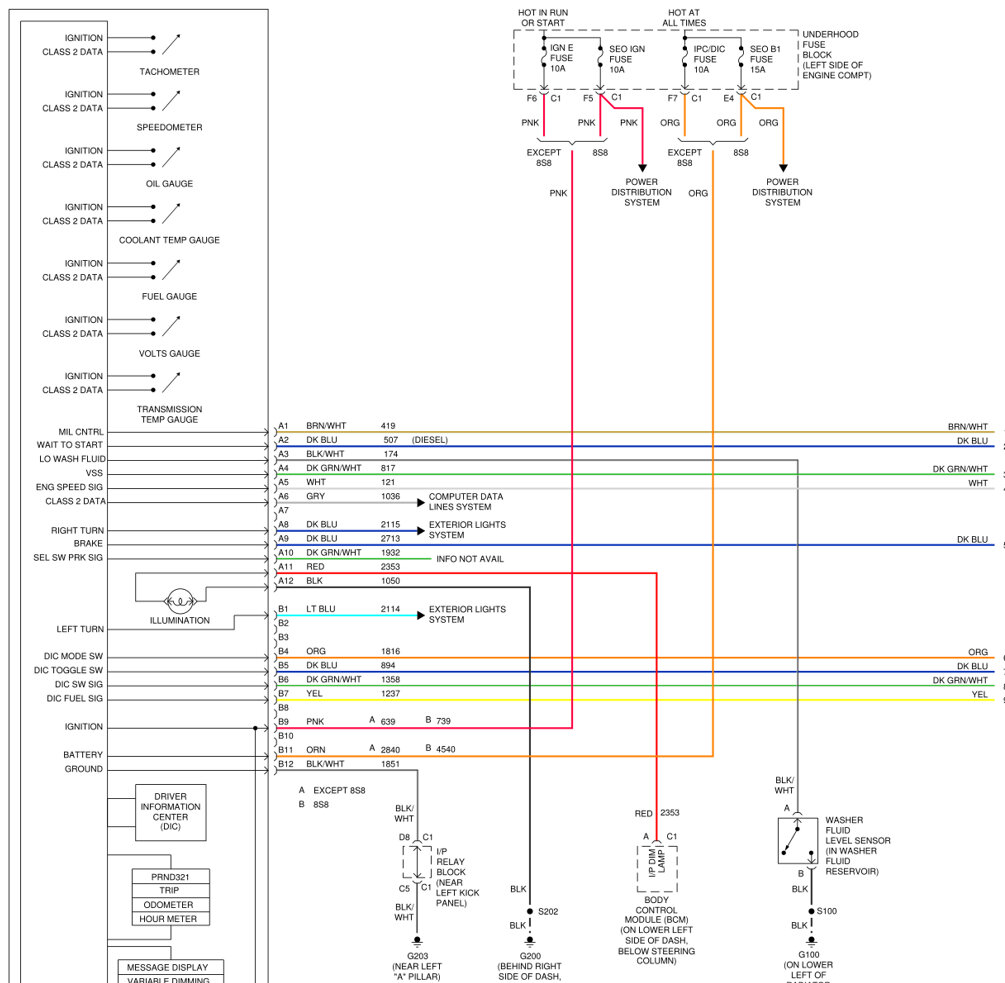

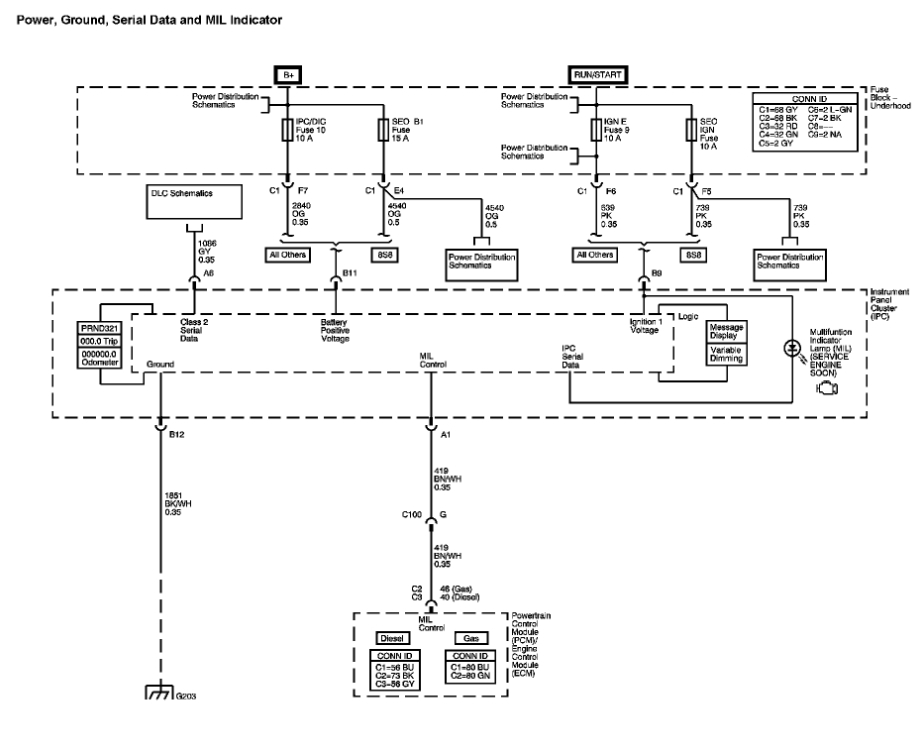

I just looked at the wires and mine didn't match. I have 1 light blue, 2 dark blue, 3 green and white. The white strip is slightly different on each one, 1 pink, 1 red, 1 yellow, 1 brown and white, 2 black and white, 1 black, 1 grey, and 1 white.
Jun 14, 2023 at 4:43 AM
BORIS K
  • 836 POSTS
No matter which wiring diagram I look at they do not match your description.
Below please see another set of diagrams from a different source.
They also do not match your description.
Hope these help.
Cheers, Boris
