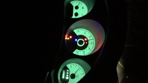

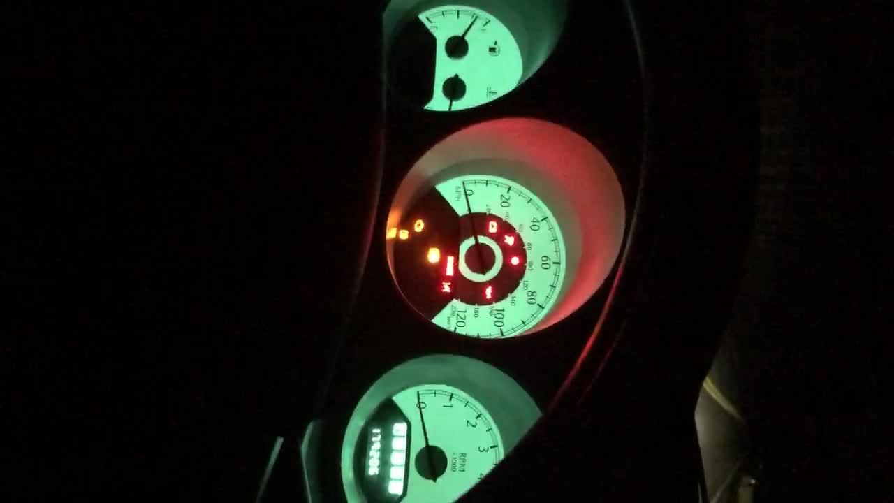

I’m seeking some help or ideas for my car listed above. The warning lights on my instrument cluster all come on and off while I’m driving the car. I’ve changed the TIPM, PCM and even the instrument cluster itself and still have the same problem. I’ll attach a video to show what I’m trying to explain.

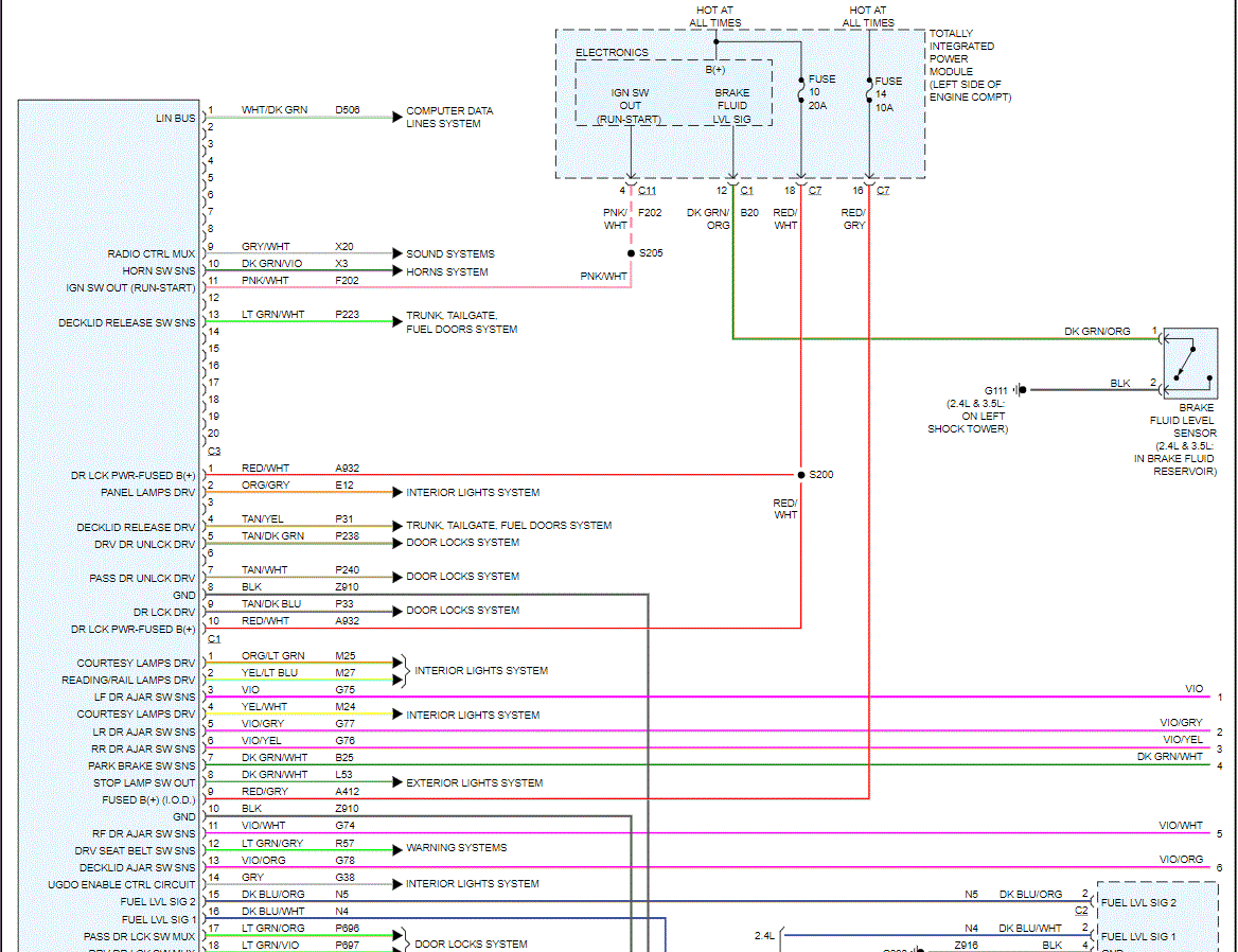

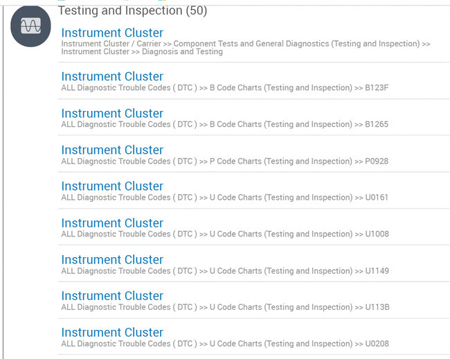

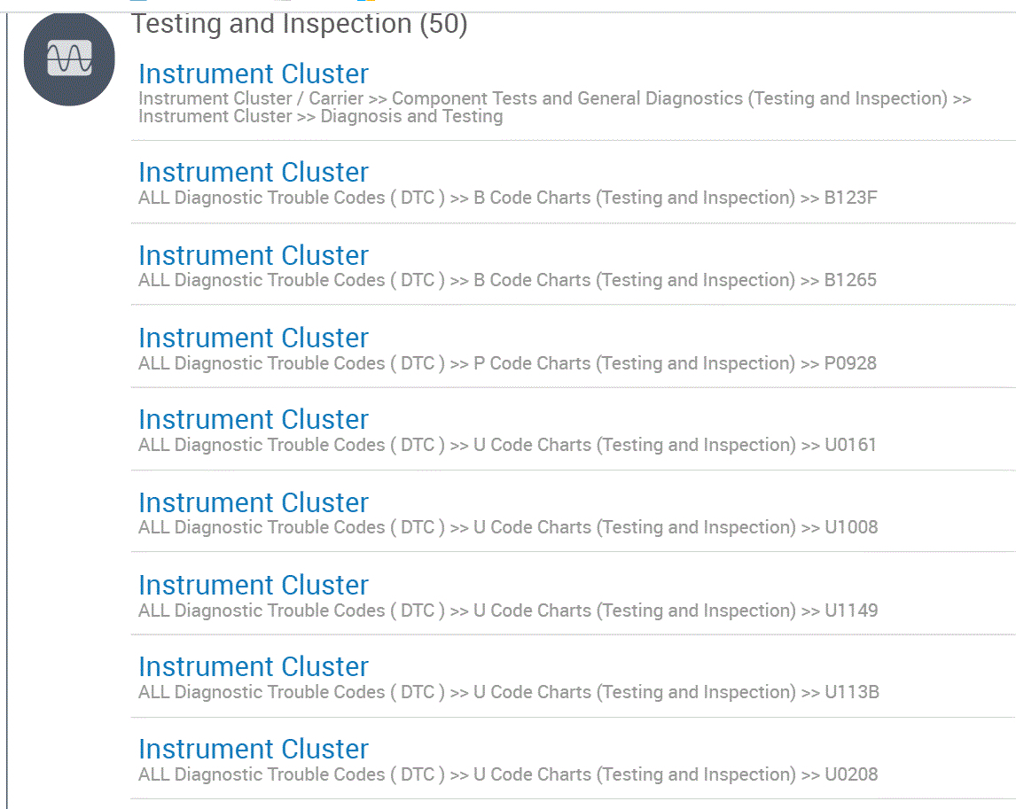

The first thing I'm going to recommend is to have the can bus scanned. CAN stands for controller area network. Basically, the modules/computers are tied together with a few wires. This will help identify any fault codes regardless of the module.
This is likely going to be a B-type code and not a powertrain code. If you look at pic 1 below, I just attached a few examples of instrument cluster faults. If we don't have a code, it could be a long time until the fault is found.
Now, before you have the can checked, I want you to confirm the charging system is properly working. If the voltage gets too high or low, it causes all kinds of issues. And yes, it could cause this.
Here is a link that explains how to check the alt output. Please make sure battery terminals are clean and tight also.
Let me know what you find with that.

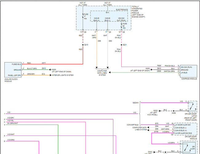

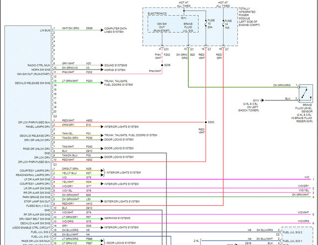

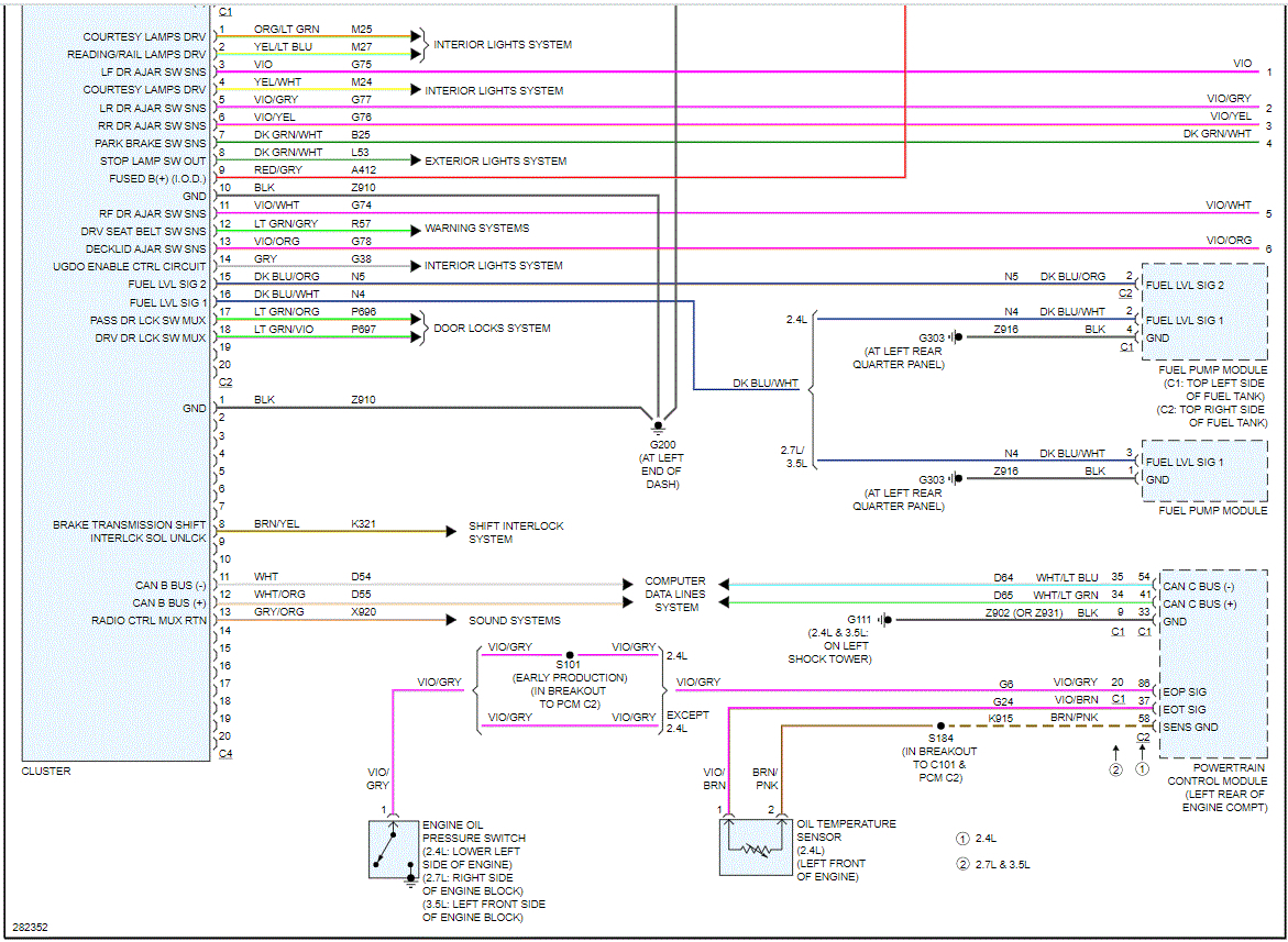

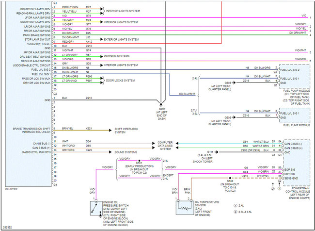

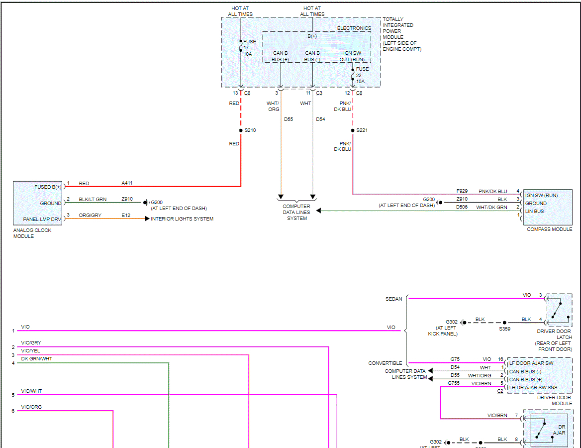

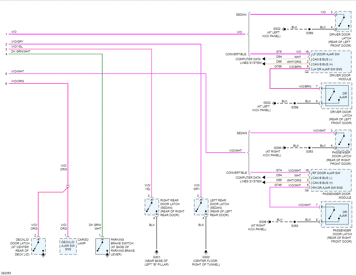

One last thing. As a reference, I attached the wiring schematics for the instrument cluster. Take notice there are wires identified as computer data lines. That is the can system. Any of those could be failing as well.
Here is a link you may find helpful if you jump into checking the wiring:
