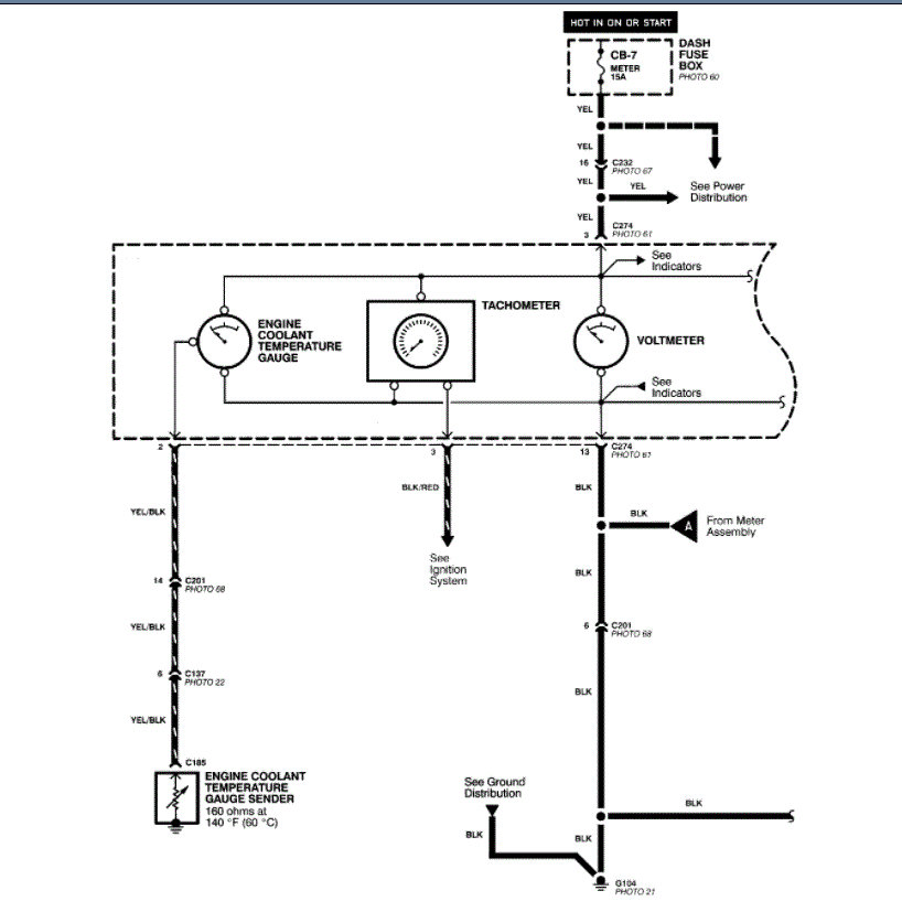

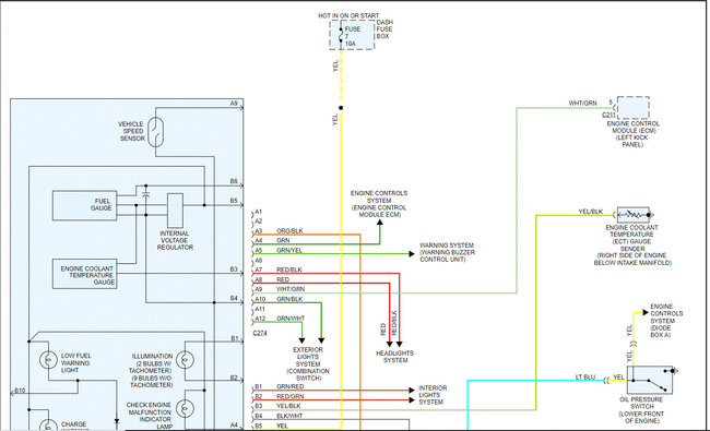

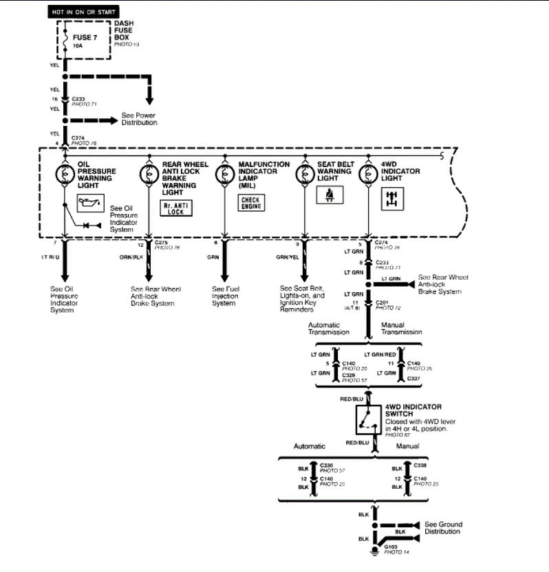

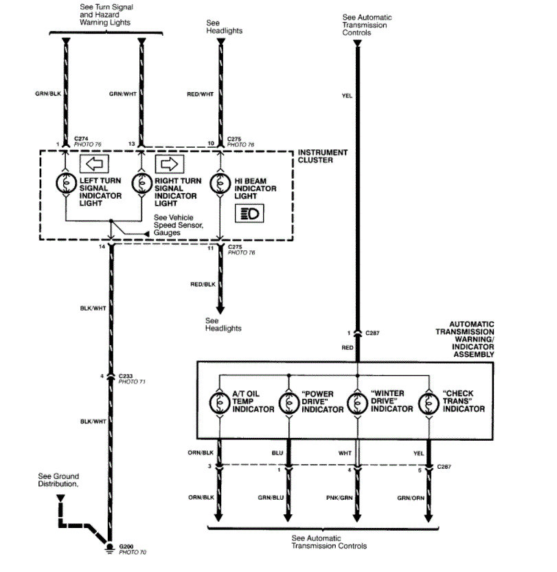

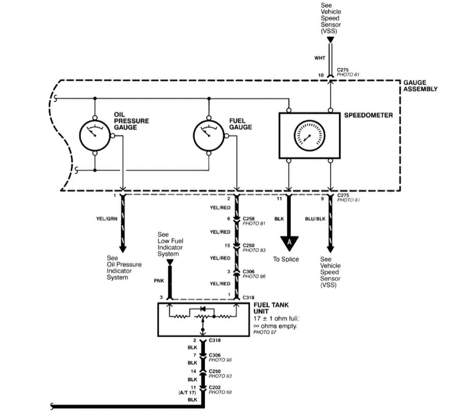

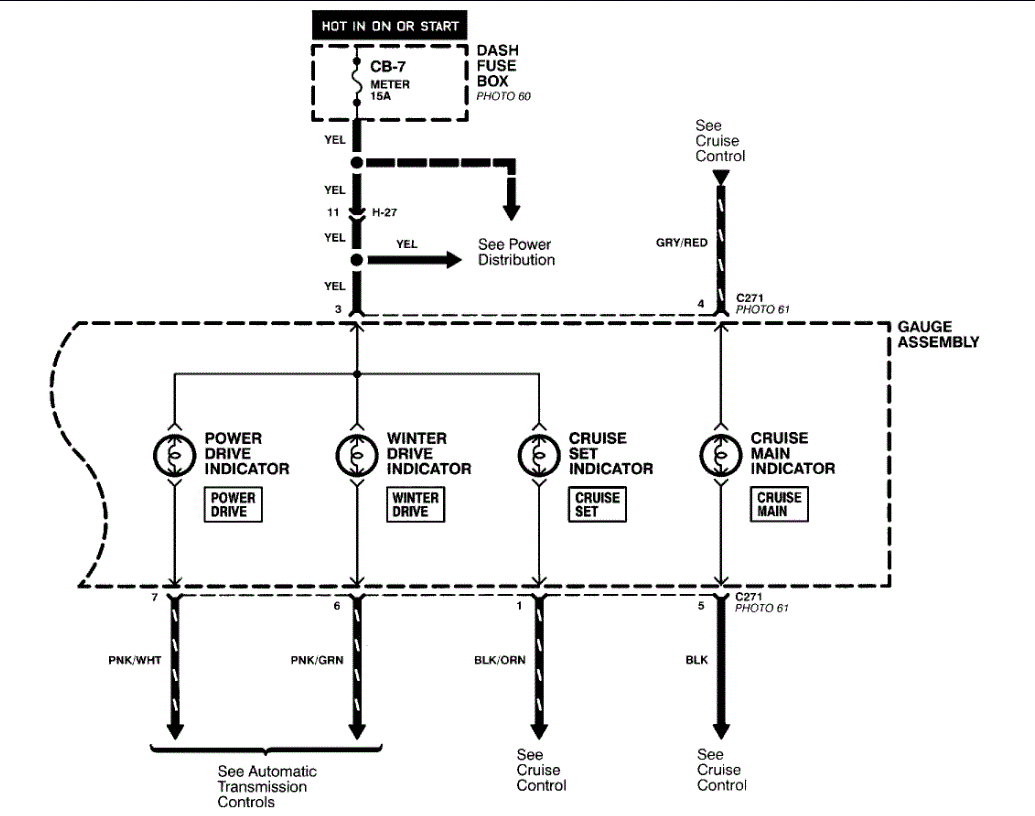

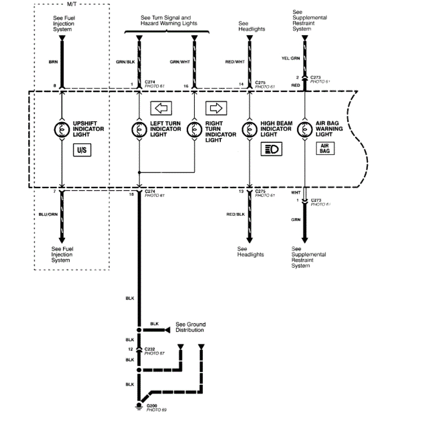

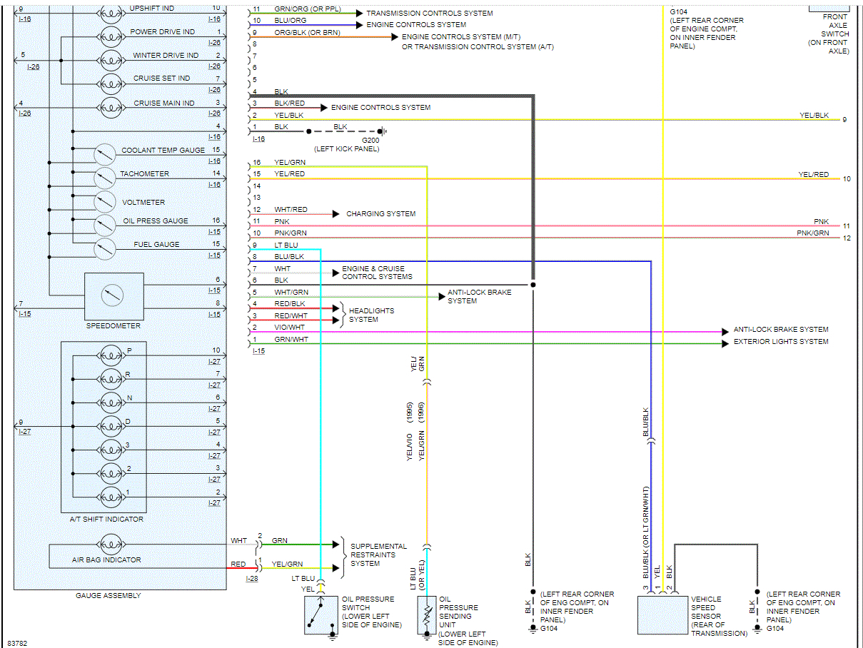

I'm moving a '95 Rodeo instrument cluster into a 91 pickup. I'm doing so as part of an LS swap I'm doing and I need, at a minimum, a good speedometer. The LS PCM can provide the signals needed, but I need to know how the wires that are existing in the truck line up with the new cluster. a good pinout will help much.
Thanks.
Oct 15, 2021 at 6:27 AM
  • 110,244 POSTS

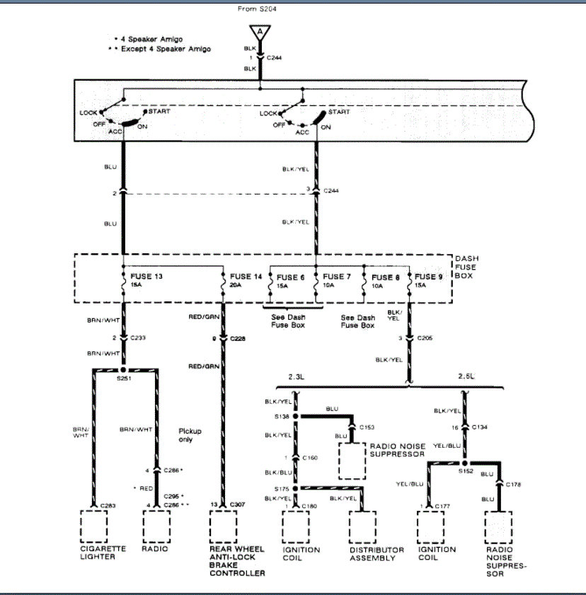

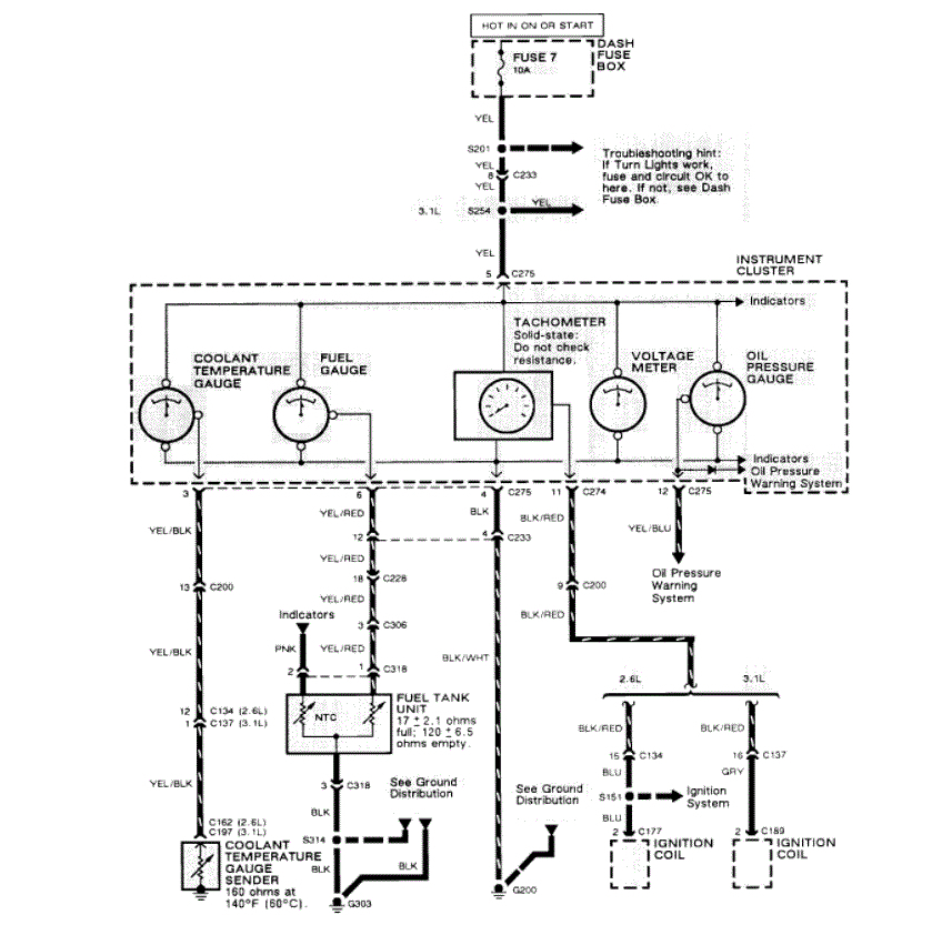

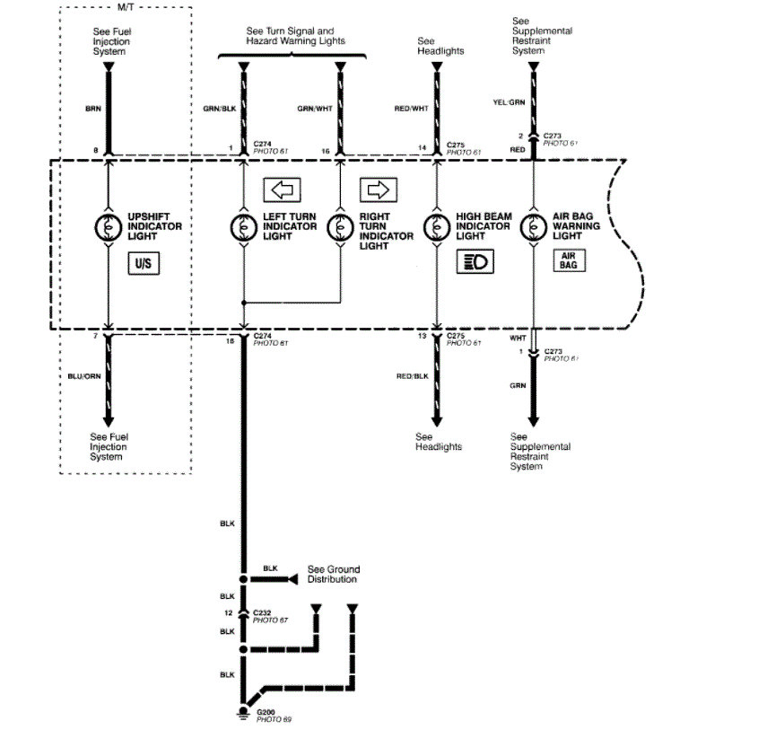

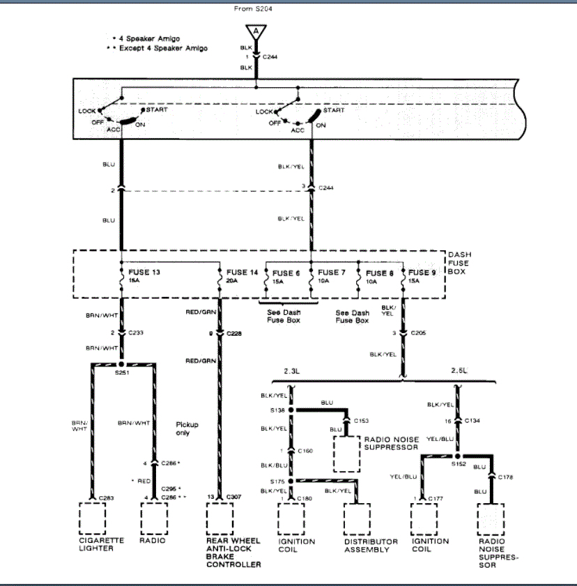

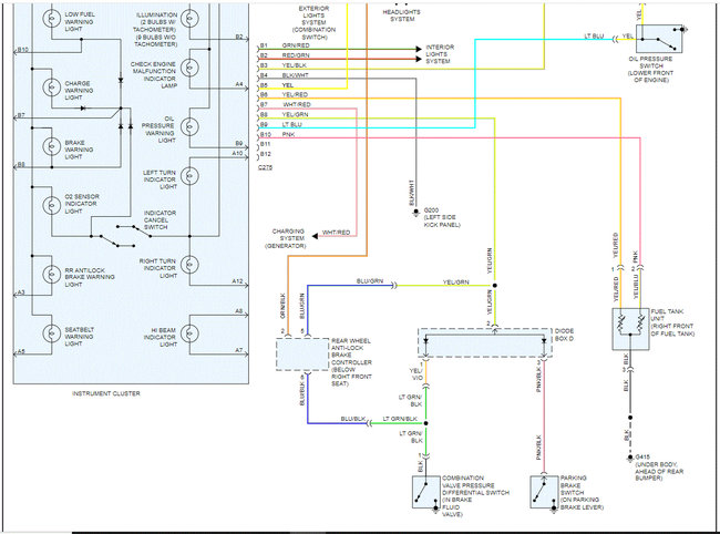

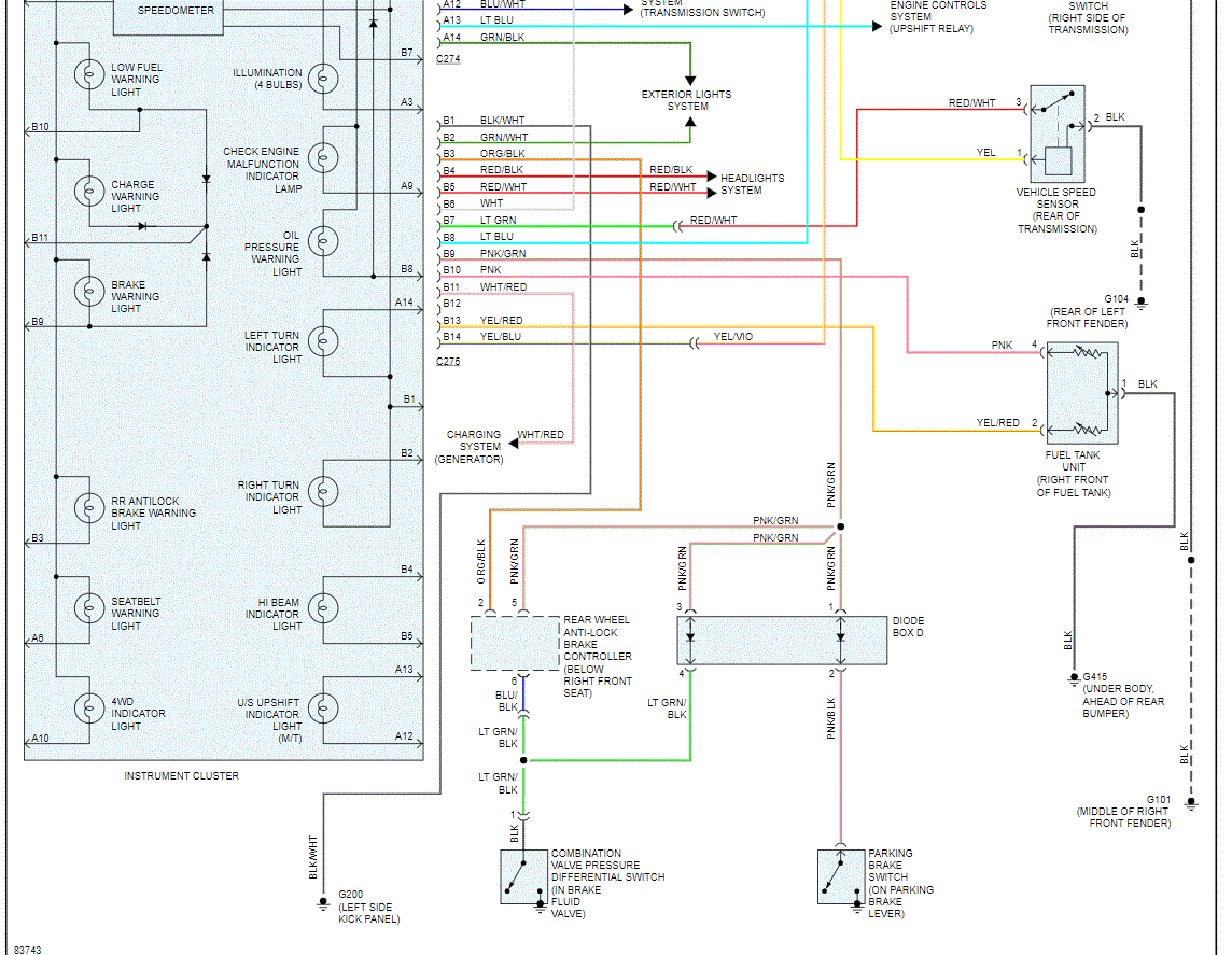

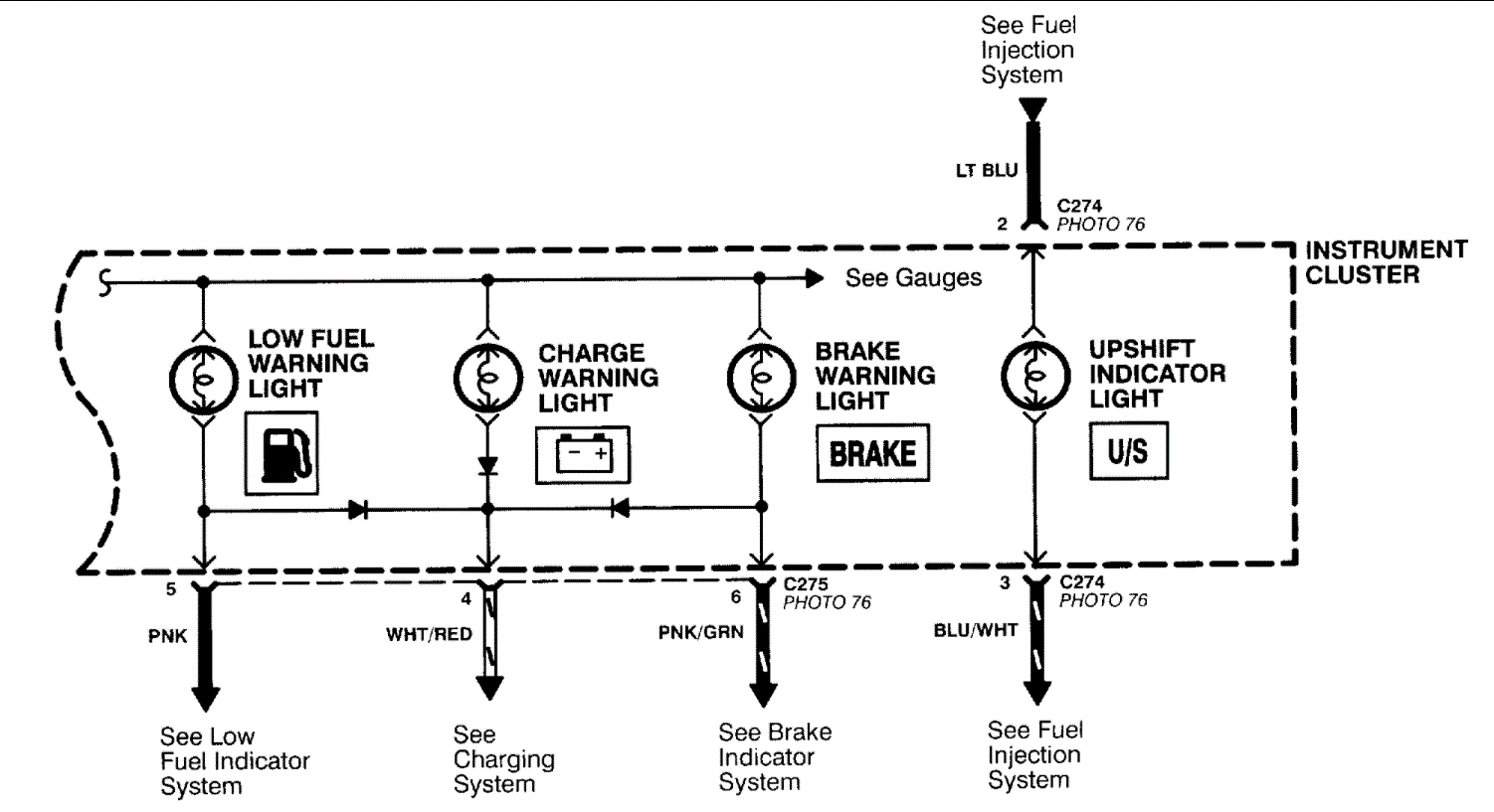

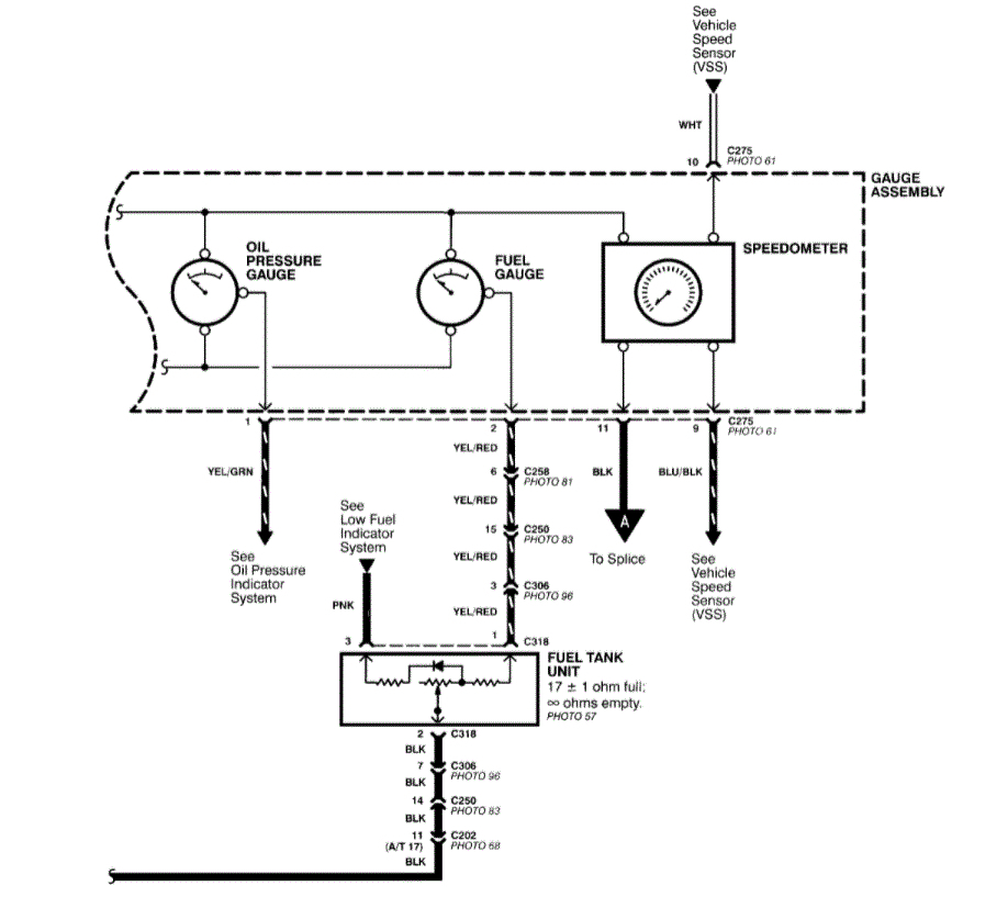

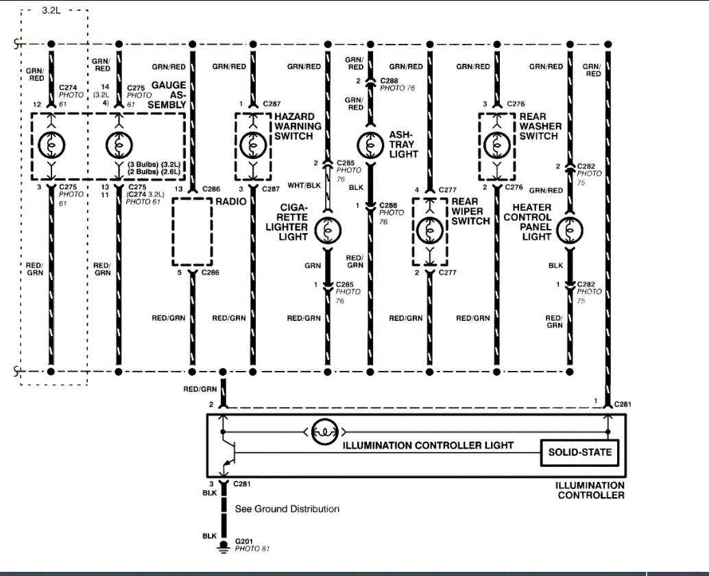

I'm not sure if you need it for the truck or the Rodeo. So, I attached the schematics I have for both. Pics 1 and 2 are for the 1995 Rodeo. The only one I could find for the 1991 truck is in pic 3. That is a manufacturer's schematic for the truck. They aren't as easy to follow.
If you need something different, let me know the specifics. For example, does it have a tachometer? Which specific vehicle you're looking for, engine size, is it 4wd, and anything you can think of that will help.
Let me know if this is what you needed or if you have questions. Also, here is a link you may find helpful.
See pics below. Note: I had to cut the schematic for the 1995 in half to make it readable for you. I did overlap the two so you can follow from one to the next.

Thanks, Joe. I appreciate your help. To me, the drawings seem backward. The 91 pickup is a base model and only has a speedometer, water temperature, and fuel gauge. The two-part drawings only show the fuel and water (understandable because the speedometer on the 91 was cable driven). The other seems to better reflect the newer cluster (from a 95 Rodeo). It doesn’t show Enough.
I’m doing a motor swap project (5.3L LS) on my 91 pickup. I’m trying to integrate the Rodeo cluster into the work in order to get speedometer, water, oil pressure, tachometer, and battery into play. Wiring doesn’t quite match up in color or pin position on diagrams I’ve seen so far.
I appreciate your help. This site has dropped me out after several iterations of reply, so I’m sending a bit of a short summary. If you can come across other 95 Rodeo (94-97) diagrams, I’ll be much obliged.

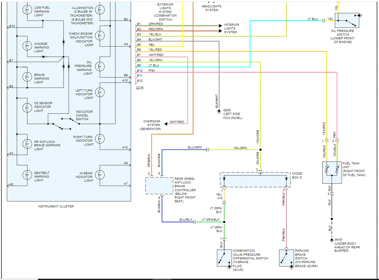

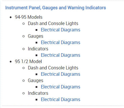

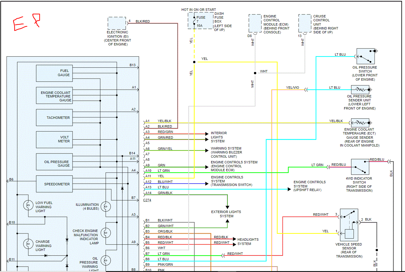

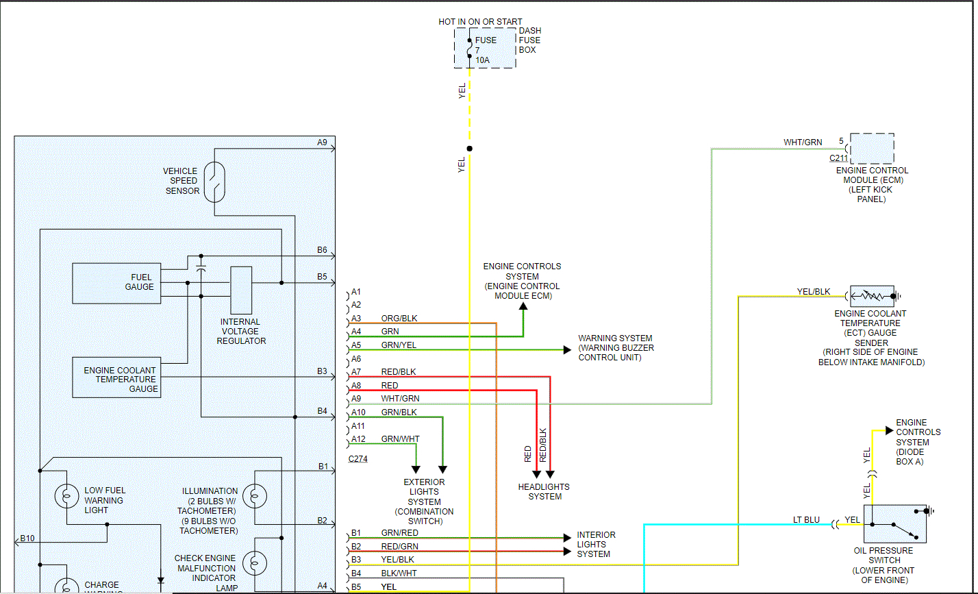

No problem. Here is what I have: There are OEM schematics (see pic 1 below) and I have color schematics (non-OEM) too. We just need to narrow things down. They seem to be based on production dates when looking at the OEM schematics.
Take a look at pic 1. Is there one there which seems to fit what you're looking for? Also, let me know the same for pic 2. I'll send both.
Interestingly, I'm showing different schematics if the Rodeo is 4wd or 2wd, and if it's a 4 or 6 cylinder. Let me know that as well.
It sounds like you're building a rocket. LOL Let me know what I can do to help.

Anyway, the Rodeo is a 95 S, 3.2L, manual, with VIN 4S2CG58V7S4309065. I don’t know whether it’s a 95 or 95.5.
I know this sounds like a lot, but perhaps you could send the following:

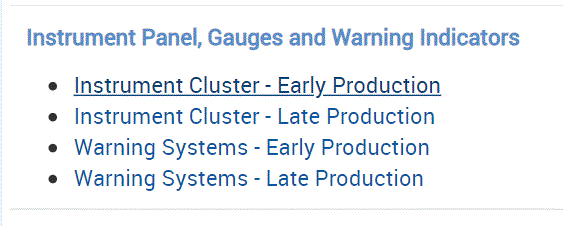

Instrument Cluster - Early Production
Instrument Cluster - Late Production
Everything from the first pic since I’m not sure where the lines may cross within the connectors.
Again, your help is much appreciated.
- Mike
Oct 17, 2021 at 12:27 AM
  • 110,244 POSTS

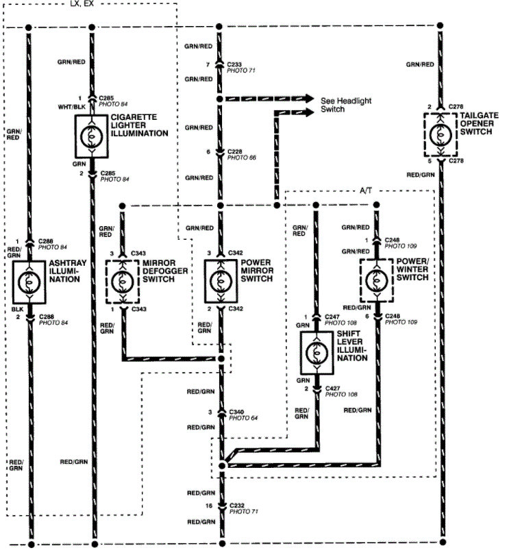

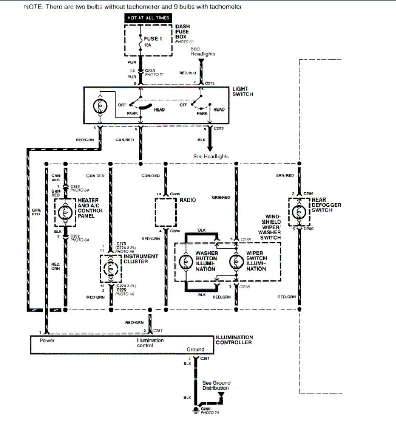

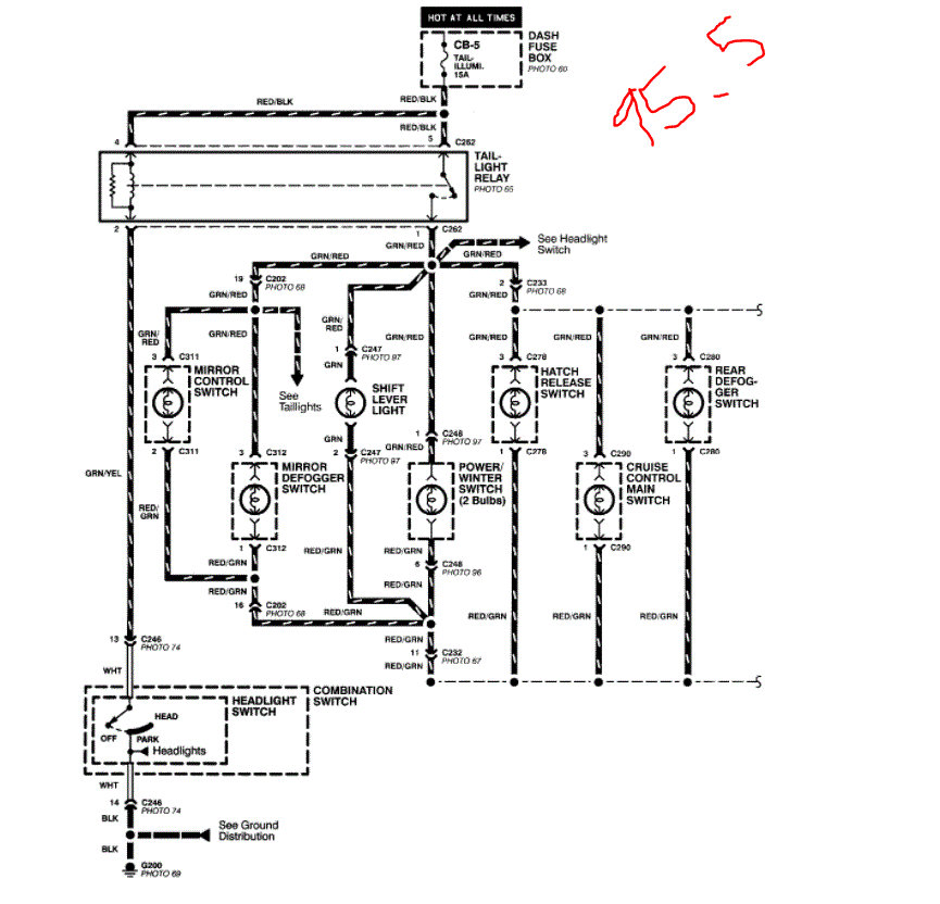

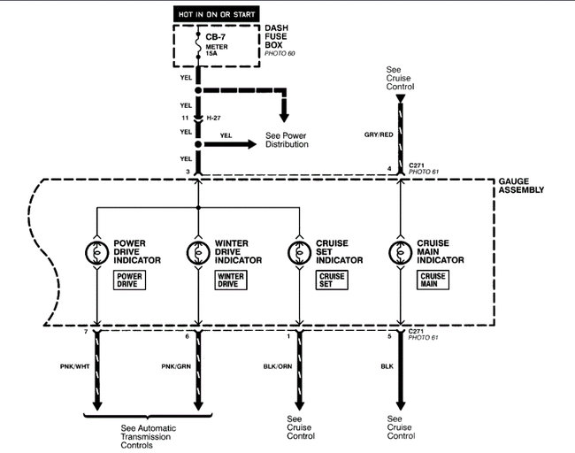

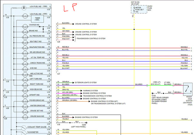

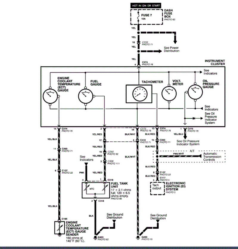

Pics 1 and 2 are early production. Pics 3, 4, 5, 6 are late production. Pics 7 - 12 are early production in the order listed in the above pic 1. The remaining, starting @13, are late production. I wrote 95.5 where the newer model starts.
I hope this helps.

You may have hit gold (or, perhaps, "I may have hit gold."). The early diagrams seem to match up exactly with what I have for my cluster. My truck isn't at my house, so I'll head to where it is tomorrow to verify what I believe to be the right answer. I've generated a spreadsheet showing where the cluster's wires need to connect to the existing truck wiring. The rest will fall into the LS's PCM output for speed and tach. Water temperature should follow with what was there before as far as wiring. Oil pressure will be run separately.

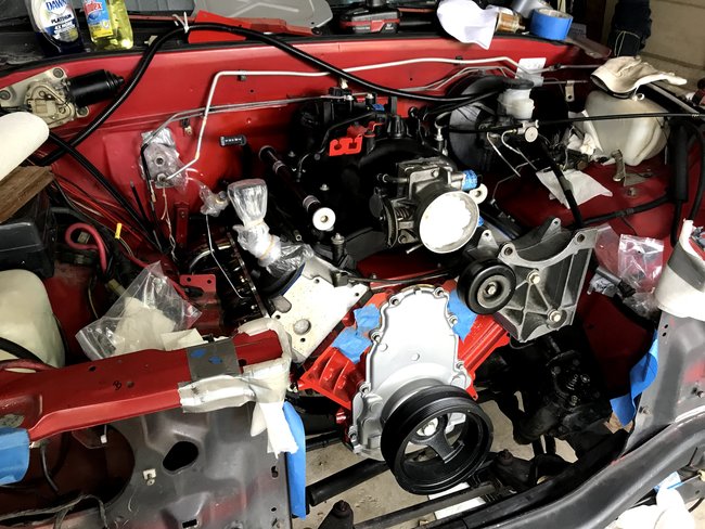

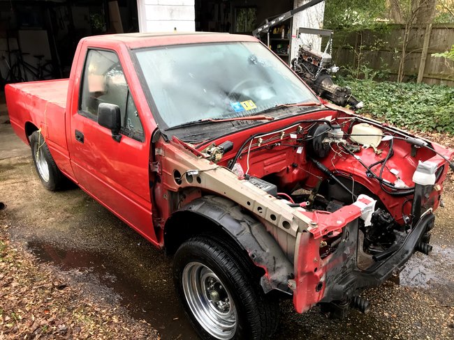

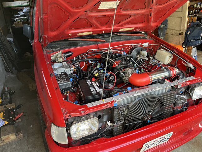

A couple of photos. It's a little further along than this seems, but still some way to go.
Again, I appreciate your help.
- Mike
Oct 19, 2021 at 7:22 AM
  • 110,244 POSTS
Mike,
I'm glad to hear they match. As far as the pics, all I can say is Hold On!!! LOL OMG! That thing is going to be a rocket. It looks like you are doing an excellent job.
When this thing is running, take me for a virtual ride. LOL

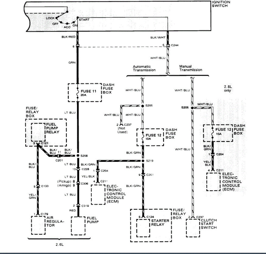

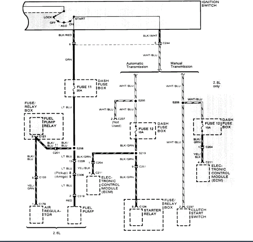

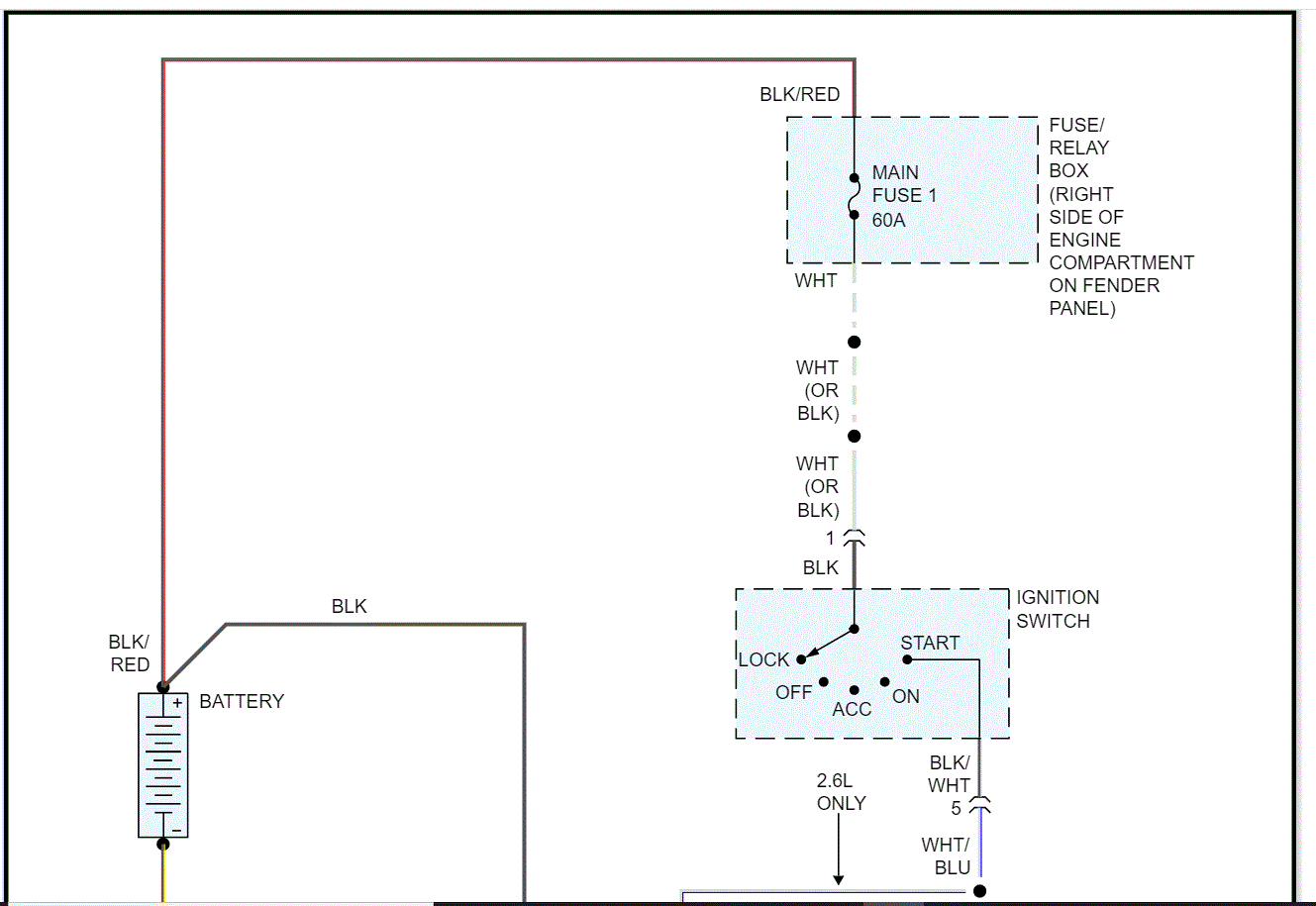

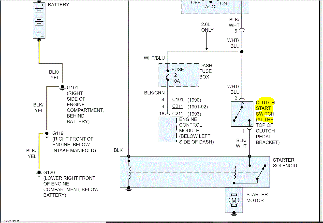

I'm back again with another question. Would you have schematics for the original '91 base truck's starting circuit? I have a pretty good look at the ignition switch, but the Chilton's manual just isn't as granular as I need (shows a blank circle for the switch, with some wires coming out - and those wire colors don't match).
As you can tell, this job is moving along at a glacial pace. I appreciate any help you can provide and understand if I've tapped the well dry.
Thanks.
Mar 6, 2022 at 10:52 PM
  • 110,244 POSTS
No problem whatsoever. I attached what I have for a 1991 2wd with a manual transmission. If you need one for an automatic, let me know.
Don't worry about asking questions. The well is deep. LOL
Mar 7, 2022 at 5:00 AM

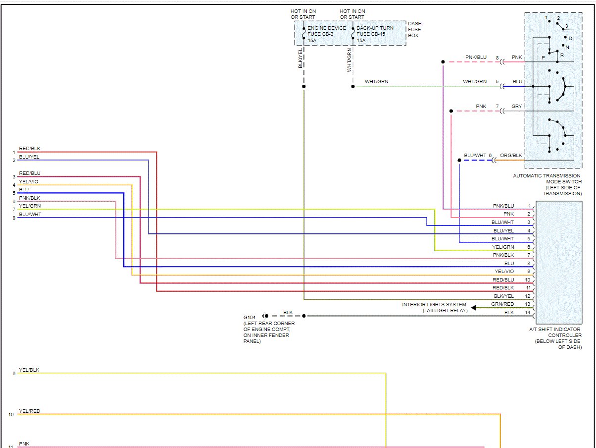

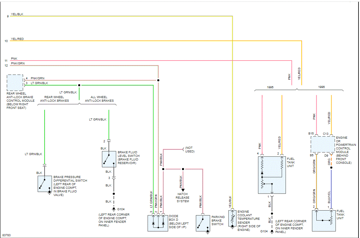

Thanks a ton! Very helpful. Although I said I had a pretty good view of the ignition switch, that is a visual only. I've been ringing out the lines as best I can, but any actual info on where the following wires land would be much appreciated:
ACC
ON
OFF
There are four wires encircling the center post. I have the Start figured out thanks to this schematic you've sent. The others would be helpful, if possible.
Again, thanks much for your help.
Mar 8, 2022 at 12:24 AM
  • 110,244 POSTS
Hi.
In the off position, the circuit is open, so there isn't a wire to check.
I had to dig to find the OEM schematics and didn't find the best info, but it should help.
There are two pics below. Take a look at them and let me know if that answers your question.
Mar 8, 2022 at 5:56 AM

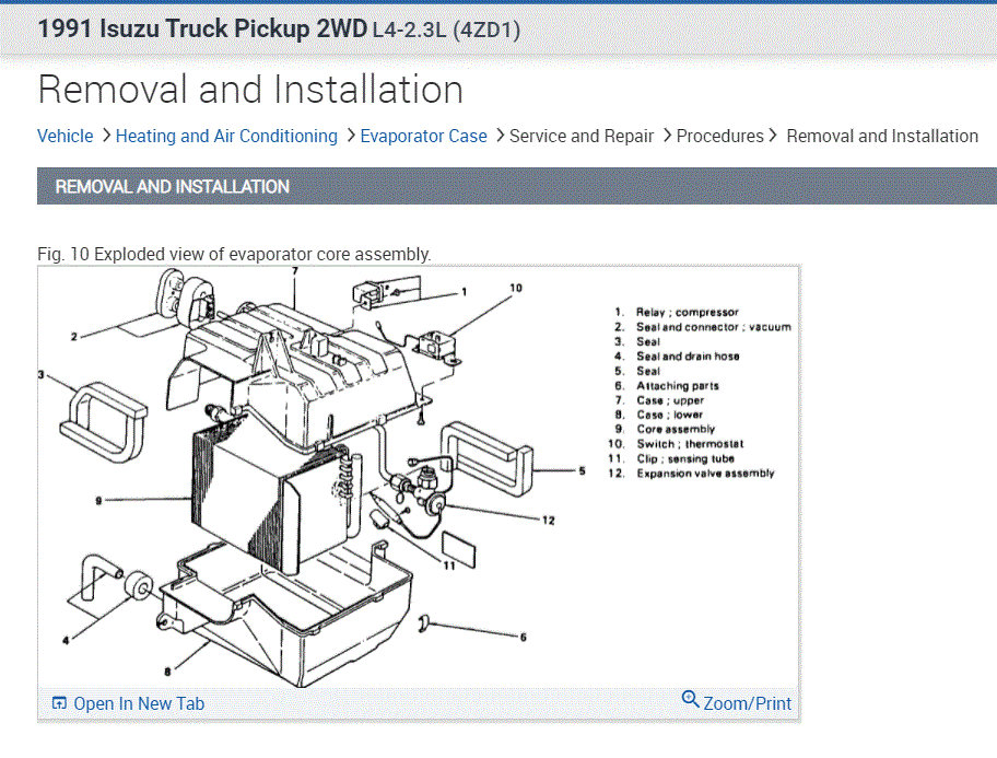

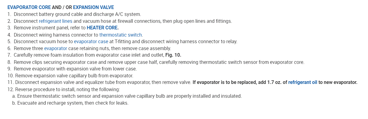

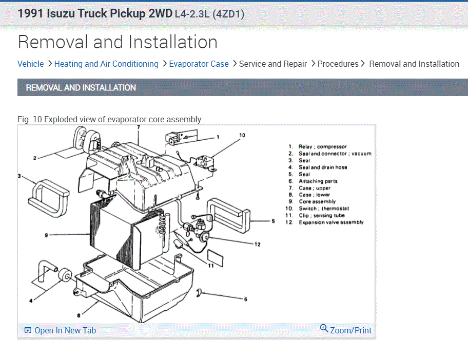

Hi Joe, here I come, hat in hand again, asking for more information. I'm in the midst of laying out the wiring harness and need to make a 2"-3" hole in the firewall (passenger side, close to centerline) and will have to remove the A/C evaporator in order to figure out where to put the hole. Then, I'll have to make sure there's space and run the part of the harness with the fuse block and PCM connectors. Is there any chance you'd have anything that describes the evaporator removal procedure? Thanks again.
- Mike
Mar 27, 2022 at 6:49 AM
  • 110,244 POSTS
You are really deep into this. LOL As far as removing the evaporator, the entire HVAC box needs to be removed from under the dash.
I was able to find directions that are somewhat vague. Take a look through them and let me know if they help or if you have questions.
I hope they help.

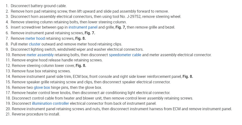

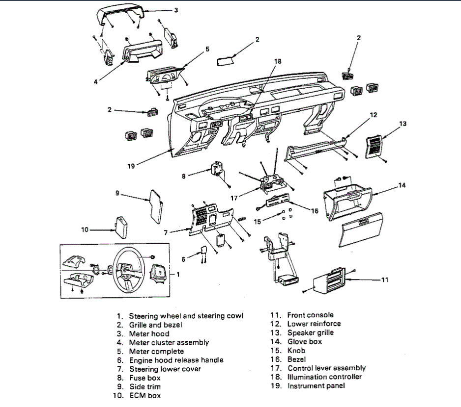

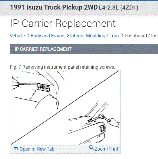

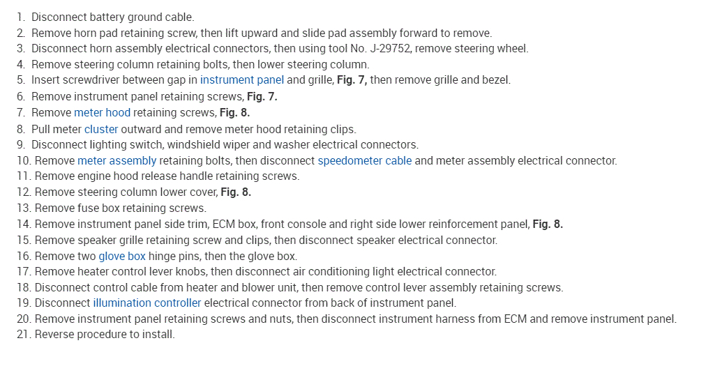

Yes, unfortunately I am digging deeper than I ever imagined I’d have to. And the onion continues to be peeled. Would you have anything that speaks to removing the instrument panel? I already know how to remove the cluster, but if there’s anything that sheds light as to where the bolts/studs that hold these things (dashboard, heater core, evaporator box) together (along with, hopefully some instructions on how to access them in a sequential manner), I’ll be further in your debt.
Mar 27, 2022 at 12:36 PM
  • 110,244 POSTS
The best I can find for the dashboard is attached below. It has an exploded view of the parts, so it should help.

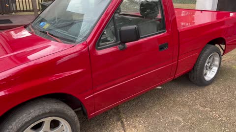

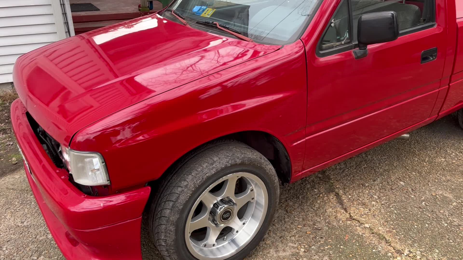

Joe, I know it’s been a long time, but here’s a walk around video of the truck at idle. I had some real challenges with the PCM, but a local tuner helped me get that straight. I’ve got a few electrical issues to work out, but the truck drives pretty well. I still need to put an exhaust with muffler though.

Great to hear from you and it sounds great. My friend, you do excellent work. I'm impressed. The only concern is if you will be able to keep it on the road. LOL
Let me know how it drives. More videos would be great!!! And I hope you always come back if you need anything.
