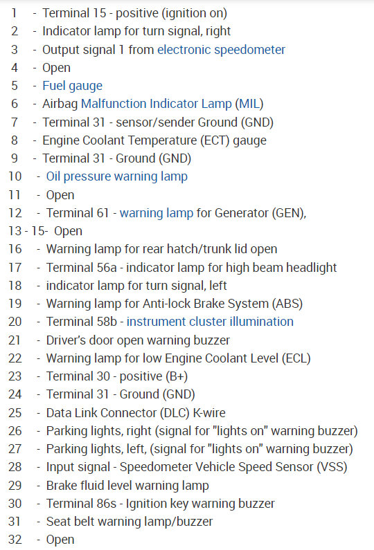

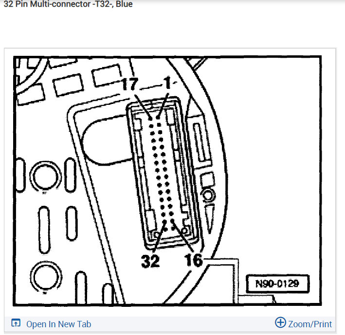

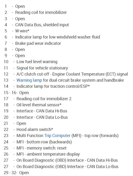

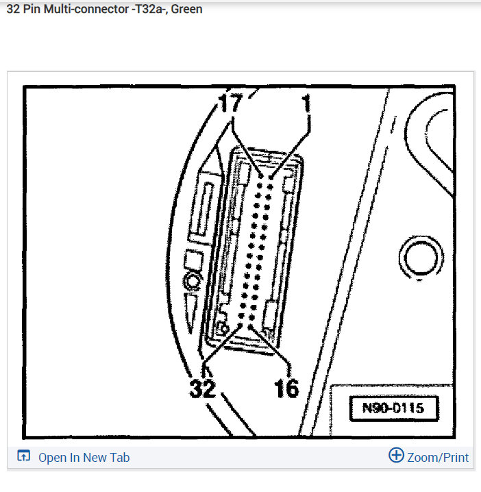

Greetings. Does anyone have the pin out of the instrument cluster on the vehicle listed above 9n? Thank you.
Apr 5, 2024 at 11:03 AM
  • 55,721 POSTS
It looks like there can be two different connector views which I have included both. Check out the images (below). Let us know if you need anything else.
Apr 6, 2024 at 4:32 AM
ECLECTIC ECLECTIC
  • 21 POSTS
Mine has the green and black connector. The pin outs are different.
Apr 6, 2024 at 9:34 AM
  • 55,721 POSTS
That is all the information I have for this car sorry.
