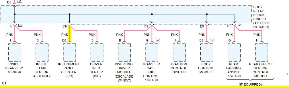

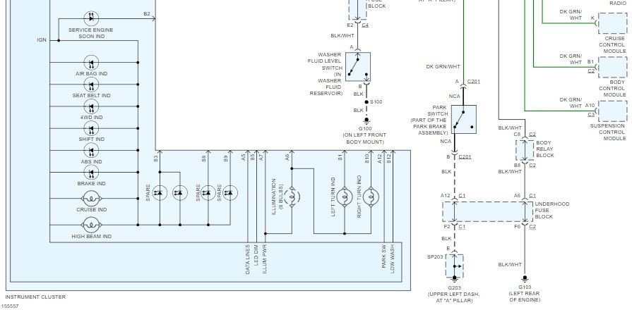

Hi, I just recently purchased the SUV listed above. they told me the cluster was out and I could replace it and it will work. Well I replaced it and that not the issue. What else could be wrong? All the grounds are getting ground. Auxiliary 20 amp fuse keeps blowing as well.

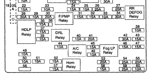

Are you referring to the aux fuse number 41? See pictures 1 and 2.

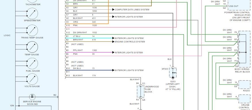

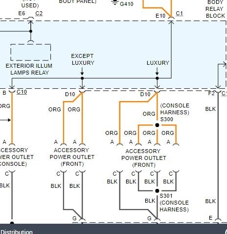

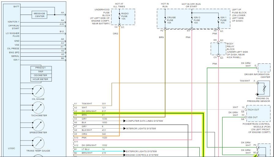

Also, pictures 3, 4, and 5 show the instrument cluster wiring schematic. I need to know if anything on the cluster works and if you purchases a new or used cluster. These things were known to go bad and if you got a used one, chances are you may have gotten another bad one.

Welcome back:
I dug a little deeper. The 20 amp Aux fuse doesn't have to do with the cluster. It is for the accessory outlets in the front. I suspect they aren't working. See pictures 1 and 2.
With that, I suggest locating the body relay block under the dash. It is powered by the ignition fuse 1. See picture 4. The fuse is in the instrument panel fuse box on the driver's side. Make sure the fuse is good and then you need to check if there is power to the relay block. See picture 3 for wire color and location.
Here are a few links that you may find helpful:
Let me know if this helps. Also, if you have questions or need help, let me know. Since this panel doesn't work either, I have a feeling it just isn't getting power.
