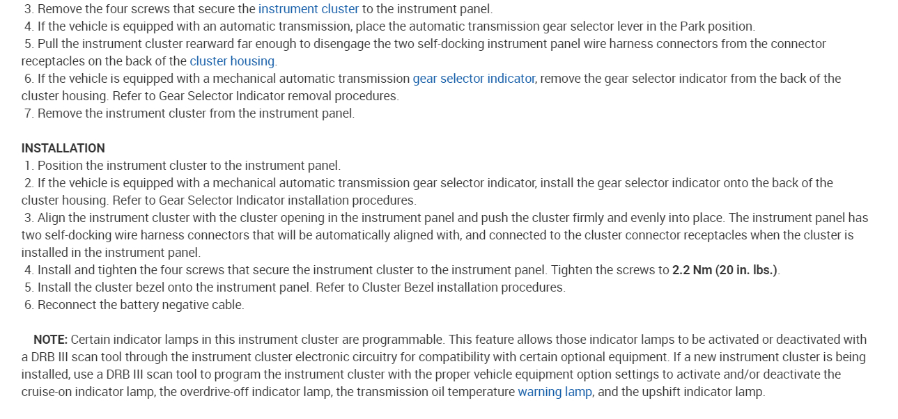

Just had the engine replaced. Started it up and all the gauges registered but the oil pressure was reading a little high. Then the whole cluster turned off. All gauges including odometer stopped working. I checked the fuse, and it was good. I let it sit for a few days and now it seems the battery is drained.

I have seen the cluster go out and drain the battery down. So, I would charge the battery back up and then unplug the cluster to see if the battery stays charged. If so, replace the cluster with a rebuilt unit.
This guide may help us:
https://www.2carpros.com/articles/car-battery-dead-overnight

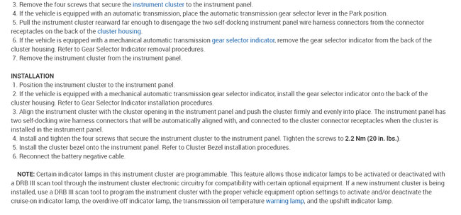

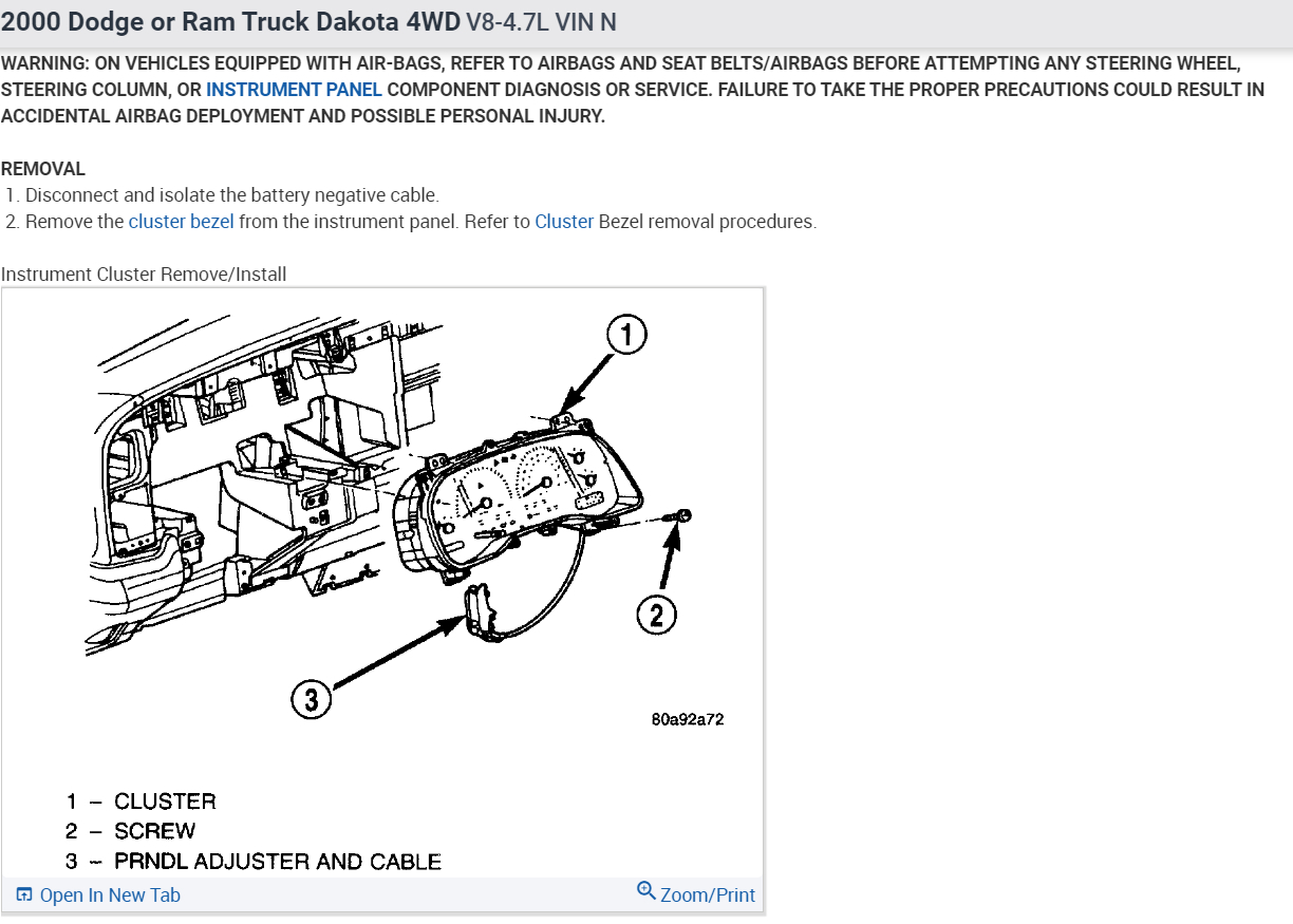

You can get a preprogrammed unit by searching Google or Ebay. Here is how to remove the cluster in the images below. Please let us know what happens.
