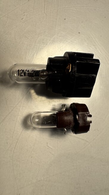

Several light bulbs in the instrument cluster stopped working over the last year. I ordered a 20pk replacement from Amazon, and I was able to successfully change some of the burnt out lights by inserting new incandescent glass bulbs into the existing plastic holders. However, I was unable to change the bulbs behind the "N" and "D" drive indicators, as these are much smaller units than the ones I purchased (bulbs cannot be readily separated from holders). Can you please let me know what is the description and part number for these smaller bulb assemblies. A photo of the two types of bulbs id attached (larger one is from Amazon and smaller one is original Honda). Thank you so much.

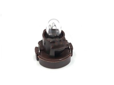

According to the parts listing the new part number is Honda 35871-S3N-901. They are a 14 volt 60 ma bulb. The part has plastic retainers now instead of metal. You may want to go to the dealership as most of the replacements I see use a 12 volt bulb which will end up being brighter and not last as long as the 14 volt original.
