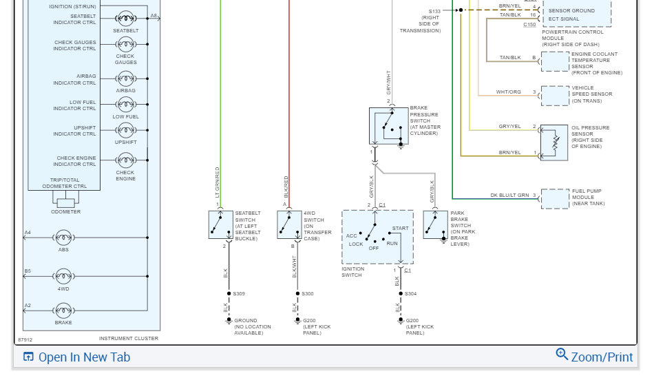

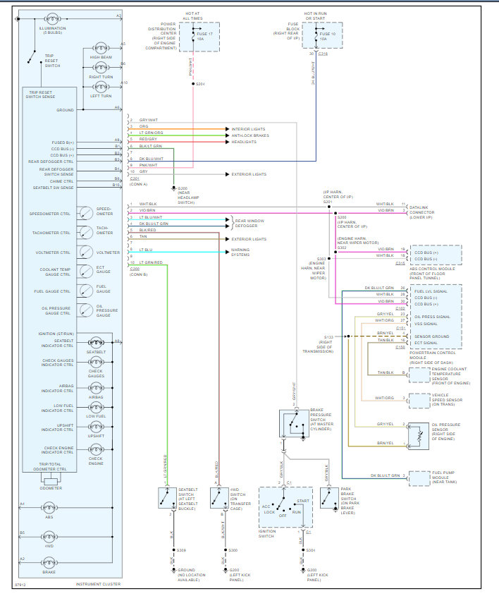

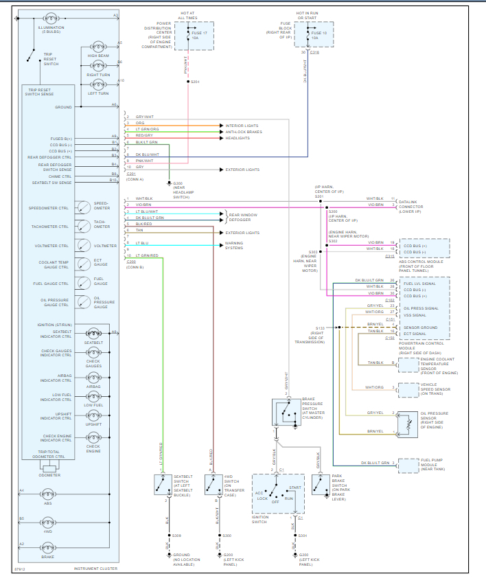

The instrument cluster gauges are not working but all the indicators lights still work. Fuses seem okay, non blown, pins on the dash connector seem fine and I swapped out a second cluster and it has the same issues.
Feb 12, 2019 at 5:41 AM
  • 55,433 POSTS

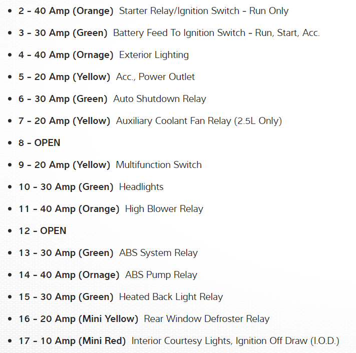

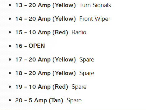

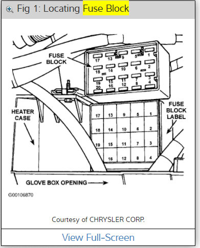

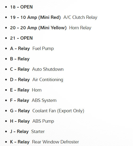

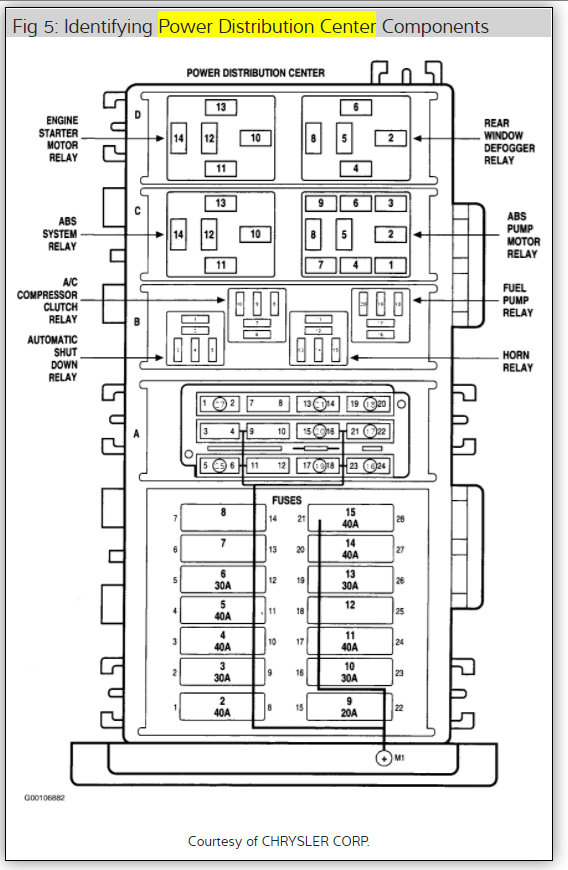

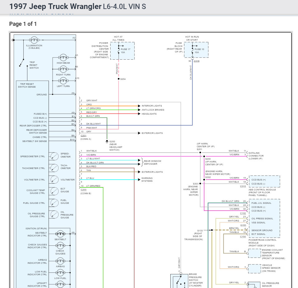

Do you have power at fuses #17 and 10? here is a guide to help us check and the cluster wiring diagrams so you can see how the system works:
