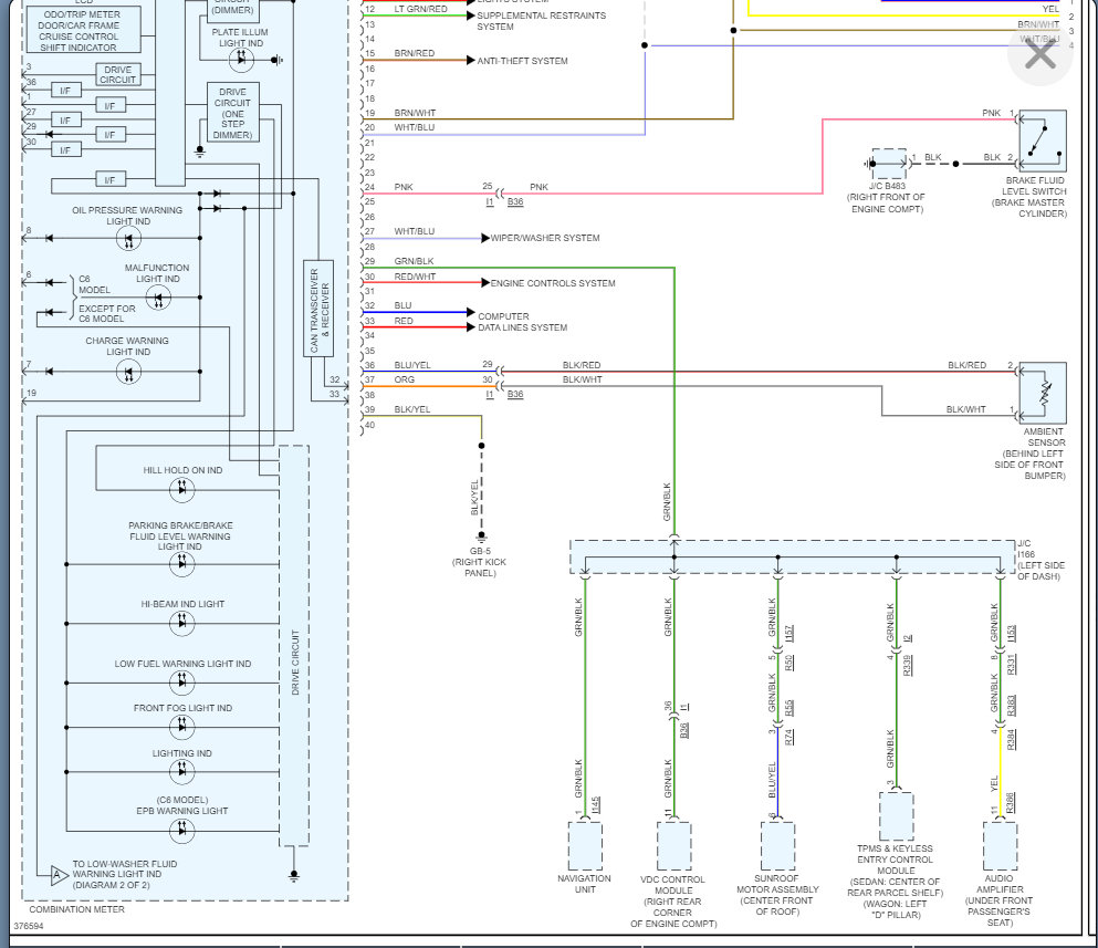

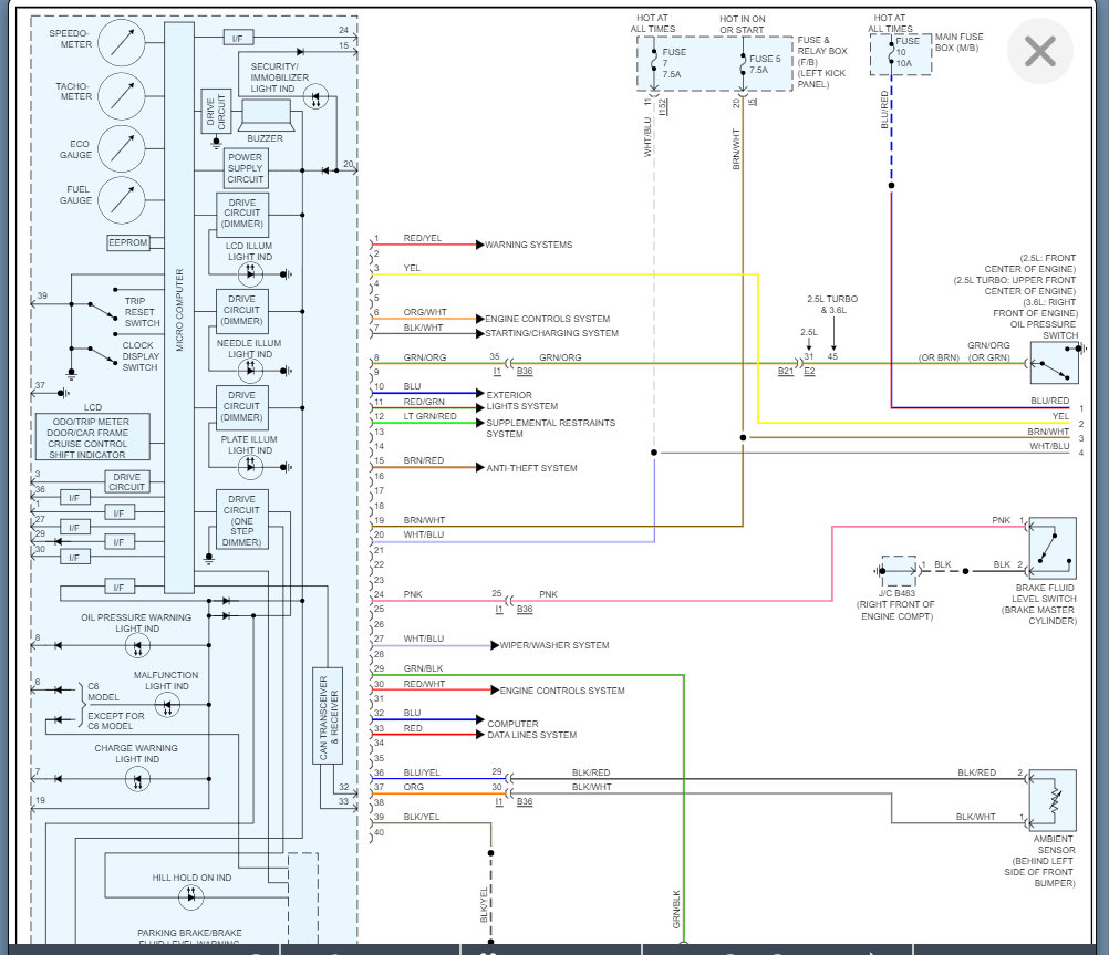

Has this been happening since before the battery was replaced? I understand and agree that it isn't then battery but if this just started then 2 months is plenty of time for a battery to fail if there is a draw on the vehicle.
However, the next thing after that to check is power on both sides of fuse 5 and 7.
When you showed the dash in the video, was that of the clock? If so, it was not working either?

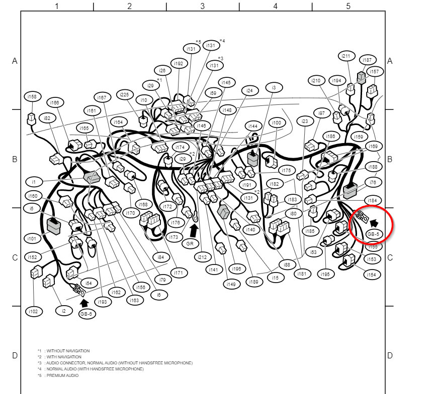

If that is the case, we need to also check the ground as the cluster and clock share the same ground GVB-5 which is in the right (passenger side) kick panel. I attached a location view of this.
