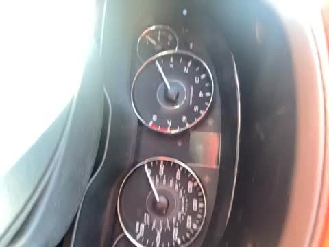

The cluster is fully plugged in and still shows flashing lights on the dash and when I drive it doesn’t show my speed or show the gas gauge moving it’s just at empty and 0mph, and the car has a hesitation to start when I crank it.

Can you get a video or picture of what the cluster is doing when the lights are flashing? That is going to help us figure out what may be happening.
Also, can you let us know what happened prior to this happening? Was the vehicle in an accident? A part replaced and then this started.

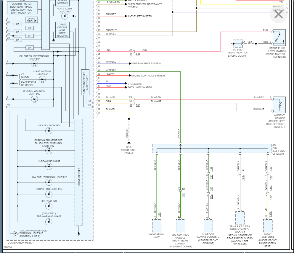

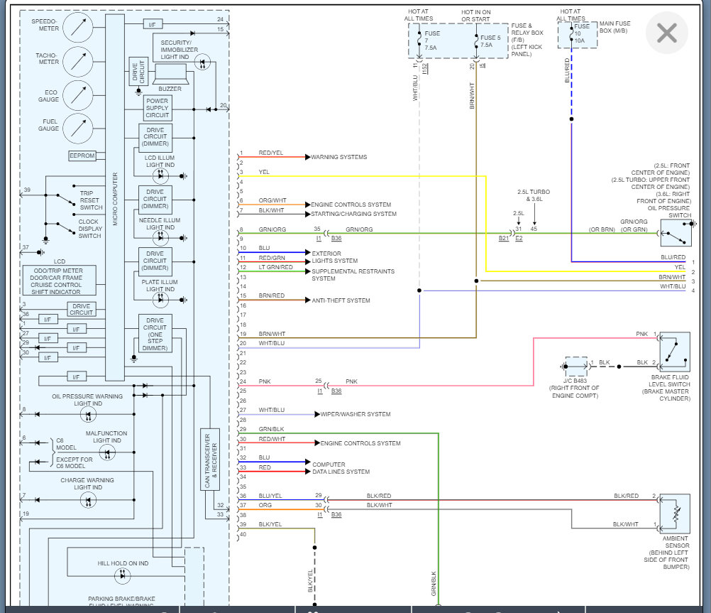

However, the next thing after that to check is power on both sides of fuse 5 and 7.

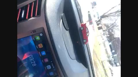

When you showed the dash in the video, was that of the clock? If so, it was not working either?

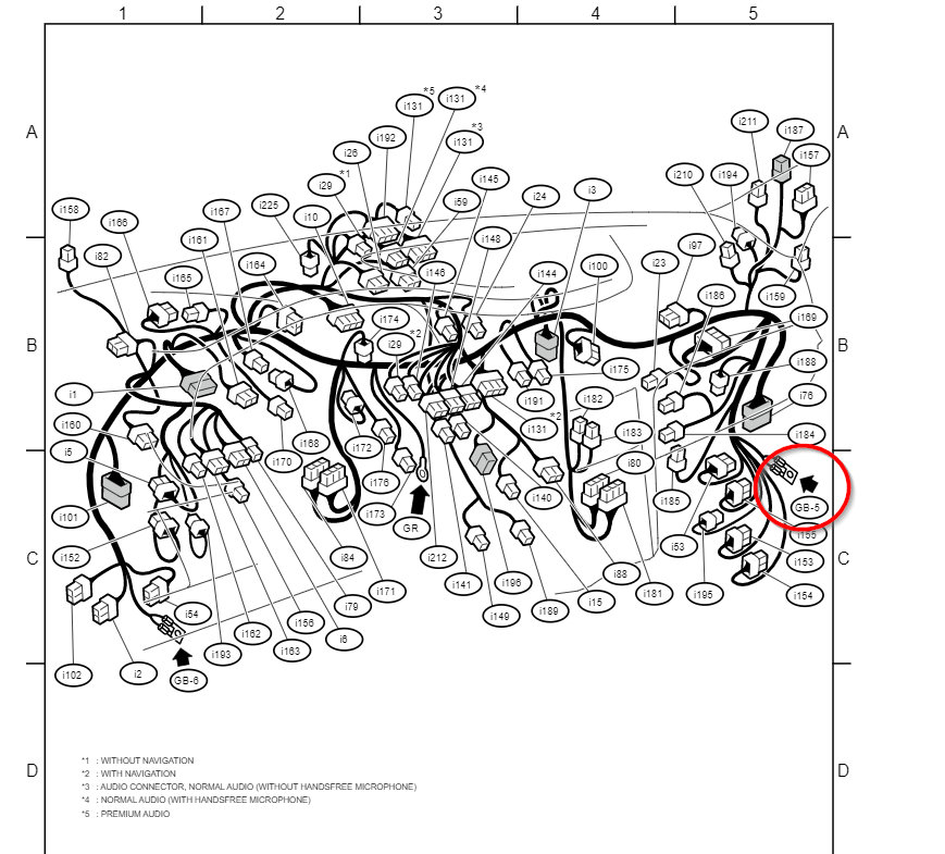

If that is the case, we need to also check the ground as the cluster and clock share the same ground GVB-5 which is in the right (passenger side) kick panel. I attached a location view of this.
