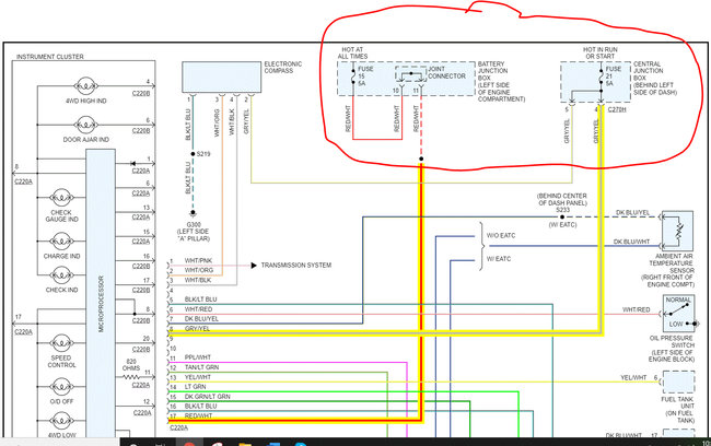

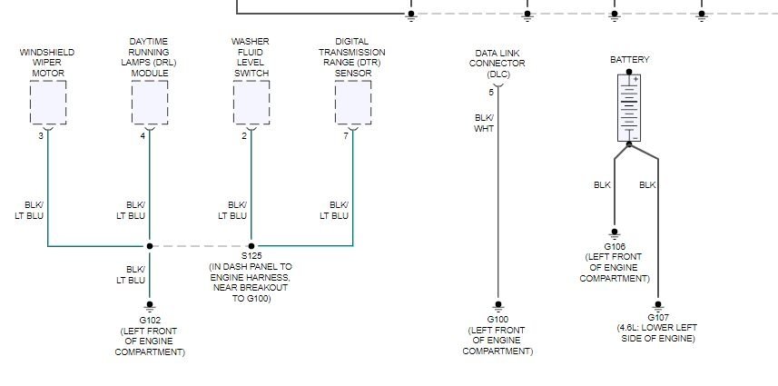

My SUV had a body lift and a new bumper installed. Now the tachometer, speedometer and the temperature gauges fail to work. Additionally the check gauge, check brakes and the battery icon are all lit up. And the digital read out is not functioning properly.
The car starts and the MAF is still working.
The car has been in three shops and it is driving me crazy.
I look forward to your help.

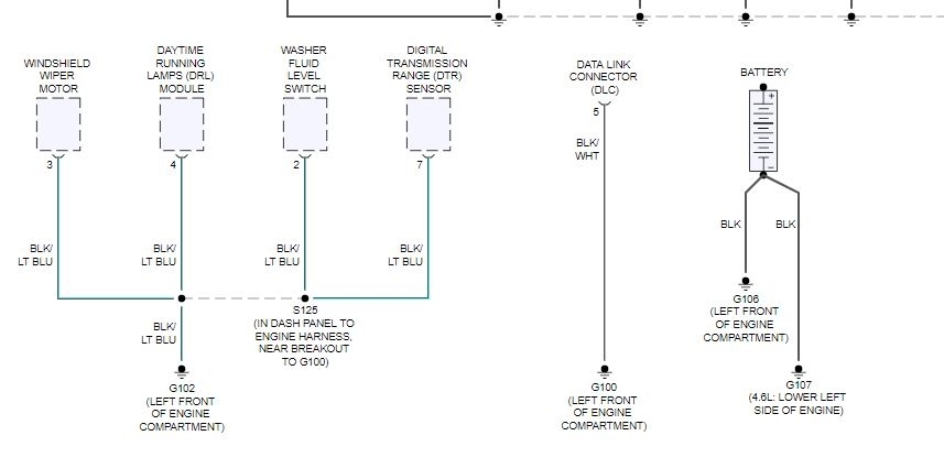

First thing that comes to mind is a ground issue, I would make sure the ground strap that goes from the engine to the body is intact and both ends are tight. This a common issue that creates a great deal of issues especially with Ford products (I'm a Ford man myself). If you can check that and make sure the ground from the battery to the engine block and body are all in good shape. If they are in good shape we can move on to more complicated diagnosis procedures.
I have attached a diagram showing where the grounds from the battery are located.
If you can check those and let us know your results we will be glad to guide you further if need be. Please keep us up to date on your progress and thank you for using 2CarPros!

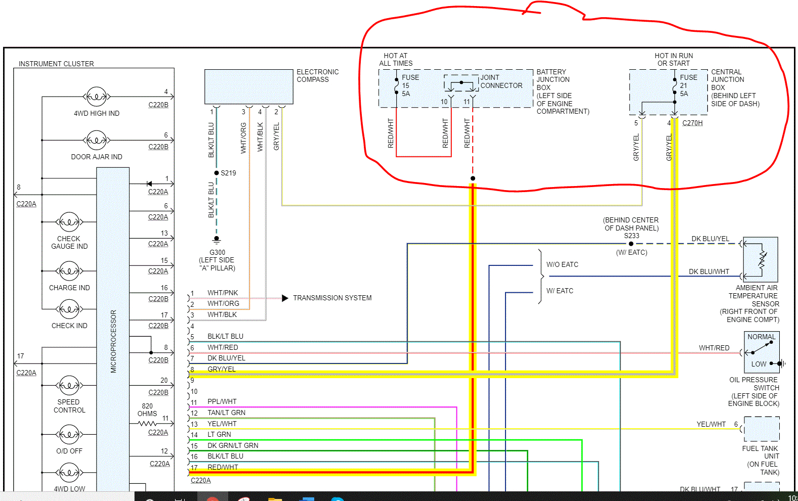

Did this happen all at once? Does the speedometer anything work? I attached a pic below of two fuses I want you to check. In addition to just checking the fuse, confirm there is power to it and out from it.
If there is power, you will next need to confirm the power is getting to the cluster. On the pic, you can see the wire colors and pin locations. Also, make sure the connector is tight and not damaged.
Here is a link you may find helpful when checking the fuses and for power to them:
Let me know what you find.

If the wiring is good going to the cluster, tight, and not damaged, first make sure there is power going to the plug in. If there is, the cluster itself is most likely bad.

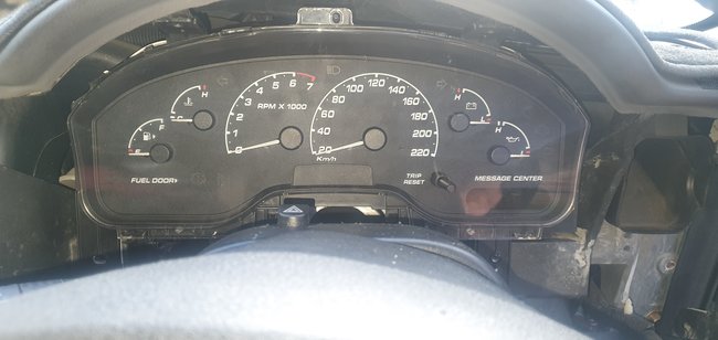

I have a ford explorer and the instrument panel stopped working. No Tach ,speedo,fuel,temp or volt meter. Is there a specific fuse for it or any suggestions? Thanks
Dec 9, 2020 at 11:56 PM (Merged)
TAURUSWHEEL
  • 718 POSTS
Do you have electronic dash??? Check the ribbon connector, and or, any others, behind the dash, might be some work to get to it, i have heard of issues with it on other vehicles,
