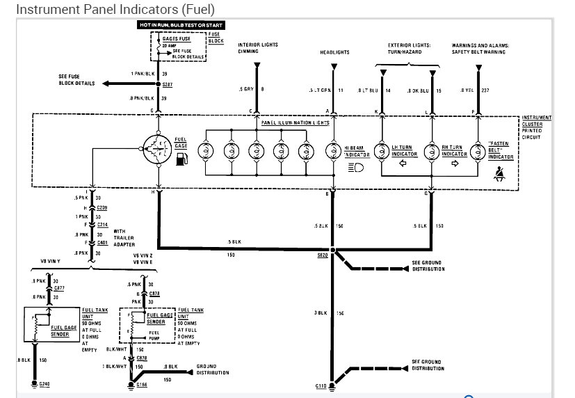

I was looking for where I can find the instrument cluster dash harness pin colors labeled? I need to identify a few of them.

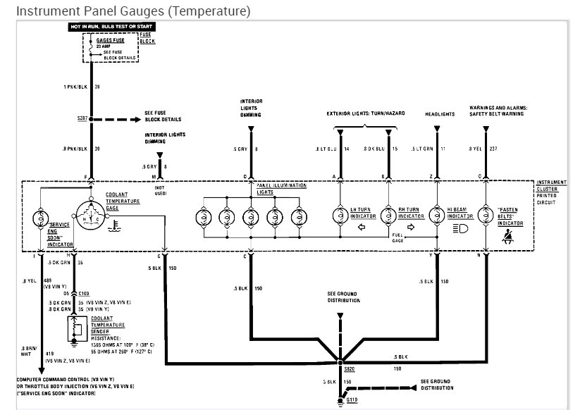

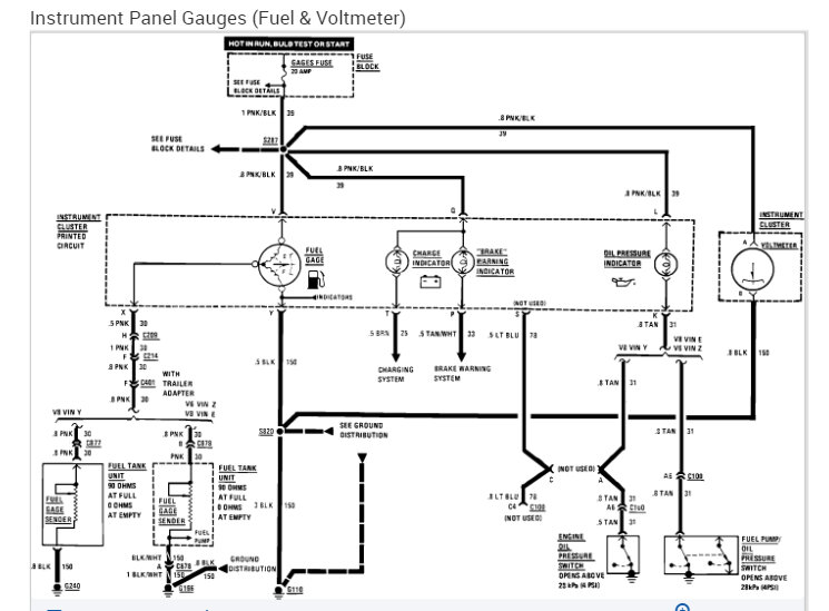

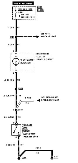

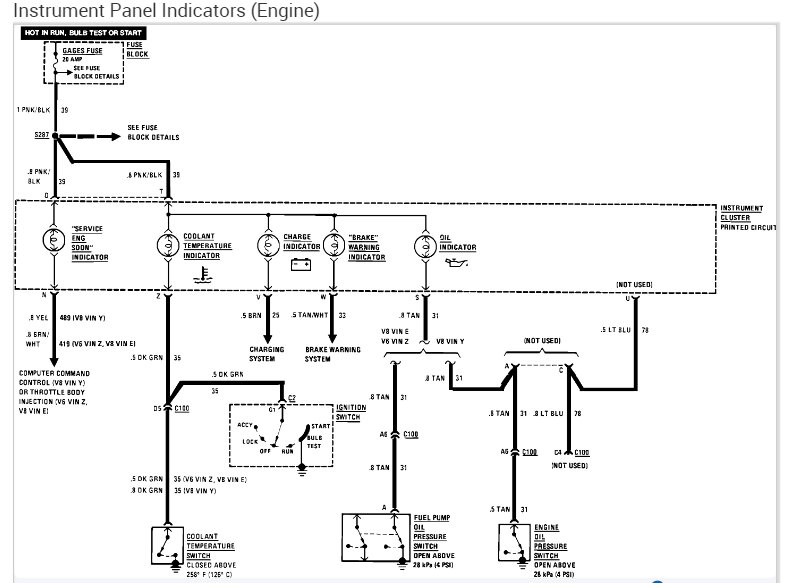

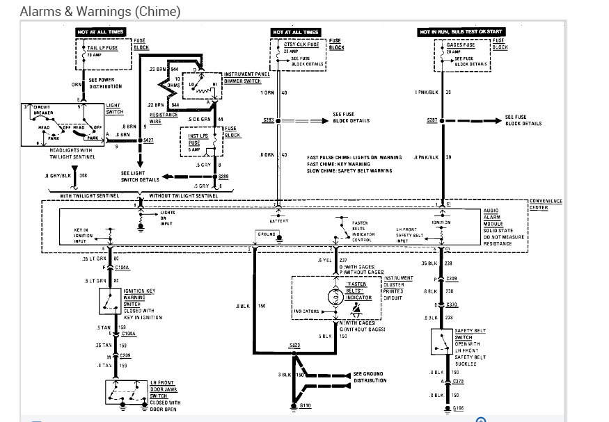

Because of the model year, I am very limited. I was able to find factory schematics related to the different components in the cluster.
If you look below, I attached what I found. They are broken down based on what in the cluster is being checked. They do provide wiring colors to help identify different circuits.
Also, here is a link you may find helpful:
Let me know if this helps.

Thank you, this is very helpful!
