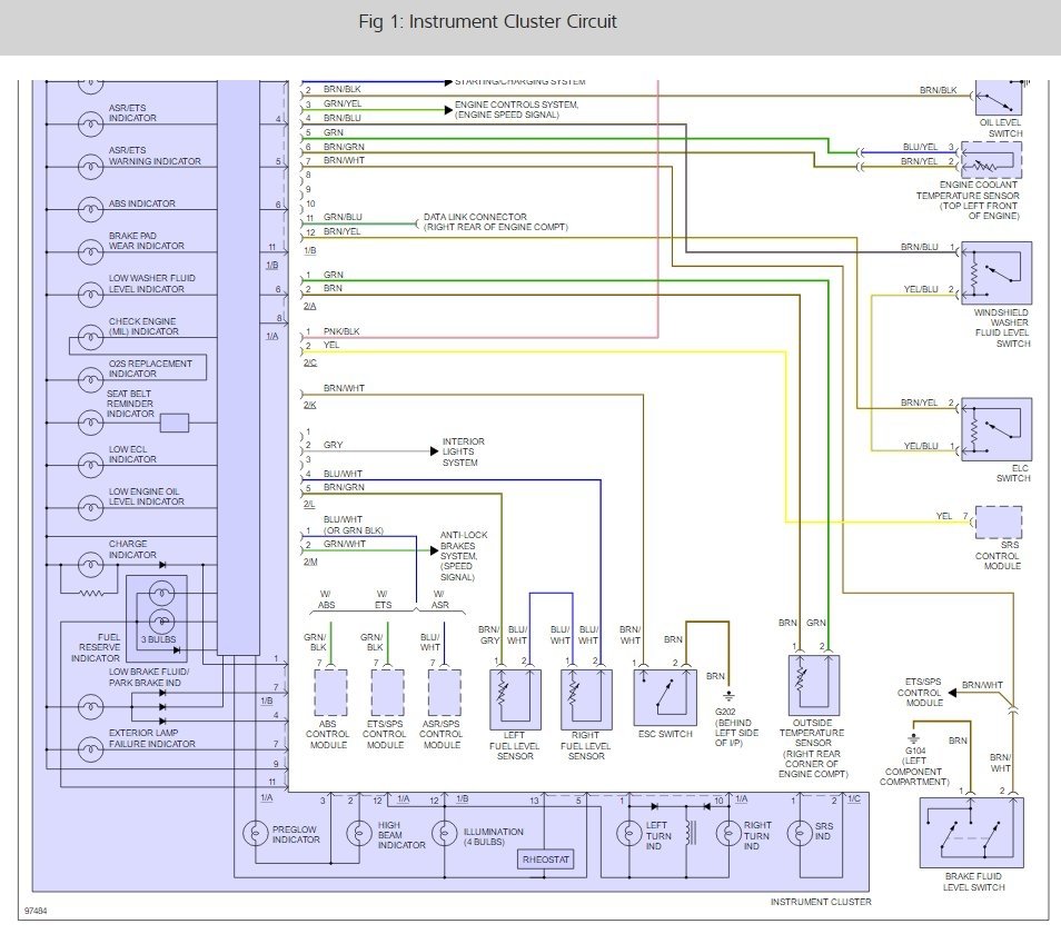

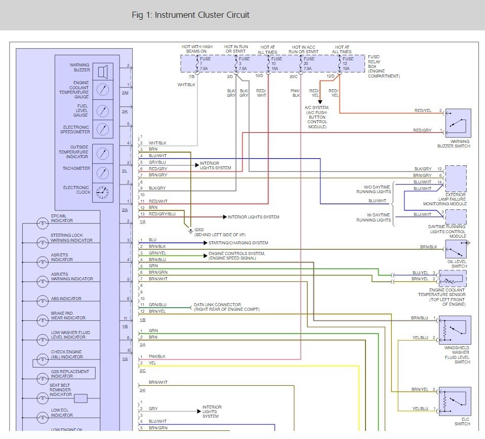

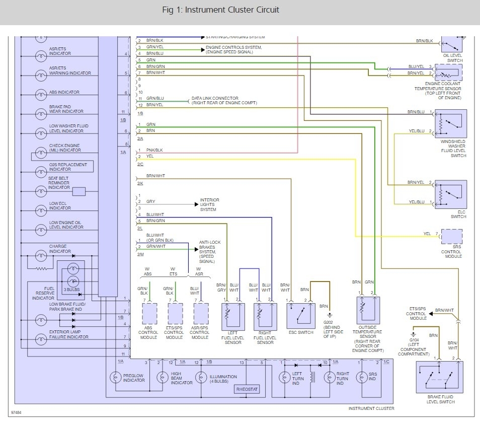

Temperature, fuel, speedometer and tachometer gauges all not working.
All warning lights fine, working as normal.
Answers given for solution appears to be fuse 30?
are the fuses numbered?
Apr 11, 2017 at 10:57 PM
  • 54,837 POSTS
There are a few fuses that run the instrument cluster here is a wiring diagram and a guide that we help get the problem fixed.
Please run some tests and get back to us so we can continue helping you.
Best, Ken
