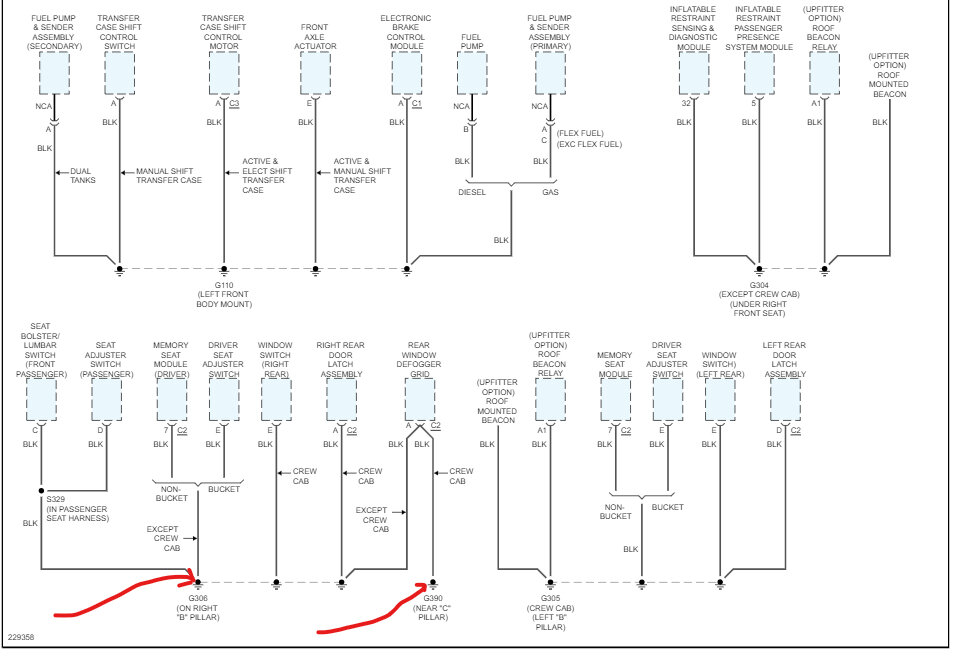

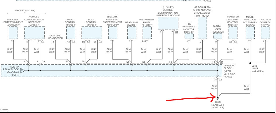

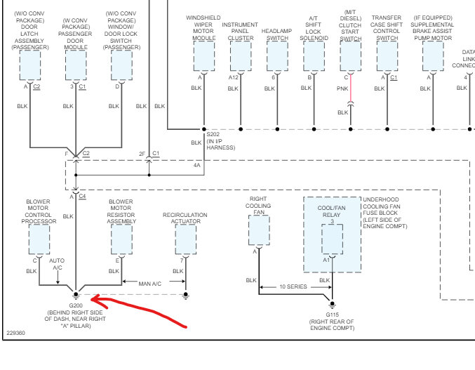

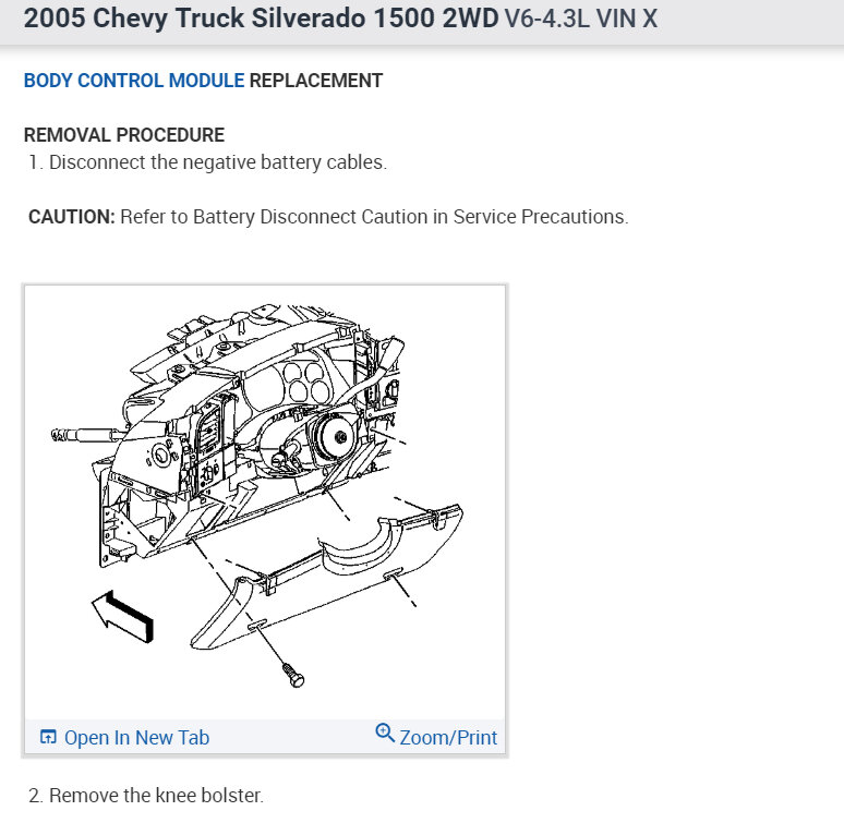

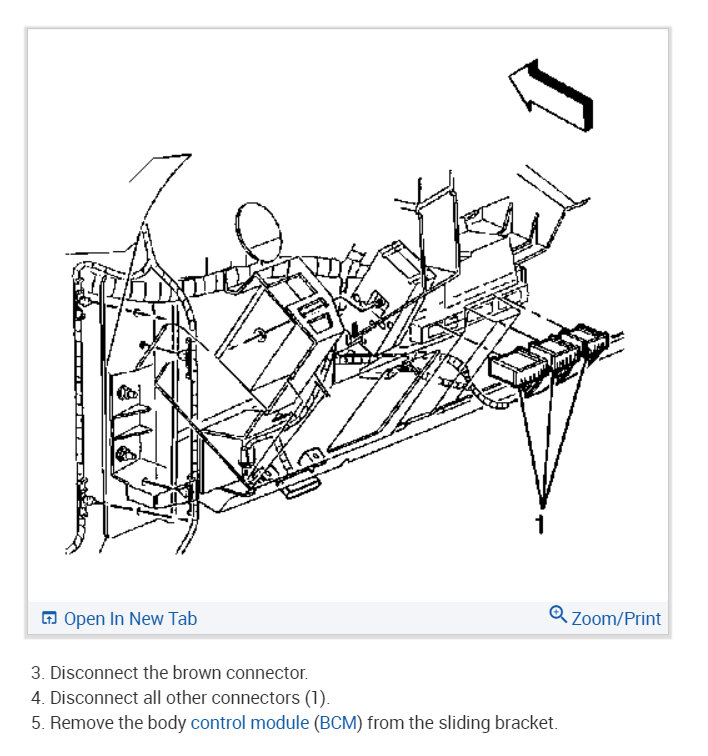

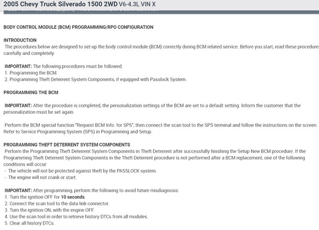

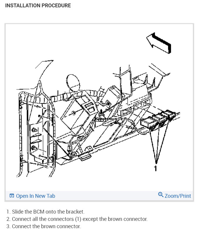

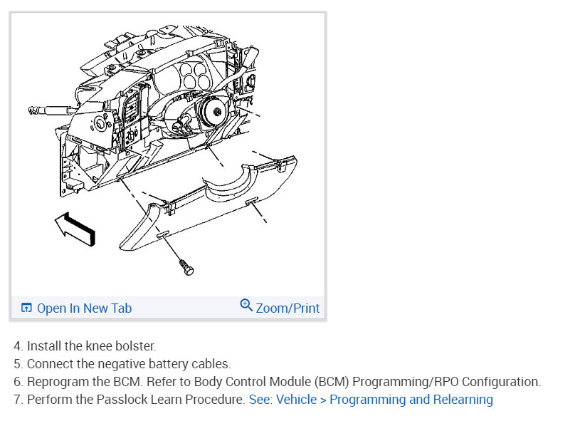

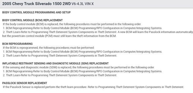

Thanks for the video, it helps. I would check all fuses and then do a CAN scan to see if the BCM is bad, also we need to check grounds, you can get a CAN scanner (Controller Area Network) which will work on most cars from Amazon.
here is a video to show you how:
https://youtu.be/u-4syLc-ifQ
Here is a guide to help you check the grounds:
Here are four grounds that need to be checked. Check out the images (below). Let us know what happens and please upload pictures or videos of the problem so we can see what's going on. If the grounds are good the BCM is bad, but the CAN should confirm the issue.
