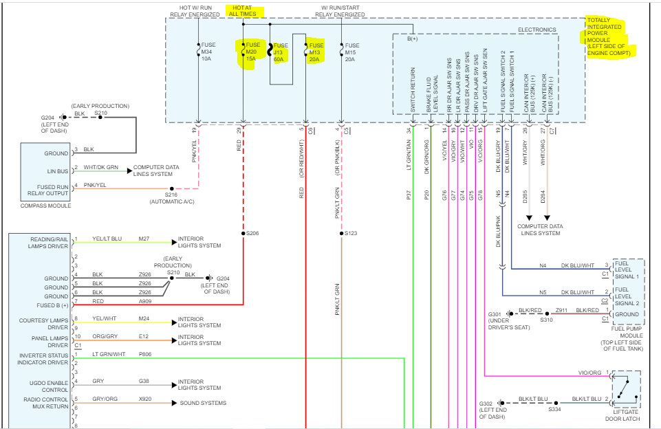

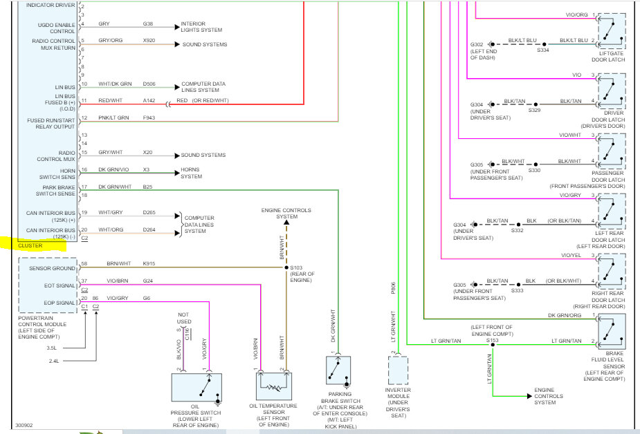

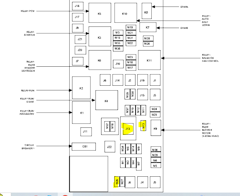

I am literally just trying to find out which fuse is for the instrument cluster, lol. None of my dash lights are working nor fuel gauge or speedometer so I’m trying to replace the fuse and don’t know which one it is although I’m looking at the diagram it doesn’t specifically say cluster or instrument cluster or dash.
Jul 29, 2023 at 9:36 AM
  • 110,244 POSTS
There are different fuses used for this. I attached the wiring schematic below for the instrument cluster circuit. This is for a vehicle with a 3.5L V6. If you have something different, let me know.

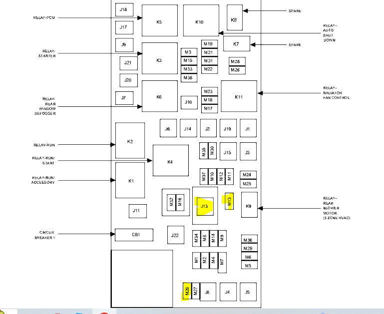

I highlighted fuses in the schematic related to the cluster. When you check the fuses, make sure there is power to and from them as well as the fuses' conditions.
The last pic is the totally integrated power module (TIPM) under the hood. It shows the fuse locations. Looking at the schematic, I suspect J13 is internal and not something you can replace.
I must tell you that the TIPM is known for connector failure, so we may have to dig into it a little further. However, if the fuses are good and have power to and from, you can check at the cluster to see if it is receiving power or not.

You will need to disconnect the connector and locate the wires in the schematic I attached above. The wires will be solid red. However, there is a chance the one will be red with a white tracer.
With the key on, you need to probe the connector pins in the connector to see if they have power. You can use a simple test light to do this.

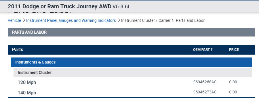

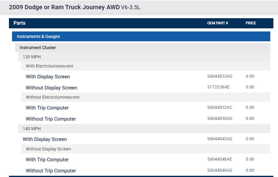

Hey, so I found out it’s the instrument cluster itself. Do you know if the 2011 dodge journey has the same instrument cluster as the 2009?
Aug 3, 2023 at 10:25 AM
  • 110,244 POSTS

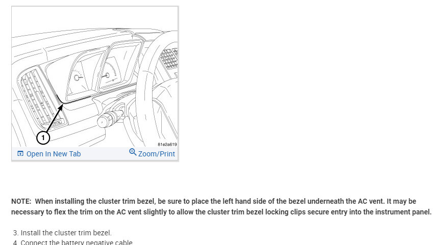

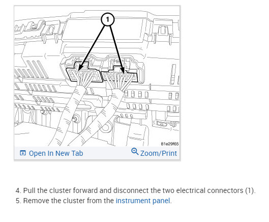

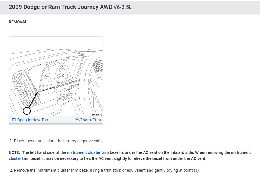

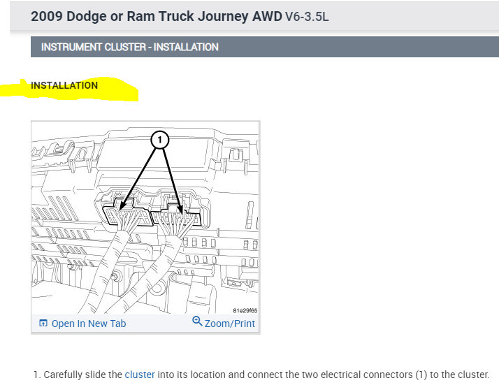

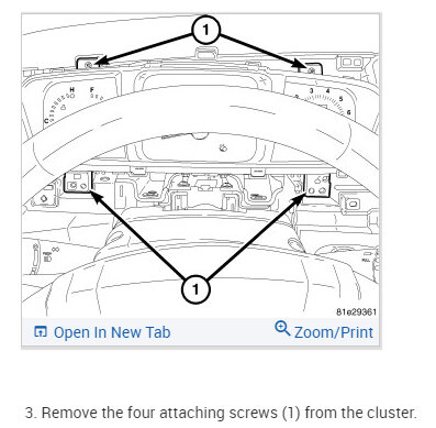

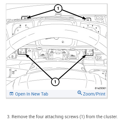

Both model years had optional clusters. So, I checked to see if any were the same. I attached two pics below showing the OEM part numbers. None of them is a match.

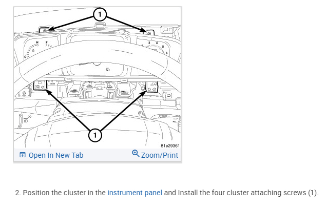

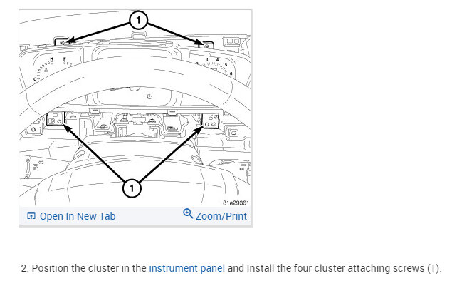

I don't know if you need them, but the remaining pictures are the directions for the removal and replacement of the cluster. These are specific to your vehicle.
