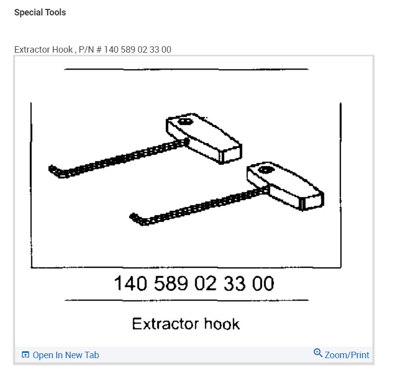

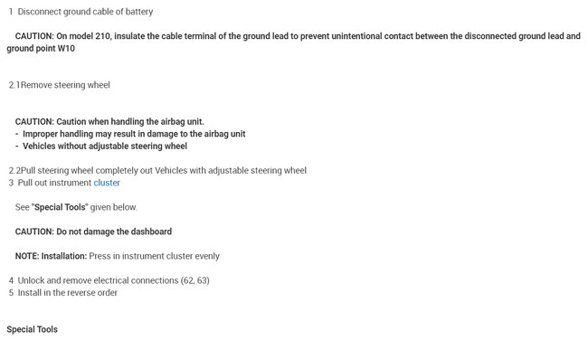

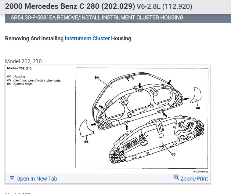

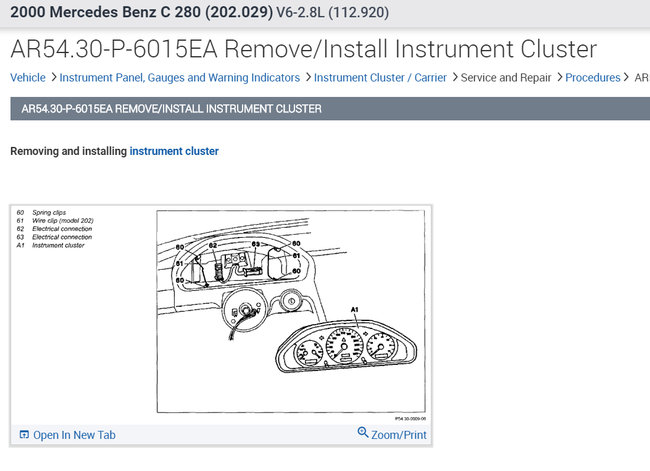

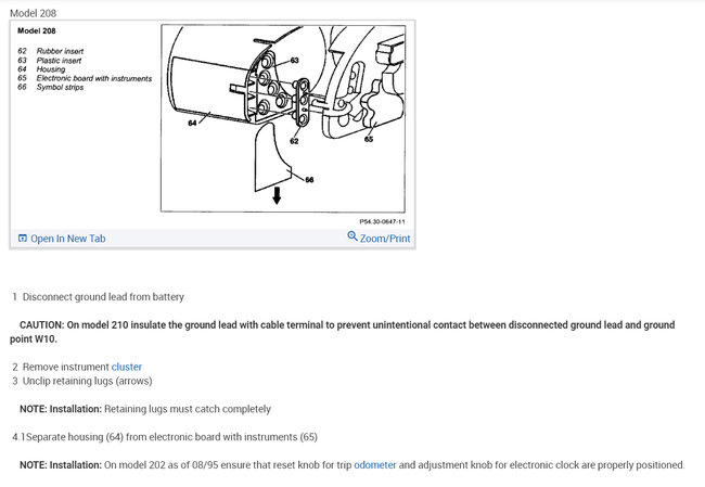

I have seen this in the shop and had to replace the instrument cluster with a used/rebuilt. here is a video of the job being done on a different car and diagrams below to show you how on your car:

So was the comment (in another forum even) remotely accurate when they stated that the "body control module" would be the problem here. Thank you very much for the diagrams and video. I already had the cluster removed. Just performing a manual check on connectors, etc. Wanted to make sure that the motors associated with the gauges weren't somehow causing the issue either. So I reconnected the instrument cluster, but the problem still exists. So you think replacing the cluster would resolve the issue? And then, I can buy an instrument cluster, but I'm going to assume I have to take that to possibly either a Mercedes dealership, or at the very least Mercedes repair shop to have the data (miles specifically) transferred from the old one to the new one.

Yes the data needs to be transferred. Please let us know what happens.
