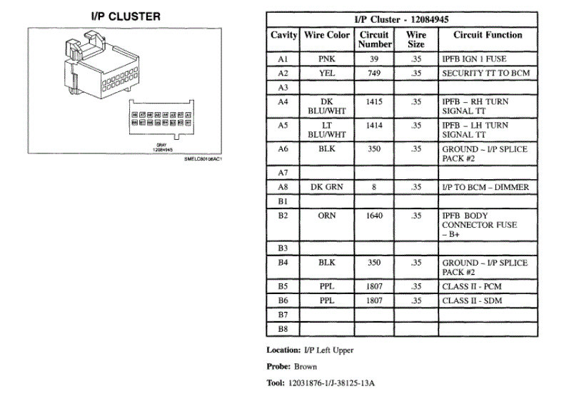

I need the wiring diagram for the cluster connector.

Good afternoon,
I attached the connector diagram for you to view. It identifies pins and there functions.

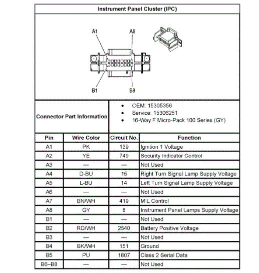

The cluster is a direct swap into a 2002 Saturn S Series, but the SES light doesn't work. I was having a hard time finding this diagram, now I need the diagram for the 2002 Saturn SC2, so I can move the wires around to get it working. The turn signals and all the gauges work right now.
Sep 12, 2020 at 1:06 PM
Okay, I attached the Saturn below as well.
Sep 12, 2020 at 1:16 PM
CHRISPEL
Thank you very much. I have been looking for both diagrams for a year now. Looks like I need to move B6 to A7 on the Saturn connector. Fingers crossed the instrument cluster can understand what the BCM is programmed to send.

CHRISPEL
Moved the pin and the BCM would not let the car start. Guess I'm going to have to live without the SES light working.
Sep 12, 2020 at 2:14 PM
Okay, hopefully you do not have emissions inspection. That is required to work for inspection.
