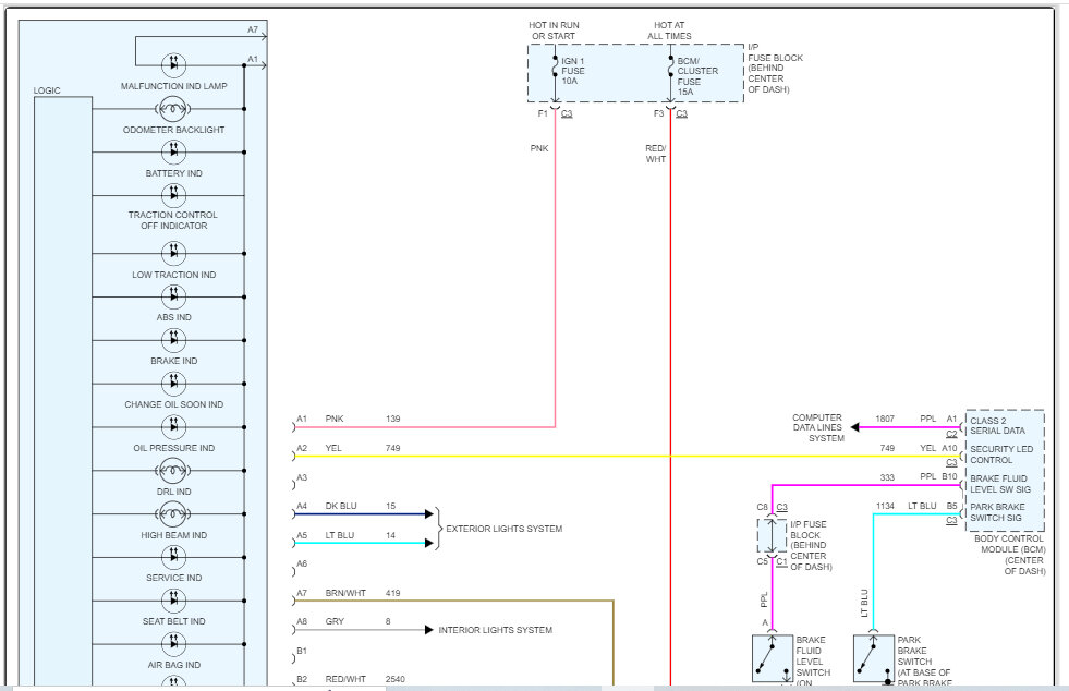

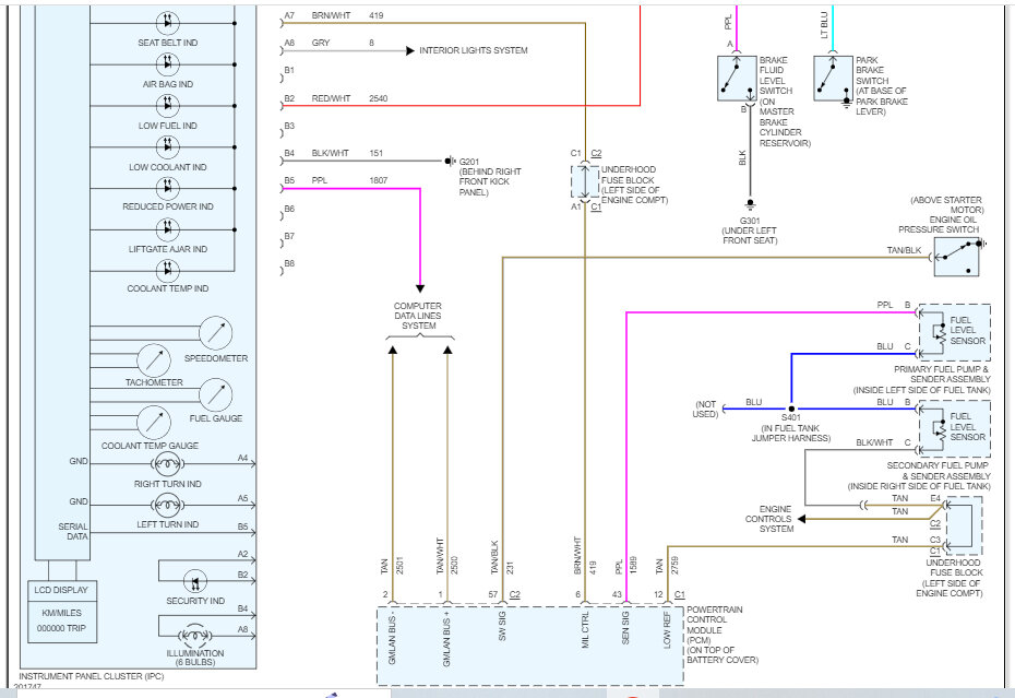

I need an instrument cluster pinout connector description for the vehicle listed above LS.
Dec 6, 2022 at 3:05 PM
Experienced Mechanic
110,244 POSTS
For some reason, the only thing I am finding is the general wiring schematic. The manual isn't providing a connector pinout.
Take a look at the schematic. It does show the wires going to the IP. Take a look at it and let me know if it helps.
