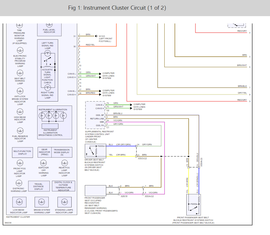

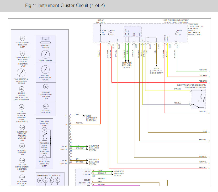

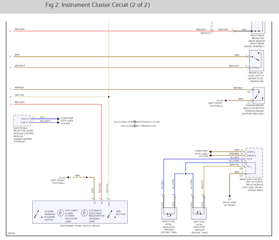

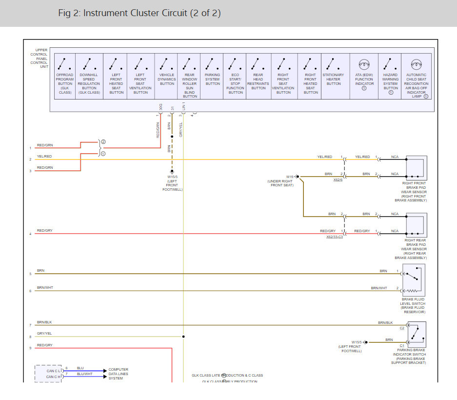

Can you check for power at fuse # 18 and 28 in the front SAM control unit? Here is a guide to help us with the instrument cluster wiring diagrams so you can see how the system works:
