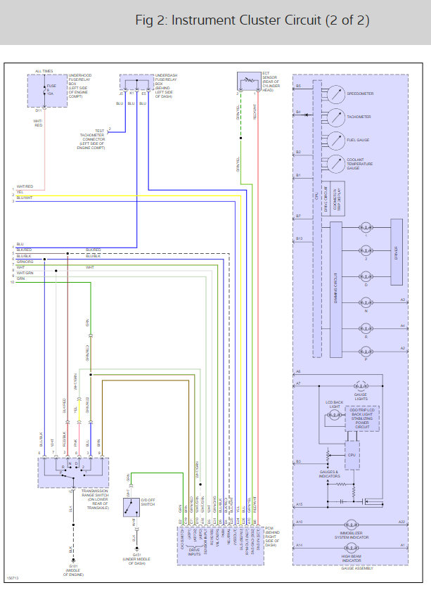

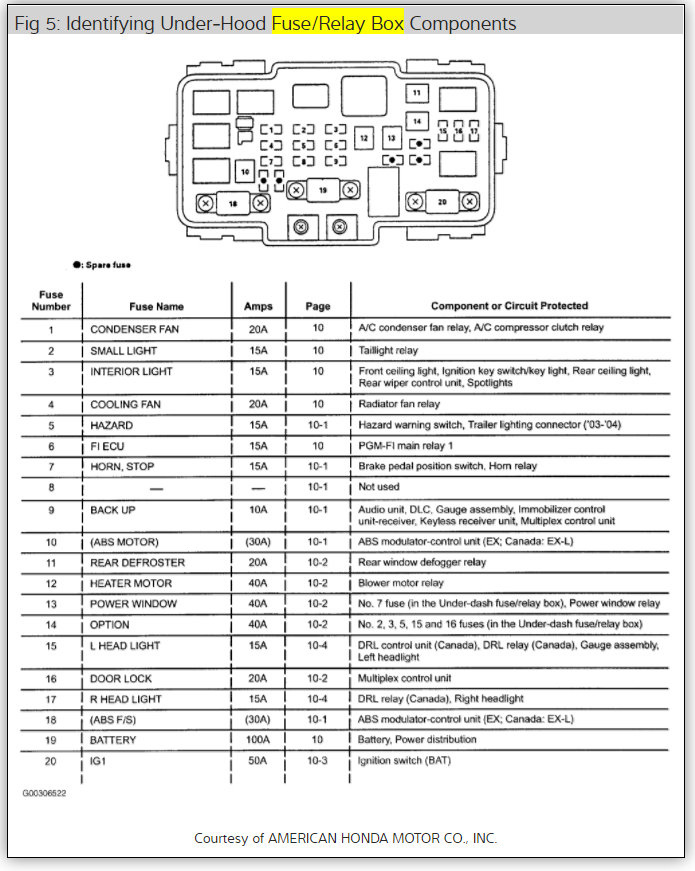

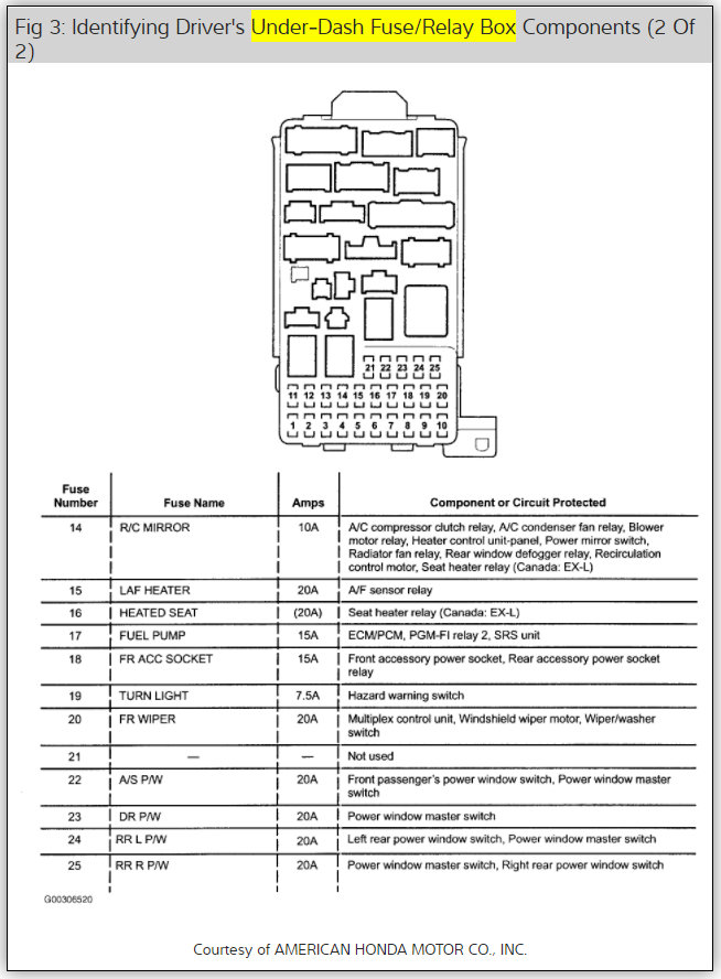

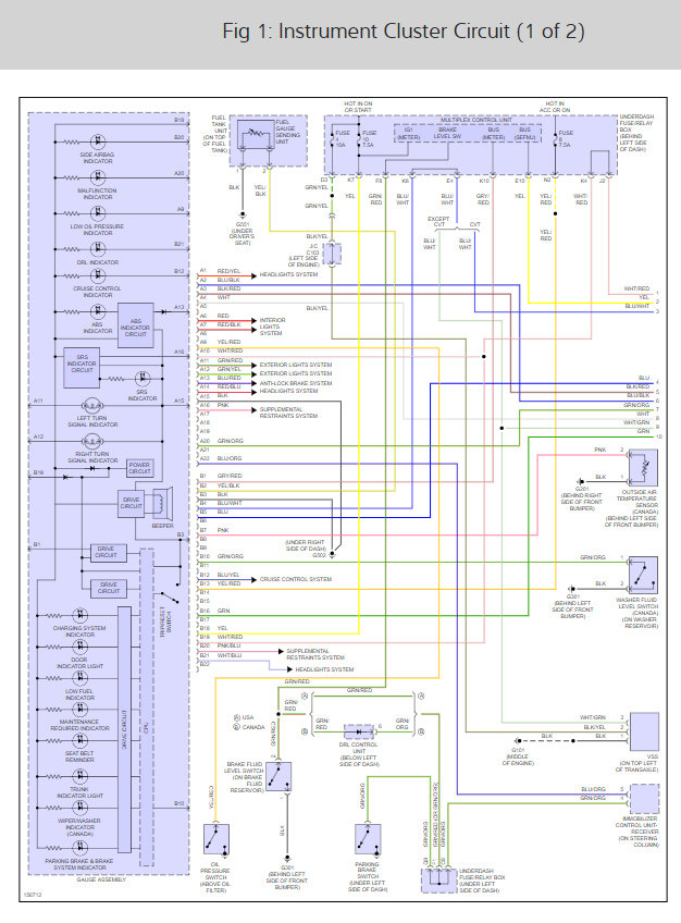

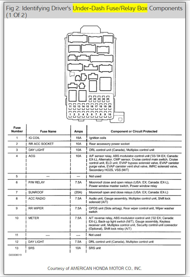

my odometer lights were blinking so I read unhook the negative cable wait sixty seconds put it on did that. now I have no speedometer, tachometer, temperature gauge and fuel gauge, nothing works. Checked all the fuses everything is good.

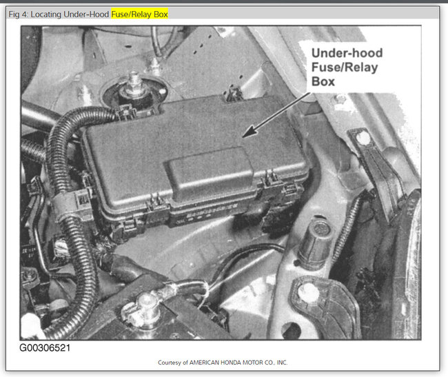

It sounds like you lost a fuse. there are four that run the system. did you check all of them? Here is a guide to check to see if you have power at the fuses as well. Here is the instrument cluster wiring diagrams and fuse locations along with a guide to help you run the test.
