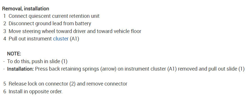

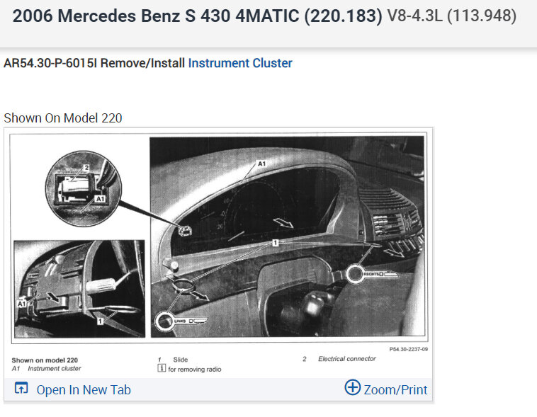

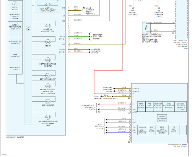

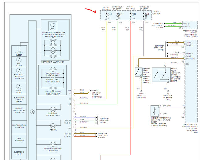

Yep, the fact that the fuse was blown means the cluster is having internal issues. But I can also tell you it might be the front SAM control unit as well. Here is the cluster wiring diagrams so you can see how the system works and there are other fuses that must be checked as well, which are listed in the wiring diagrams (red arrow). Also, I have included how to remove the cluster for inspection.
When the cluster is removed see if you can smell or see anything that is burnt? Check out the images (below). Please upload pictures or videos in your response of any problems so we can see what to help you with.
