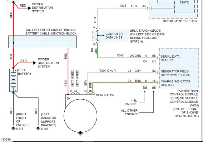

Instrument cluster, intermittent issue with gauges not working
163,600 MILES • 4.3L • V6 • 2WD • AUTOMATIC
K.KILGORE
New to me truck purchases 3 days ago.
The truck listed above is a 2WD step-side with a tilt steering column.
The headlight switch needs to be replaced. When turning on, you have to turn back just a tough to get headlights to come on. The auto on and off works just fine.
The frame is in excellent condition. That is the reason I bought the truck. The previous owner told me of the issue. Said issue would go months and not happen. Then maybe act up for a few days. Then wait months before it happens again.
It has an intermittent issue with gauges not working. The fuel, temperature, oil pressure, and tachometer will bounce or completely stop working.
Haven't been driving when this happens. So don't know if the speedometer is affected. The check engine light is on, but I haven't had a chance to have codes read. Waiting until I get it transferred in my name before driving. Just moving around in driveway to mow and move my boat around.
The message center shows not charging but voltmeter shows charging.
I'm thinking it is a ground issue but don't know where to look or the ground points.

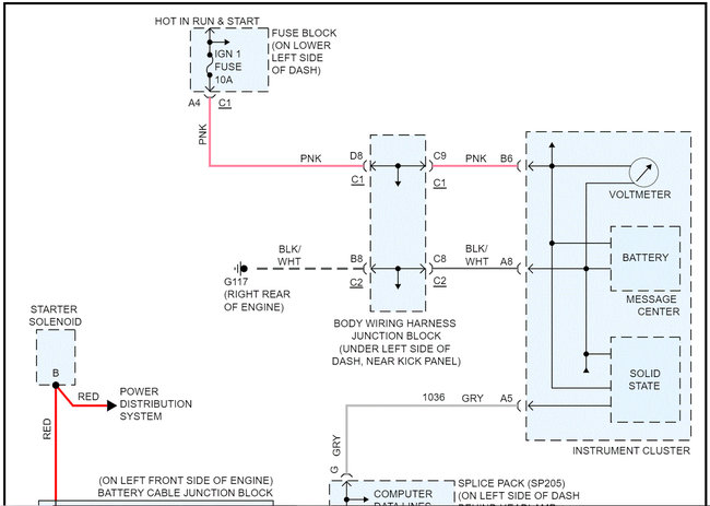

The instrument clusters in the GM trucks during this time period are known to fail and need to be rebuilt. What you described sounds like that is the case. The solder joints fail internally on the printed circuit boards. As a result, the gauges act a bit crazy.
As far as the charging, I attached the wiring schematic below for the charging circuits. Take a look through them.
Also, let me know how you determine the alternator is producing.
I will watch for your reply.
See pics below. Note: I had to cut the schematic in half to make it readable. I did overlap them so you can follow from one to the next.

I look forward to hearing what you find. Hopefully, it is something simple. As far as the alternator test, I don't know if you need it, but here is a link that explains how to perform the test:

Used the diagrams you provided and determined pin A8 (ground) going to the instrument cluster now has 1 OHM short to the metal in steering column, key switch, and door nuts. This was after cleaning the firewall ground location. So, I don't know what it was before.
The headlight switch from the blazer wouldn't work as a donor. Since blazer switch was made with a place for fog lights. Which the Sierra doesn't have. So, I took the existing switch out of Sierra, disassembled, stretched a little spring for the contacts. I applied some more dielectric grease and reassembled. Switch works as it should.
Using multi-meter, determined the battery had 11.98 DC volts. (Was playing radio while working on it) Started truck and gauges worked as they should. Message center was blank. Just had a service engine soon light on. So, I still need to get the codes read.
With the engine idle and at 1,500 RPMs, alternator was putting 14.25 DC volts at battery with headlights, blower, and radio on. Switched meter over to AC and had 0.33 AC volts at battery at 1000 RPM.
