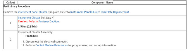

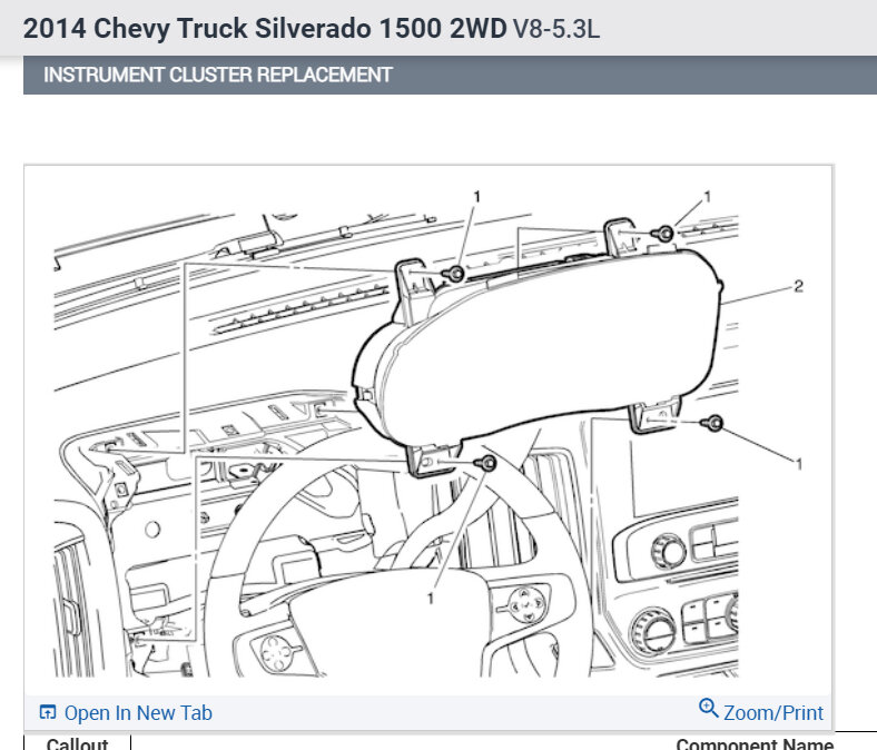

Here is how to change the cluster out which you can get a rebuilt, preprogrammed unit by searching Google or Ebay. Check out the images (below). Please let us know what happens.
