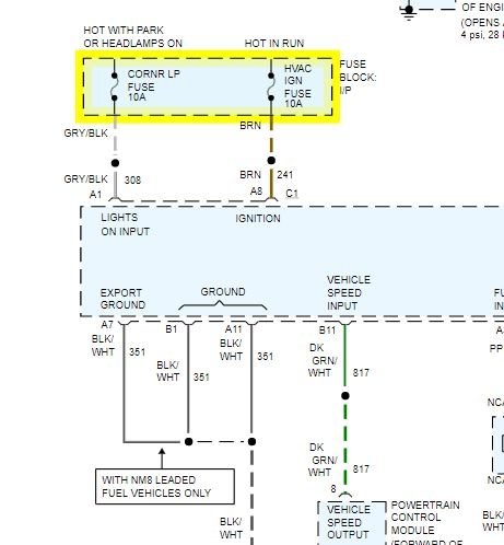

I attached a diagram of the cluster. I showed 2 fuses that power the cluster. Check the fuses listed for power on both sides with the key on. This is not a visual test, this is a voltage test at the fuse itself.
Oct 14, 2019 at 8:08 PM
CADYFRANK
  • 12 POSTS
Okay, so i did the check the fuses with the key on at the HVAC fuse. i have 12
at the corner fuse nothing.
Oct 14, 2019 at 11:12 PM
The headlights need to be on for the corner light fuse to get power.
Did you check both sides of the fuse for power to be sure th fuse is good?
If you did, then chances are the cluster is dead.

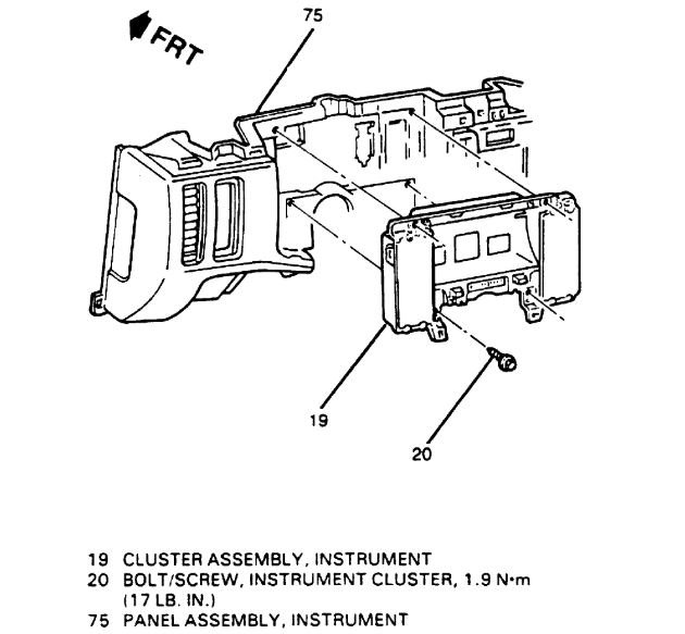

1. Remove instrument panel left sound insulator assembly.
2. Remove instrument panel driver knee bolster deflector.
3. Remove steering column tilt lever assembly.
4. Remove cluster trim plate.
5. Disconnect transmission shift indicator cable.
6. Remove instrument cluster attaching screws, Fig. 16 then remove cluster.
7. Reverse procedure to install.
