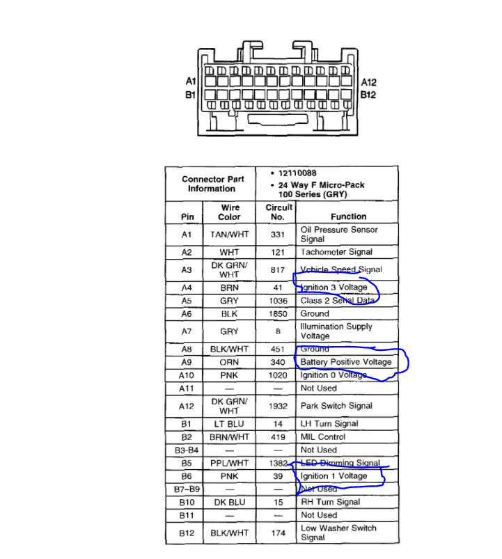

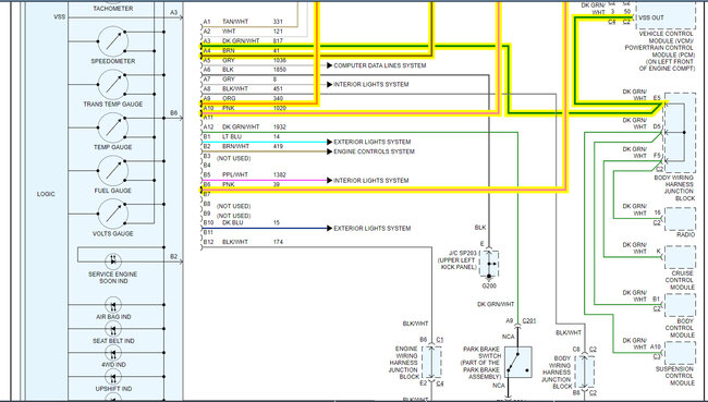

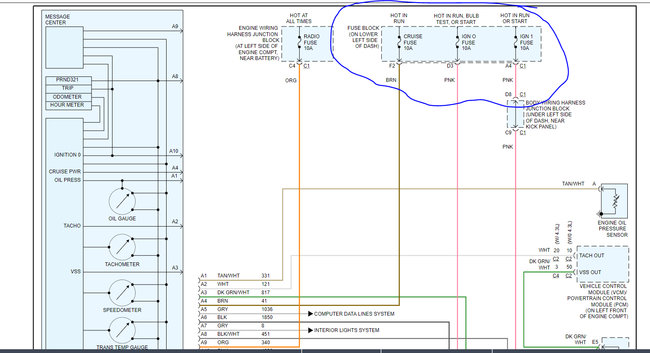

I cannot get the instrument cluster to light up mileage, security, fuel level and temperature gauge. The voltage, speedometer, tachometer (I think), check engine light all come on. I bought a new body control module that was already programmed to my VIN and it does the exact same thing. Even swapped used gauge cluster from the junkyard and it does the exact same thing. I'm at a complete loss on this thing and just need some help. Thanks in advance for any help that can be given.
May 2, 2021 at 11:33 PM
Good morning again,
I attached a wiring diagram of the cluster for you to view.
I also attached the connector. Check the pins I circled for power with the key on. If there is power, then the cluster is the issue. If you are missing power, then it is a wiring issue to the cluster.
May 3, 2021 at 10:23 PM
SSROBERTSON
  • 80 POSTS
Thanks Roy, after testing pins above I found out that the orange wire was not getting power. Once hooked up the gauge cluster is now lit up correctly. The only issue now is that when I shut the truck off, the mileage screen and battery light is staying on. Was the orange supposed to be a constant on, or should it be a switched power?
May 4, 2021 at 10:52 AM
It is battery power. It should have voltage all the time.
Did you get power to the orange wire?

Okay, I would have fixed that instead of that repair. Did you check the fuse for power on both sides for the orange wire?
If you have power now and the speedo does not work, then the issue is inside the cluster.

Correct. You have overloaded another circuit with your repair.
Run the new wire and make it correct.

I will check. And I have a constant power at the orange and the red wire (next to the orange) with the key off. I just tested it to see if this helps?
May 28, 2021 at 6:34 AM
No, only test for power with the key on. You need the correct voltage from the cluster for the gauge to work. The gauge should not work with the key off at all.

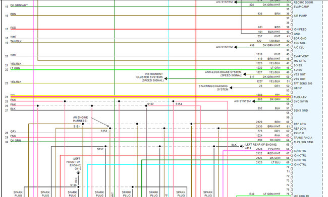

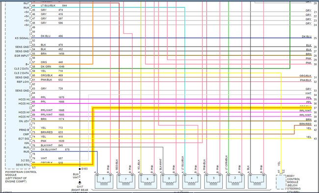

I was referring to the fact of the cluster staying on with the key off. What color wire should I be testing at the cluster for voltage to the fuel sensor? I can't find it on the schematic.
May 28, 2021 at 6:48 AM
Okay, I sent another diagram for you. The 2 wires for the sender come from the ECM. I highlighted the wire. They are purple and orange/black. The purple is the sent voltage and the orange/black is the return. From there, it is sent by serial data line to the cluster.
Test those wires. The connector numbers are marked in the diagrams. The purple wire should have power back at the sender with the key on.
May 28, 2021 at 7:11 AM
SSROBERTSON
  • 80 POSTS

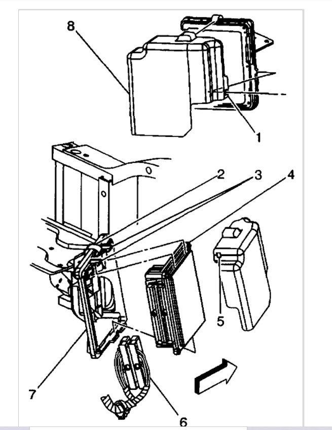

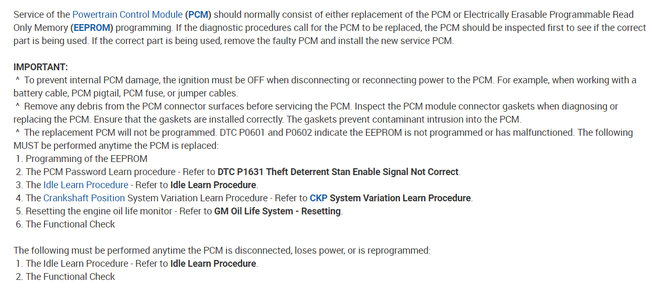

I checked and I'm not showing any voltage on the purple wire right at the ECM.
May 28, 2021 at 8:09 AM

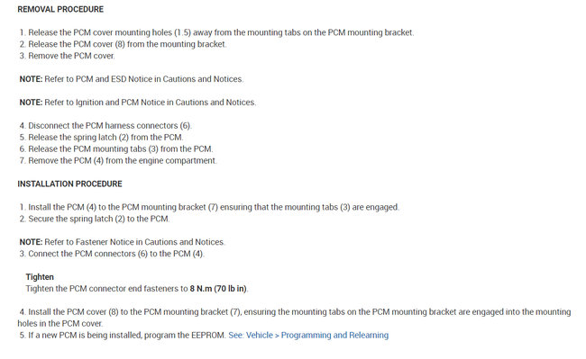

Okay, then you may have a bad ECM. I attached the procedure below.
May 28, 2021 at 8:57 AM
SSROBERTSON
  • 80 POSTS
Not what I want to hear, lol. Is there any fuse that may be related to this issue? If this is the only issue I'm having can I get power from somewhere else?
May 30, 2021 at 3:24 PM
There is no fuse for this control and there is no overlay you can do to get it to work. Sorry, you need to replace it based on your results.

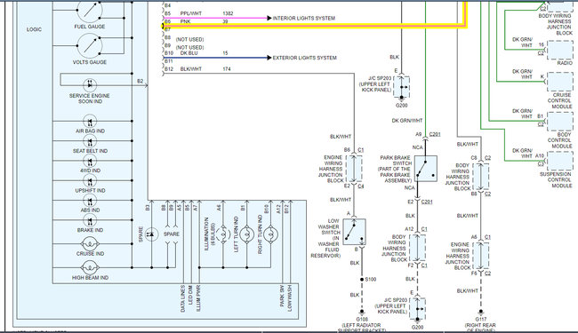

Okay. I appreciate that. As for the pink wire in the cluster that seems to be saying it's positive with the key off, the diagram you sent me shows ignition o volts, I don't understand if that is just supposed to be ignition "on" or something else.
May 30, 2021 at 8:18 PM
The ignition on, sorry.

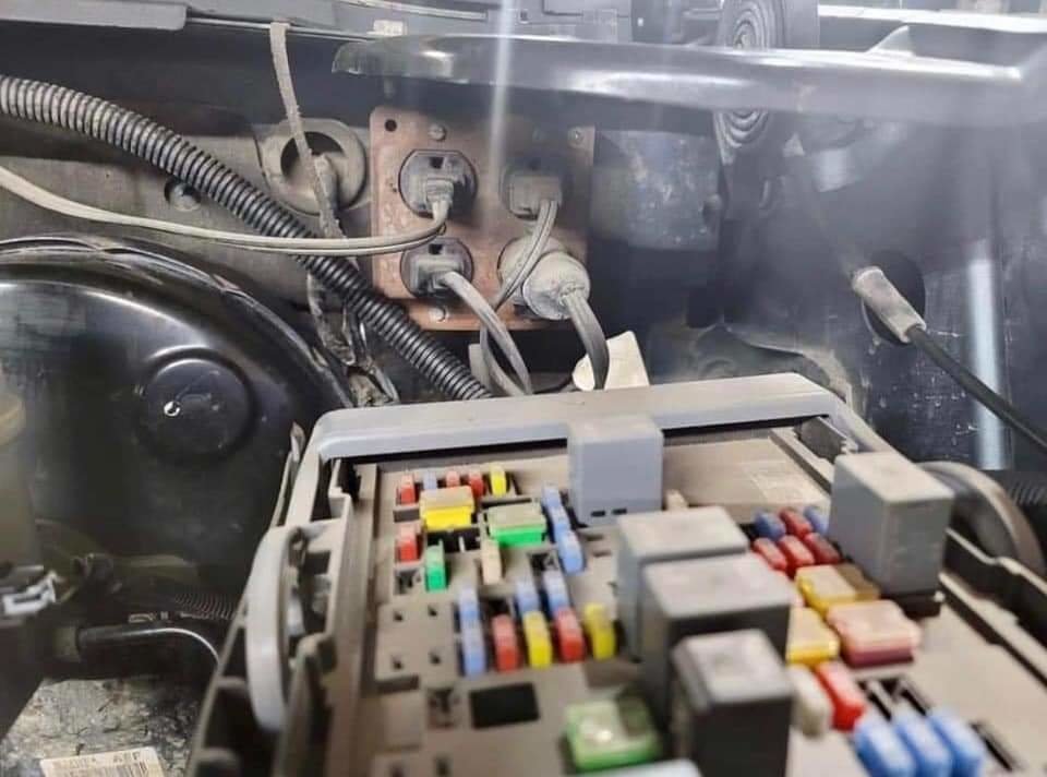

It's just something funny I wanted to send you since we have been dealing with wiring issues.
May 31, 2021 at 1:19 AM
Oh my goodness. What is that and how is it hooked up?
May 31, 2021 at 1:28 AM
SSROBERTSON
  • 80 POSTS
I'm not sure, it's just a picture I found online. It just feels like what I was doing with all the wires. Lol
May 31, 2021 at 1:30 AM
Is that what is under the hood of your truck? If not, why are you posting it? I do not understand.
May 31, 2021 at 1:32 AM
SSROBERTSON
  • 80 POSTS
It's not my truck. It was just something funny I seen on the internet and I wanted to send you for a laugh.
