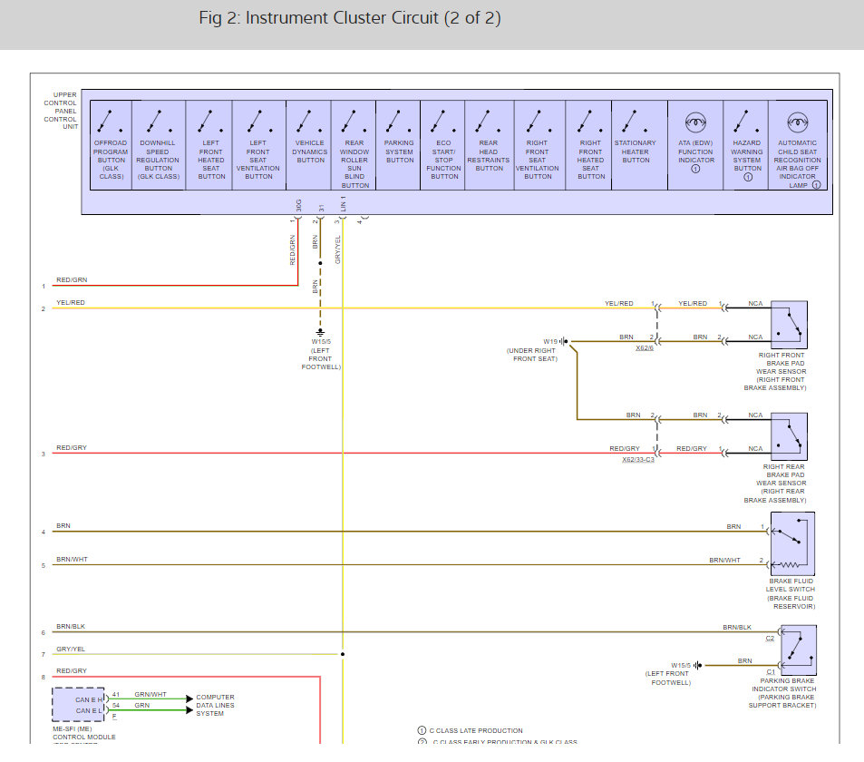

the instrument cluster is completely dark not showing any warning lights, speedometer, tachometer, indicators etc.
Feb 16, 2018 at 12:06 AM
Experienced Mechanic
55,579 POSTS

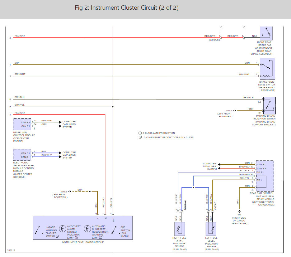

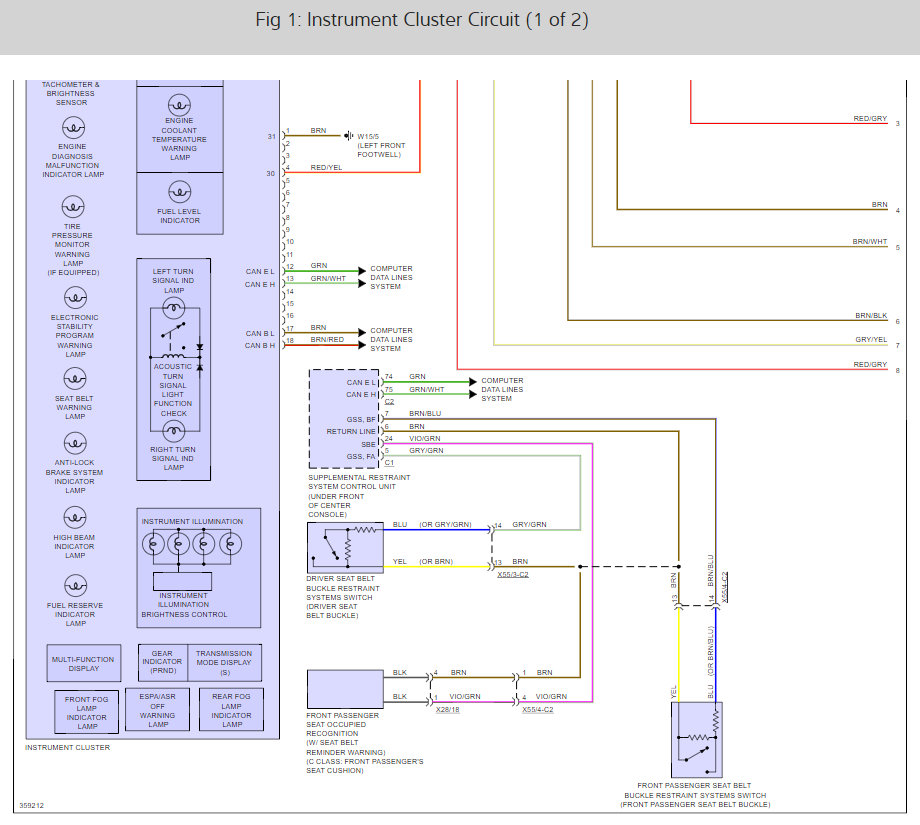

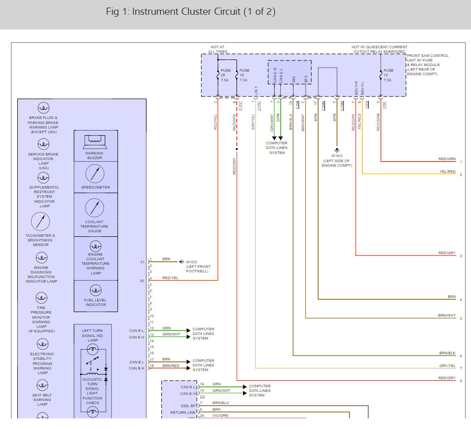

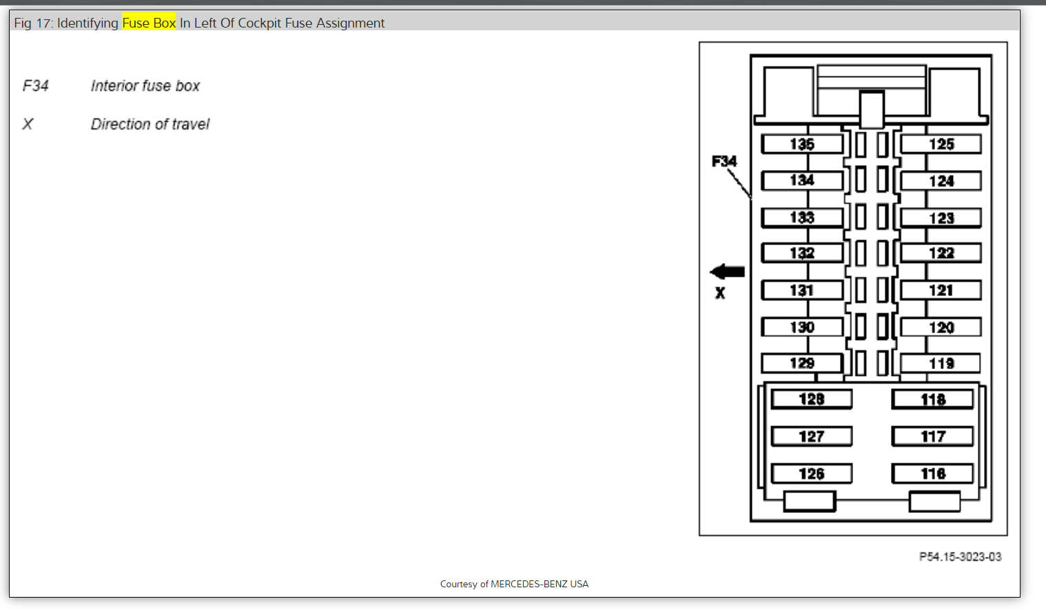

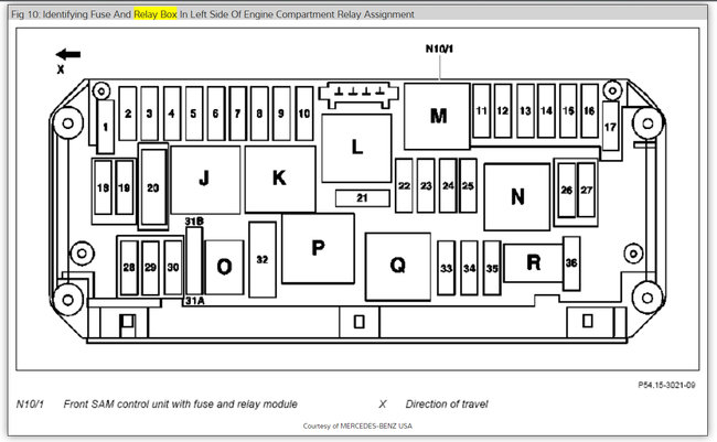

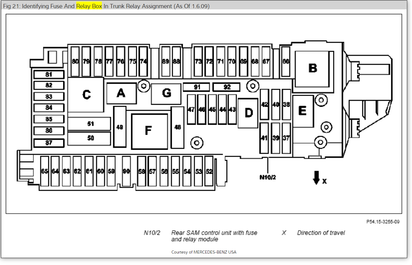

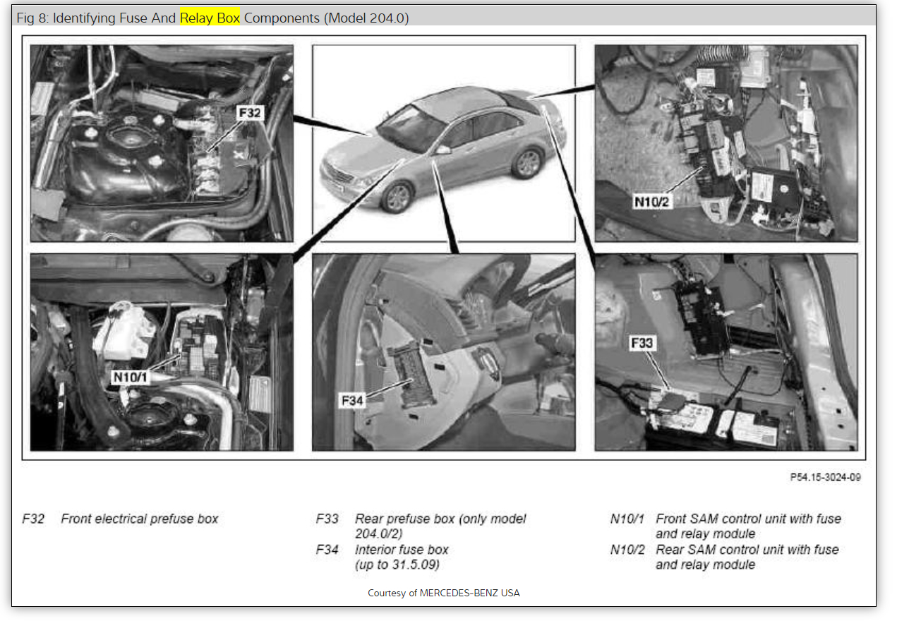

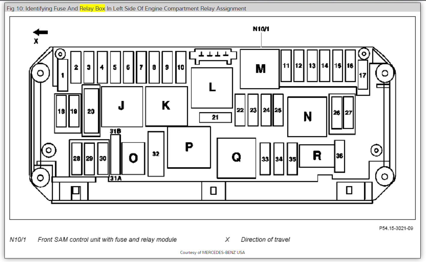

It sounds like you popped a fuse # 28, 18 or 12. Here is a guide to help you check the fuses:
Here are the fuse locations (below).
Please run some tests and get back to us.
