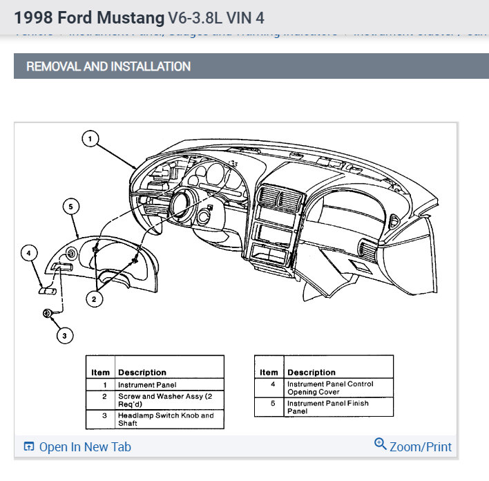

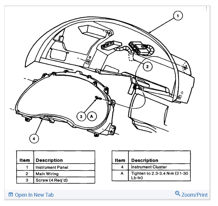

What code number is it because it does not say it needs to be programmed in the replacement instructions. Check out the images (below). Please let us know how it goes.
