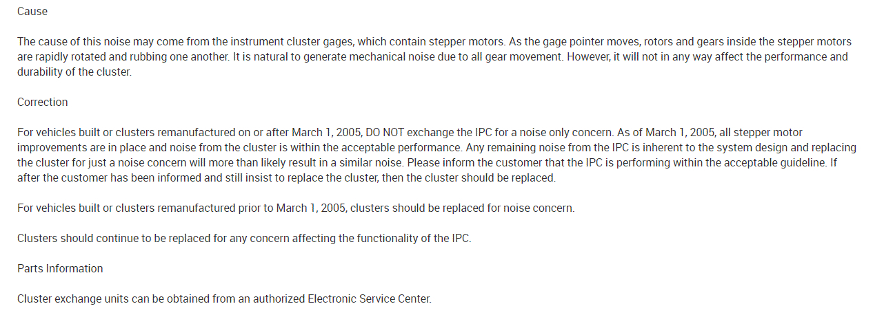

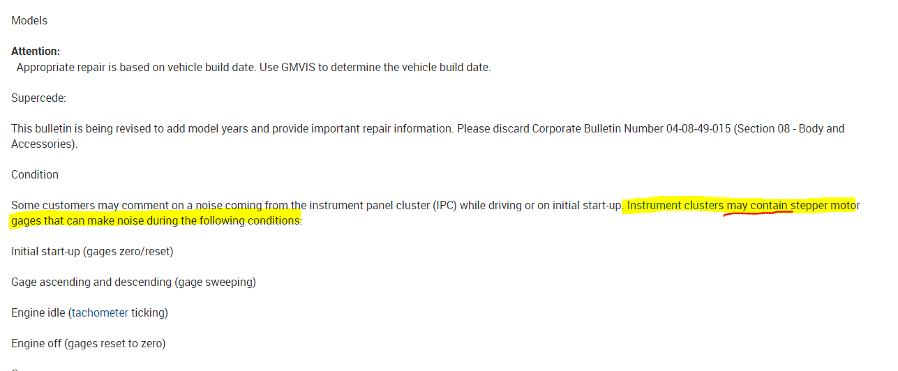

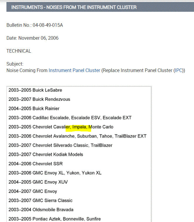

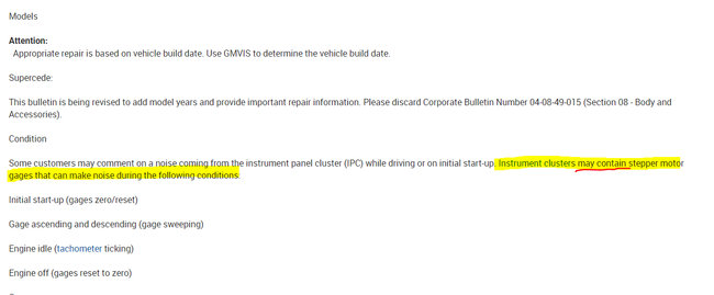

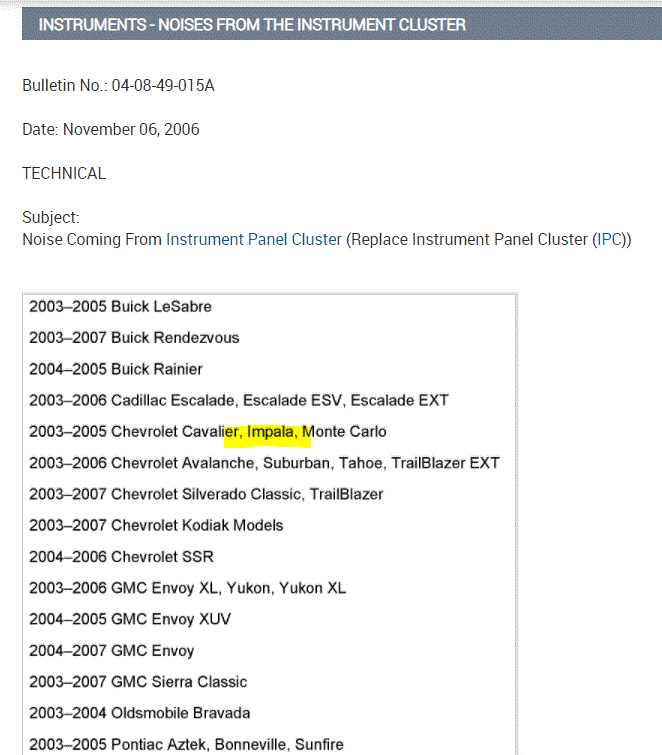

Some of the instrument clusters could have stepper motors. I don't have the specifics on the Canadian model, but I did find a technical service bulletin that may be of interest to you.
As far as the gauges, what exactly is happening? Have you checked all connections? I know there were some models that the IC would fail, but I'm not sure what exactly is happening for you.
I attached the TSB below. The primary complaint was noise, but it also included gauges not working correctly.

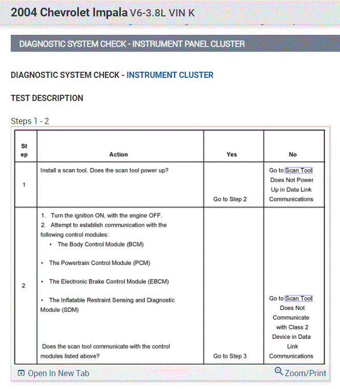

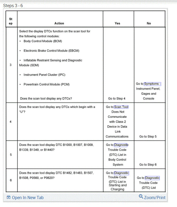

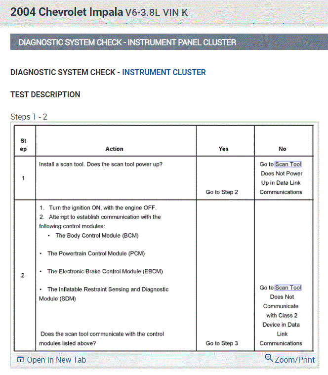

If they all started working like this at the same time, I don't think it's a stepper motor issue. I suspect the cluster itself is shorted internally. If the gauges are starting higher than they should, they have to be getting a signal (power).
I attached a general diagnostic test to confirm there is communication between the IC and related modules. Take a look through it and let me know if it is something you are comfortable doing.
