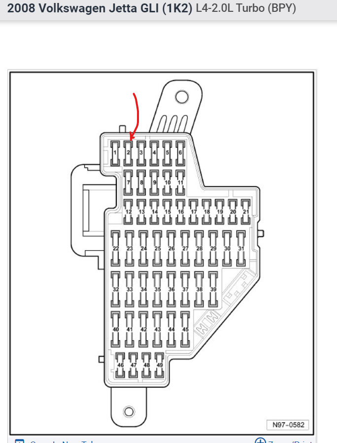

None of the instruments on the dash are working?
340,000 MILES • 1.4L • 2WD • MANUAL
MARTINR7
I turned on my car after being off for a couple weeks.
Jan 10, 2024 at 7:35 PM
  • 55,721 POSTS

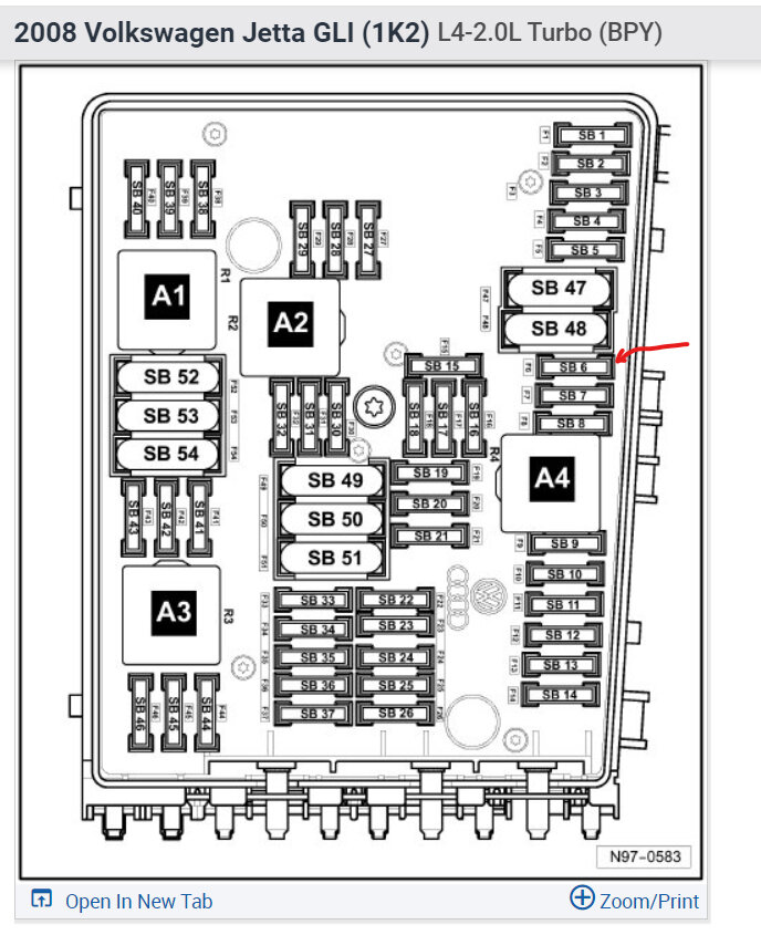

There are two fuses that need to be checked, #2 in the C fuse panel and #6 in the B fuse panel.
Here is a guide to help us and the fuse location it the images below:
Jan 11, 2024 at 2:49 AM
MARTINR7
Hi Ken, yesterday I took out a lot of fuses to check them as there was condensation in the car. When I went to check the car today everything was back working.
Jan 11, 2024 at 10:35 PM
  • 55,721 POSTS
Yep, must have dried out. Please let me know if it happens again.
