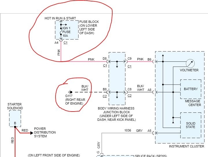

The battery light in the message center is on permanently. Several gauges have stopped working as well as some lights. My air conditioner has failed, won't turn on. Cruise control has stopped working and rear window defroster has stopped. All are associated with the battery light in the message center. I was told it was in my ignition switch. I have replaced it and all associated wiring. Did not work! Can you help me?

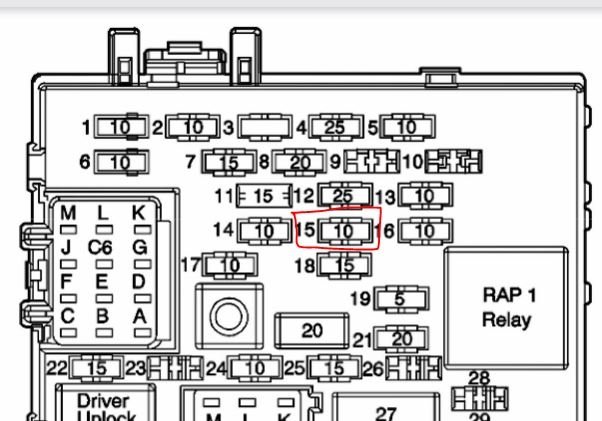

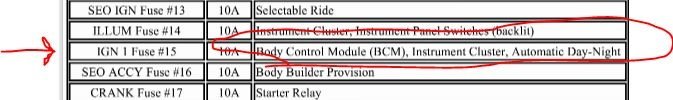

I need to start simple with this. The first things I need checked are the power supply to the cluster (ignition 1 fuse) and the ground. This fuse powers the inst cluster and the body control module. Take a look at the picture I attached. I circled both things in the schematic and pictures 2 and 3 show fuse location. Check to make sure both are good.
Here are a few links that may help:
Let me know your findings.
