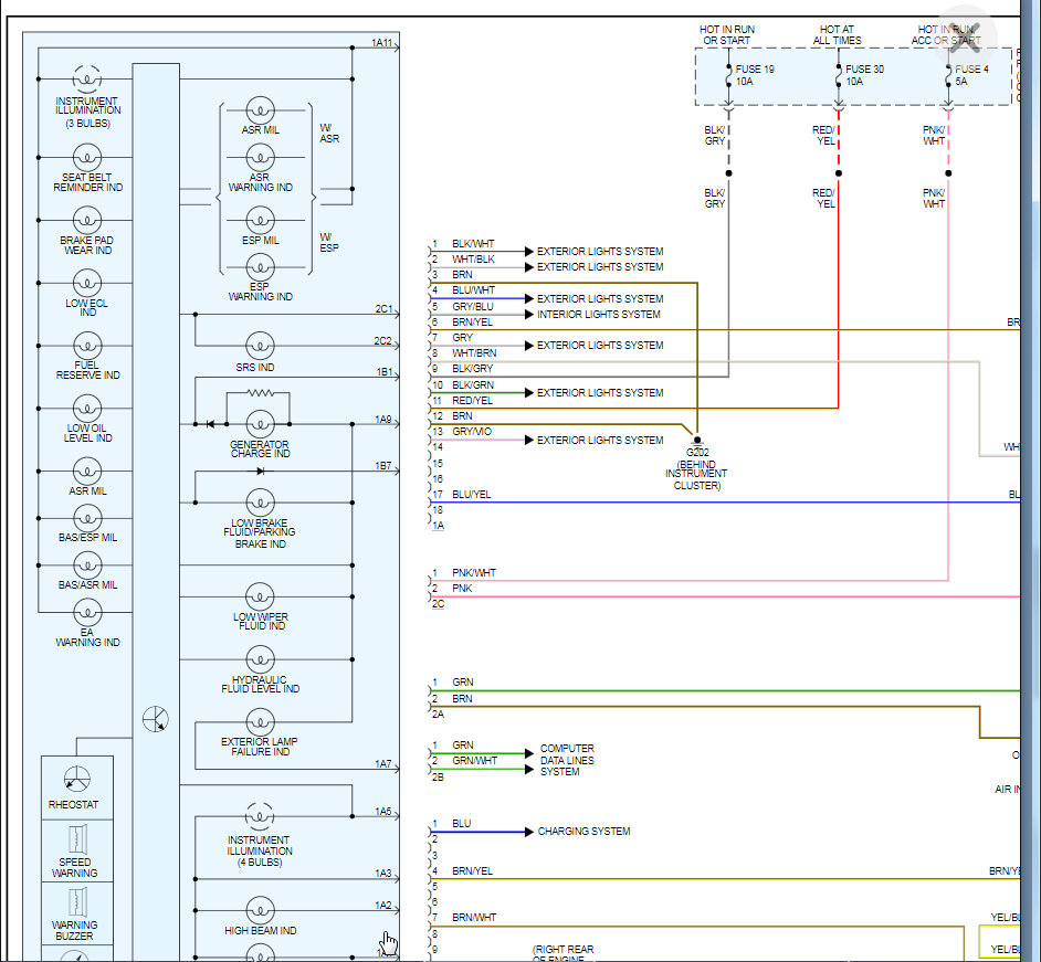

Fuse #19 gets burnt when replaced. seems it is in short but where? Can this short be before or inside cluster? High beam light does not holds with lever and rest oh head light don't work. maybe these 2 issues are separated. Ignition switch run engine fine. Additionally fob key does not close/open doors.

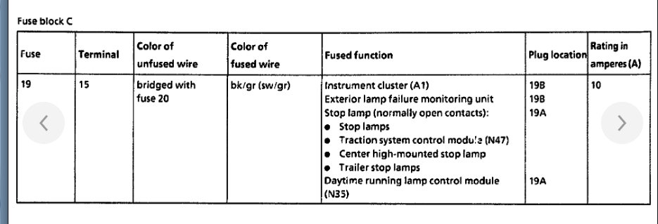

I think you are correct that there is a short to power but the only way to test that is to test the fuse for a short to power. This could be an issue with the cluster itself or one of the other sensors or components on that fuse as well. The best way to figure something like this out is to install a smaller fuse on each individual component and see which fuse blows before the 10A fuse does. This will tell you what component or circuit is the issue.
I attached the items that are on the fuse which includes the brake lamp switch. I would start with this. Unplug it and see if the fuse keeps blowing.

Sorry Kase in delaying my response. We had a good diagnosis, Fuse #19 was blowing because it was grounded. As recommended, I tested disconnecting left side stop light then fuse kept alive. After that I checked the stop light socket because I use to had issues before, I found a bronze metal chip doing the grounding, once removed this trash everything works fine. Even front head lights and dash instruments are related to this circuit, not only fuses #33/34. Thanks in recommend the right test.
