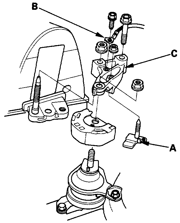

1998 Honda Accord DX Sedan L4-2254cc 2.3L SOHC MFI

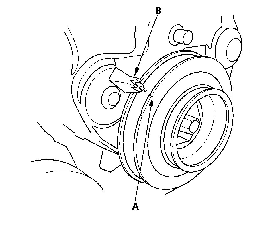

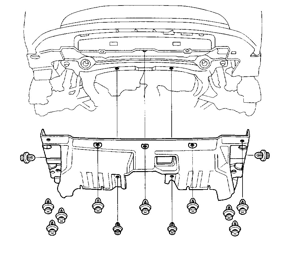

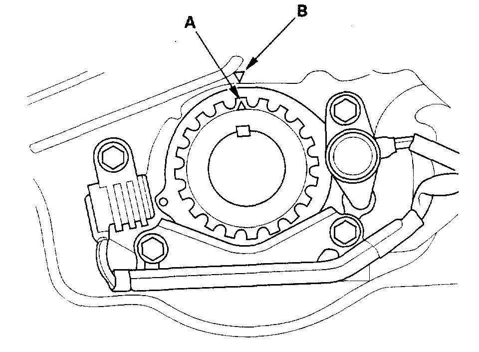

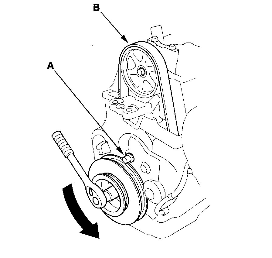

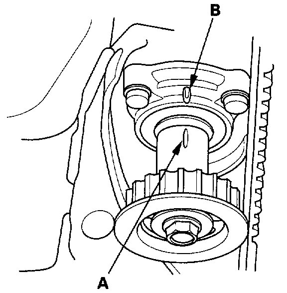

3. Turn the crankshaft pulley so its Top Dead Center (TDC) mark (A) lines up with the pointer (B).
4. Remove the front tires/wheels.
pic 2

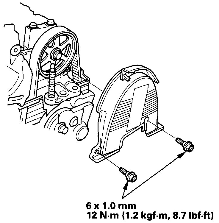

5. Remove the splash shield.
pic 3

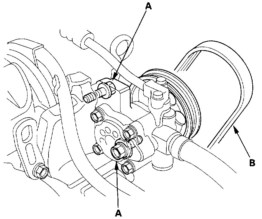

6. Loosen the mounting bolts (A), then remove the Power Steering (P/S) belt (B).

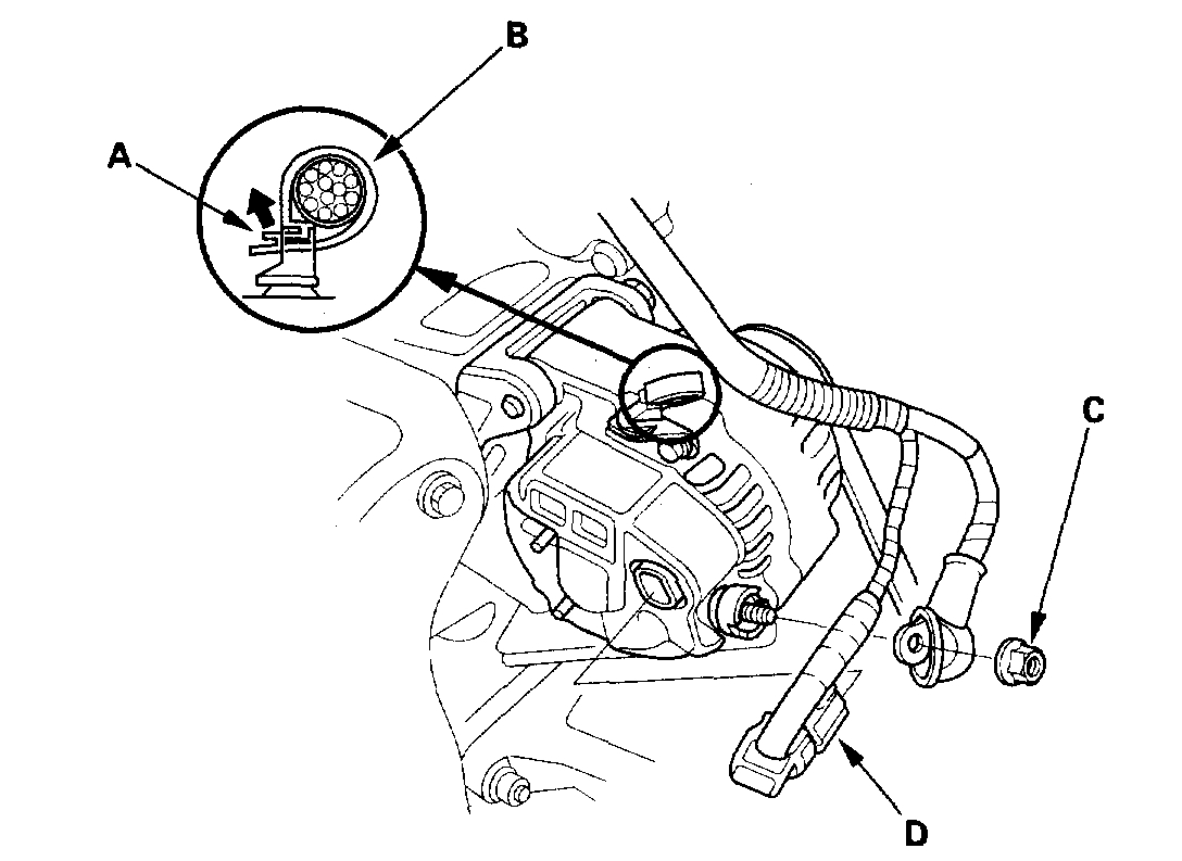

7. Disconnect the alternator wire harness.
-1 Pull up the lock (A), then release the wire harness tie (B).
-2 Pull back the boot and remove the 6 mm nut (C).
-3 Disconnect the connector (D) from the alternator.

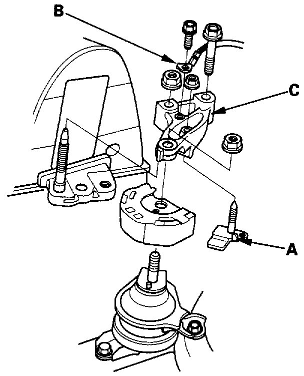

10. Support the engine with a jack and wood block under the oil pan.
pic 5

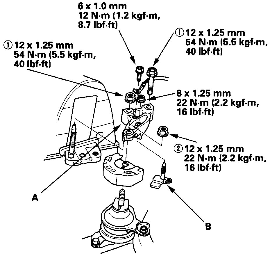

11. Remove the stop (A) and ground cable (B), then remove the upper bracket (C).

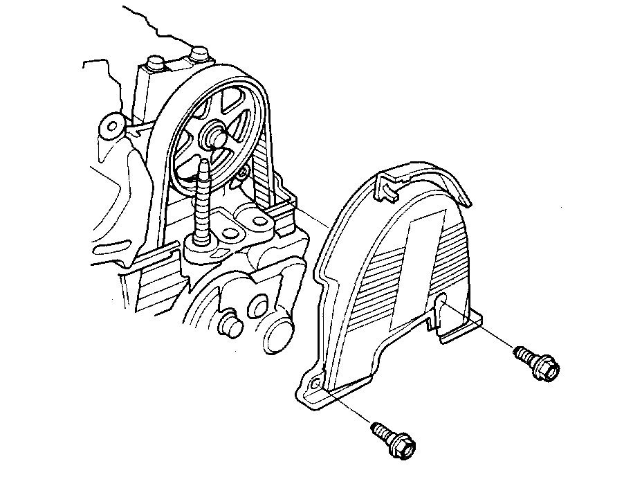

13. Remove the upper cover.

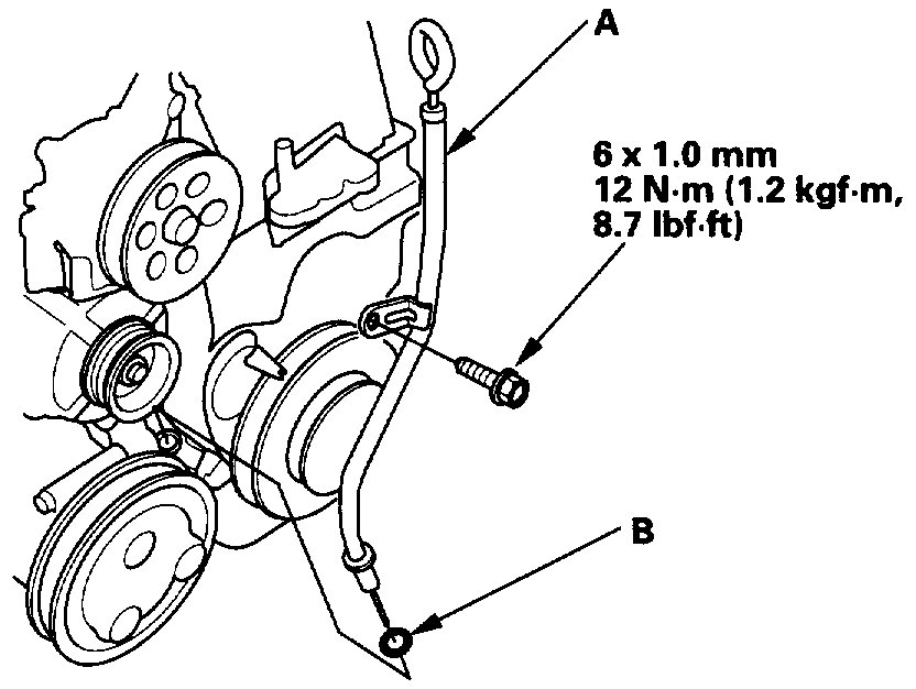

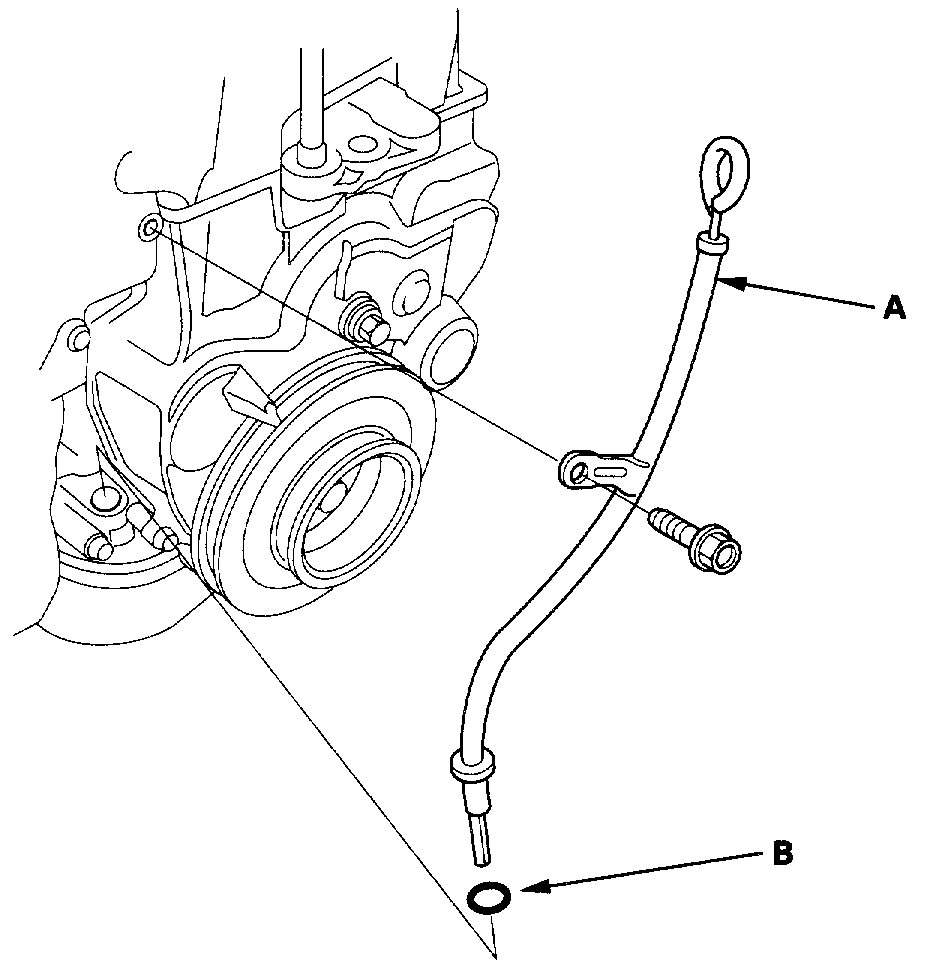

14. Remove the dipstick and tube (A). Discard the O-ring (B).
pic 8

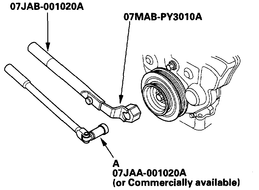

15. Hold the pulley with the special tools.
16. Remove the bolt with a heavy duty 19 mm socket (A) and breaker bar.
pic 9

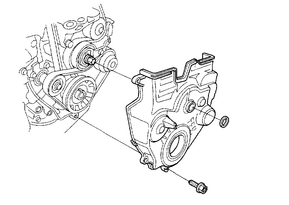

17. Remove the rubber seal from the adjusting nut, then remove the lower cover.

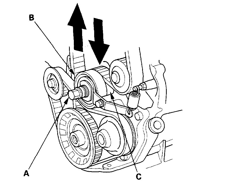

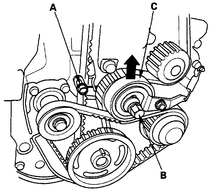

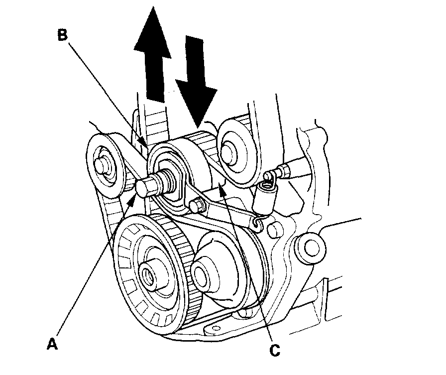

20. Release tension from the balancer belt and the timing belt:
-1 Loosen the adjusting nut (A) 2/3 - 1 turn.
-2 Push the balancer belt tensioner (B) up to take tension off the balancer belt.
-3 Push the timing belt tensioner (C) down to take tension off the timing belt.
-4 Retighten the adjusting nut (A).
21. Remove the balancer belt.
22. Remove the timing belt.

3. Set the crankshaft to Top Dead Center (TDC). Align the dimple (A) on the tooth of the timing belt drive pulley with the pointer (B) on the oil pump.
pic 13

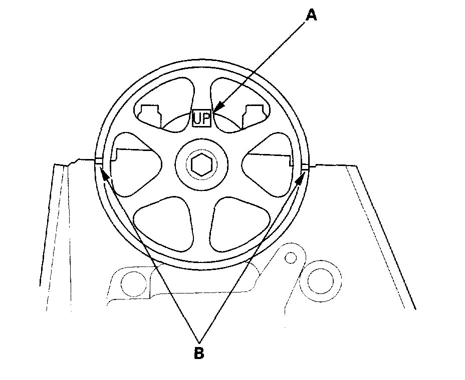

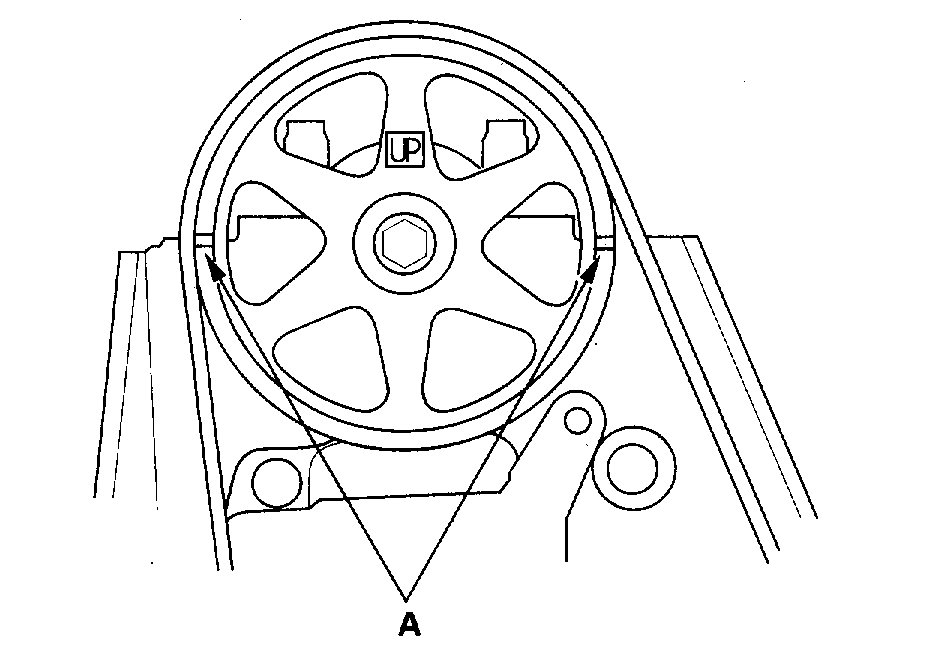

4. Clean the camshaft pulley and set it to TDC.
-1 The "UP" mark (A) on the camshaft pulley should be at the top.
-2 Align the TDC grooves (B) on the pulley with the top edge of the head.
pic 14

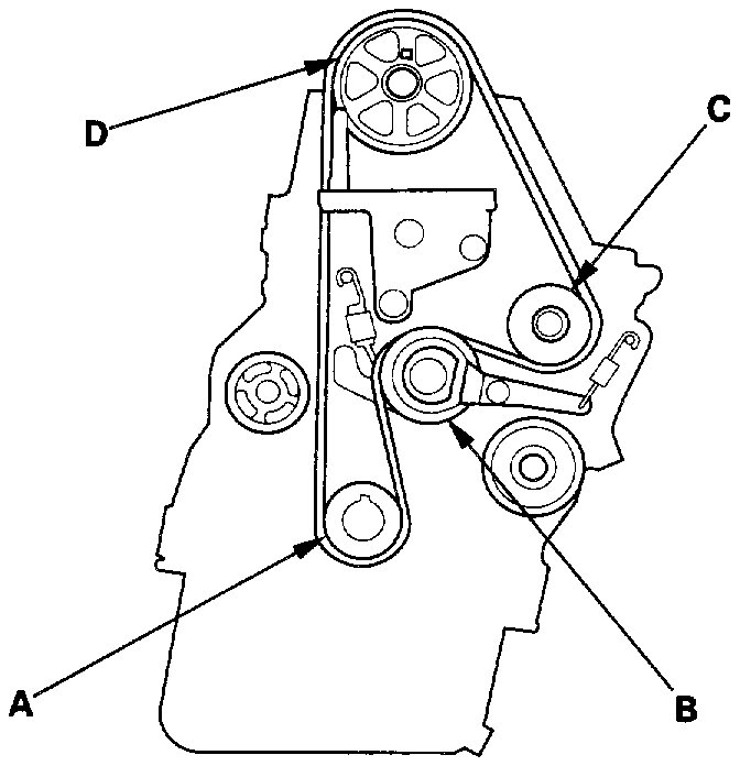

5. Install the timing belt in a counterclockwise sequence, starting with the drive pulley.
-1 Drive pulley (A).
-2 Tensioner pulley (B).
-3 Water pump pulley (C).
-4 Camshaft pulley (D).

13. Turn the crankshaft pulley so its TDC mark (A) lines up with the pointer (B).

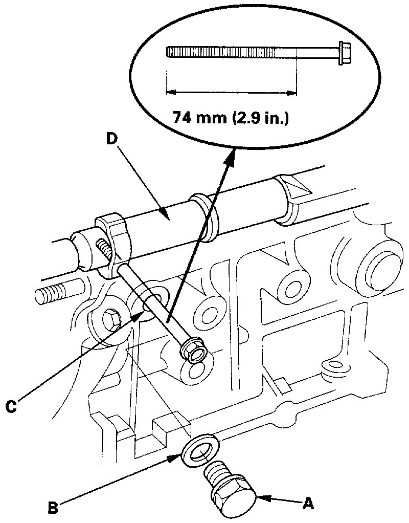

19. Align the rear balancer shaft pulley with a 6 x 100 mm bolt (or equivalent).
-1 Remove the bolt (A) and washer (B) from the maintenance hole (C).
-2 Scribe a line on a 6 x 100 mm bolt, 74 mm (2.9 in) from the end.
-3 Insert the bolt in the maintenance hole and into the hole in the balancer shaft (D) up to the line you scribed.

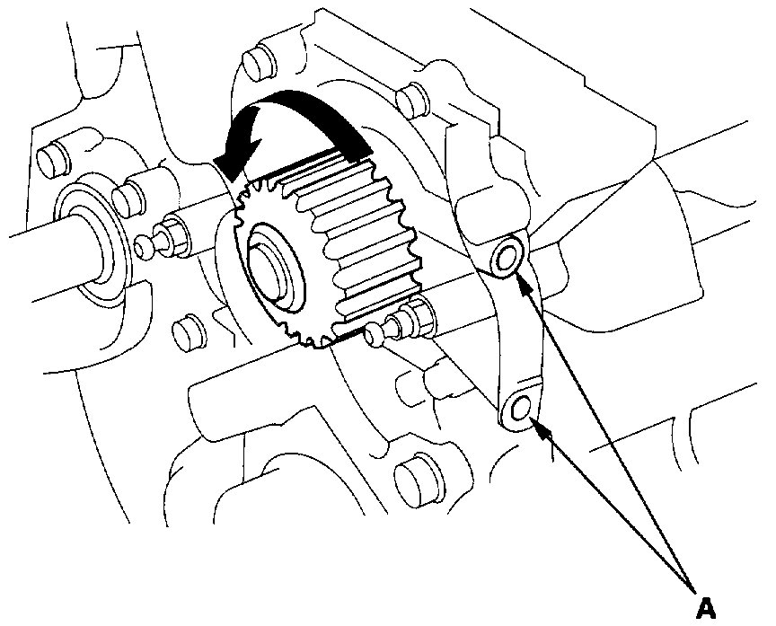

20. Align the groove (A) on the front balancer shaft with the pointer (B) on the oil pump housing as shown.

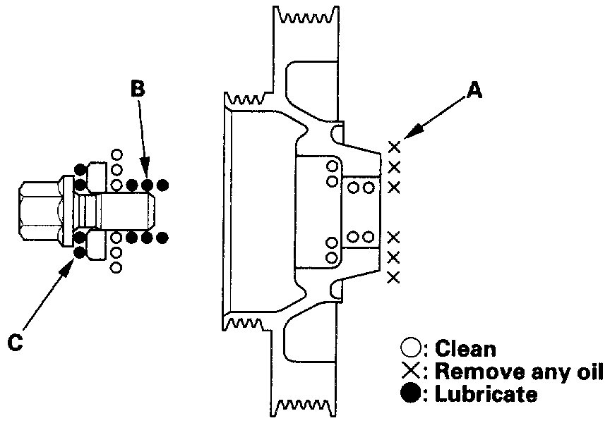

28. Clean the crankshaft pulley bolt and washer.
pic 20
29. Clean all oil off the inside face (A) of the crankshaft pulley, and apply lubricant to the pulley bolt (B) and washer (C).
pic 21

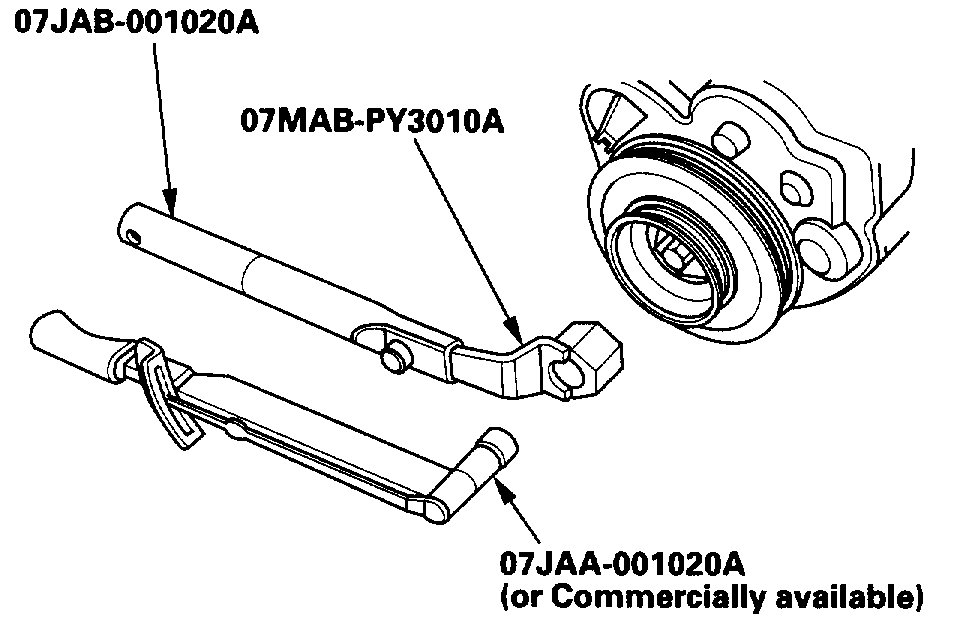

30. Install the crankshaft pulley, and tighten the bolt to 245 Nm (250 kgf.m, 181 ft. lbs.) using the special tools.

39. Install the upper bracket (A), then tighten the bolt and nuts in the numbered sequence shown.
40. Install the stop (B).

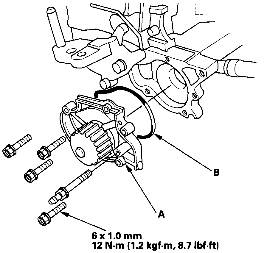

REPLACEMENT
1. Remove the timing belt.
2. Remove the camshaft pulley and the back cover.
3. Remove the water pump (A) by removing five bolts.
pic 26
4. Inspect, repair and clean the O-ring groove and the mating surface on the cylinder block.
5. Install the water pump, with a new O-ring (B), in the reverse order of removal.
6. Clean the spilled engine coolant.
