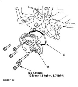

How difficult is it to change a water pump? Do you need experience in replacing that part to be able to accomplish the task. The water pump is $65 but a shop quoted me for $600 for time, parts & labor. Suggestions?

Get another quote
yes it require an expert to replace water pump
as you have to remove timing belt in order to replace the water pump
https://www.2carpros.com/forum/automotive_pictures/99387_Graphic1_252.jpg
