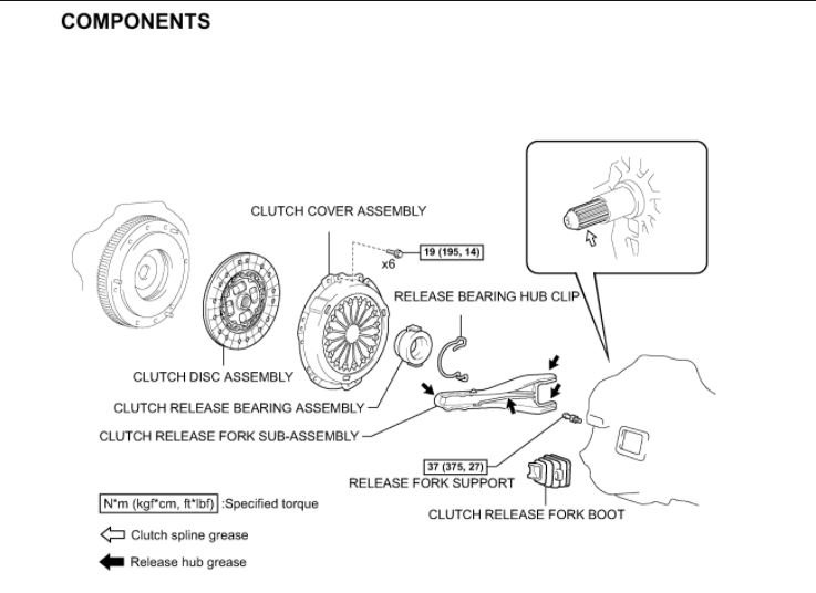

REMOVAL
1. REMOVE MANUAL TRANSAXLE ASSEMBLY
2. REMOVE CLUTCH RELEASE FORK SUB-ASSEMBLY
(a) Remove the clutch release fork with the clutch release bearing from the manual transaxle.
3. REMOVE CLUTCH RELEASE FORK BOOT
4. REMOVE CLUTCH RELEASE BEARING ASSEMBLY
(a) Remove the clutch release bearing from the clutch release fork.
5. REMOVE RELEASE BEARING HUB CLIP
6. REMOVE RELEASE FORK SUPPORT
(a) Remove the release fork support from the manual transaxle.

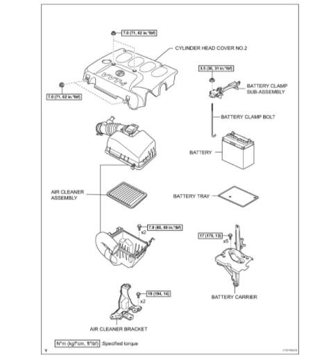

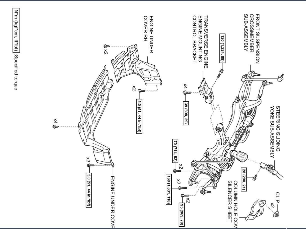

REMOVAL
1. DISCONNECT CABLE FROM NEGATIVE BATTERY TERMINAL

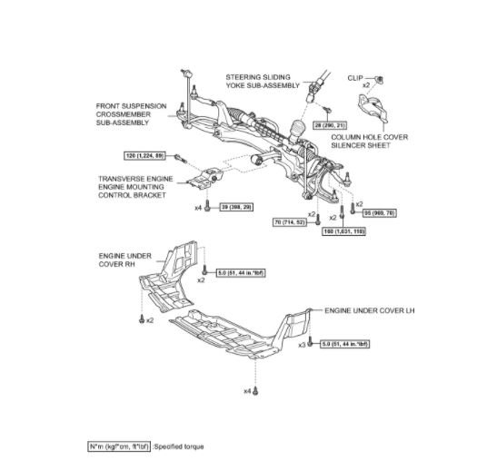

2. REMOVE COLUMN HOLE COVER SILENCER SHEET
3. REMOVE STEERING SLIDING YOKE SUB-ASSEMBLY
4. REMOVE FRONT WHEELS
5. REMOVE ENGINE UNDER COVER LH
6. REMOVE ENGINE UNDER COVER RH
7. DRAIN TRANSAXLE OIL
(a) Remove the filler plug and the gasket.
(b) Remove the drain plug and the gasket, and then drain the manual transaxle oil.
(c) Install a new gasket and the drain plug.
Torque: 39 N*m (400 kgf*cm, 29 ft.*lbf)

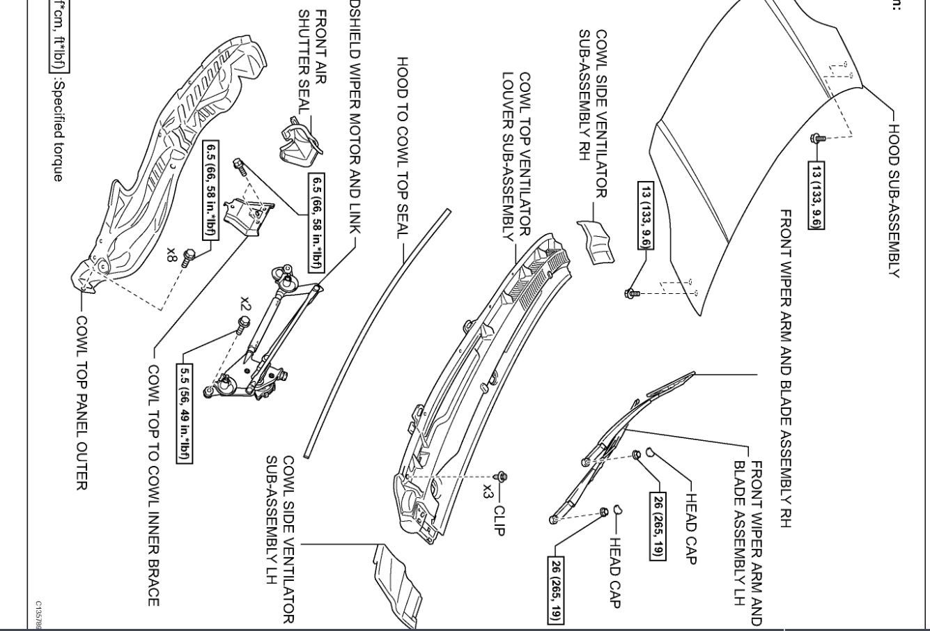

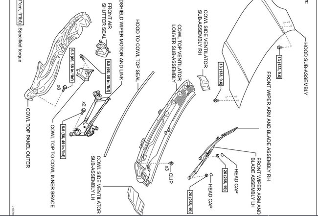

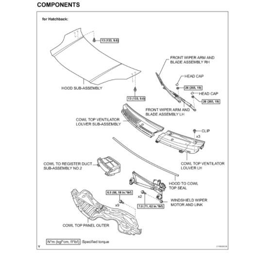

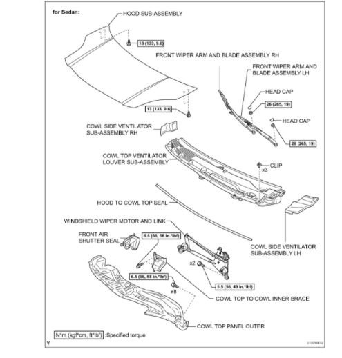

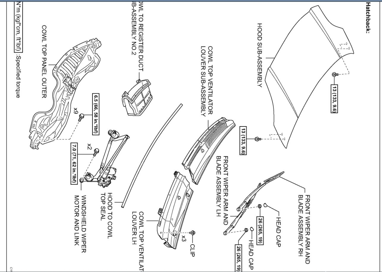

8. REMOVE HOOD SUB-ASSEMBLY
9. REMOVE FRONT WIPER ARM AND BLADE ASSEMBLY LH
10. REMOVE FRONT WIPER ARM AND BLADE ASSEMBLY RH
11. REMOVE HOOD TO COWL TOP SEAL
12. REMOVE COWL TOP VENTILATOR LOUVER SUB-ASSEMBLY (for Hatchback)
13. REMOVE COWL TOP VENTILATOR LOUVER LH (for Hatchback)
14. REMOVE WINDSHIELD WIPER MOTOR AND LINK (for Hatchback)
15. REMOVE COWL TO REGISTER DUCT SUB-ASSEMBLY NO.2 (for Hatchback)
16. REMOVE COWL TOP PANEL OUTER (for Hatchback)
17. REMOVE COWL SIDE VENTILATOR SUB-ASSEMBLY LH (for Sedan)
18. REMOVE COWL SIDE VENTILATOR SUB-ASSEMBLY RH (for Sedan)
19. REMOVE COWL TOP VENTILATOR LOUVER SUB-ASSEMBLY (for Sedan)
20. REMOVE WINDSHIELD WIPER MOTOR AND LINK (for Sedan)
21. REMOVE FRONT AIR SHUTTER SEAL (for Sedan)
22. REMOVE COWL TOP PANEL OUTER (for Sedan)

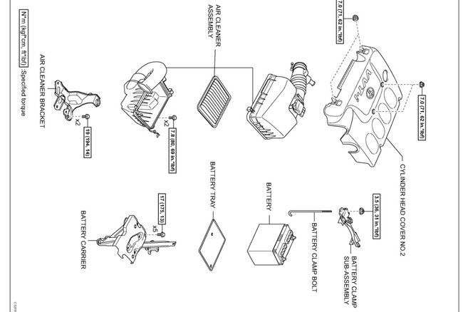

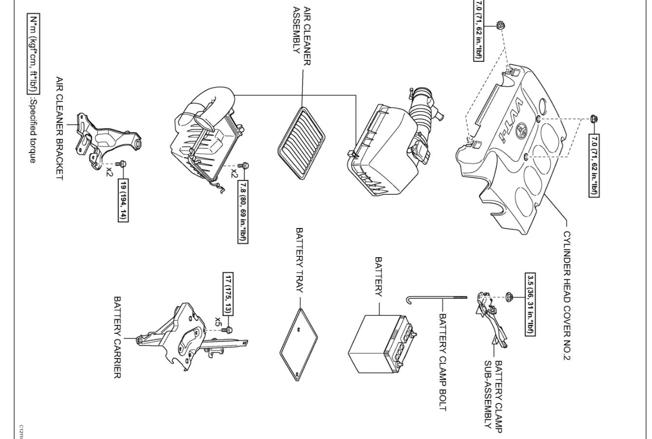

23. REMOVE CYLINDER HEAD COVER NO.2
24. REMOVE AIR CLEANER ASSEMBLY
25. REMOVE AIR CLEANER BRACKET
(a) Remove the 2 bolts and the air cleaner bracket.
26. REMOVE BATTERY CLAMP SUB-ASSEMBLY
27. REMOVE BATTERY
28. REMOVE BATTERY TRAY
29. REMOVE BATTERY CARRIER
(a) Remove the 5 bolts and the battery carrier.

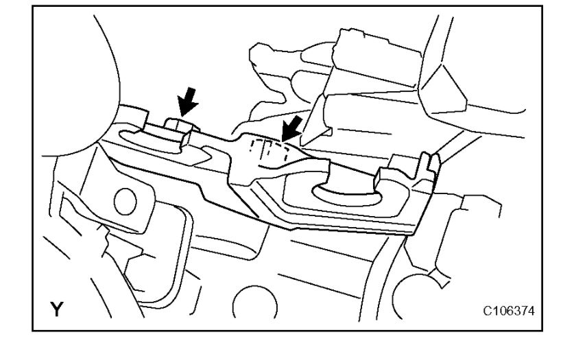

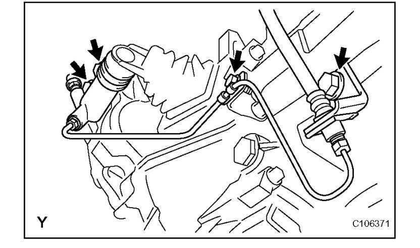

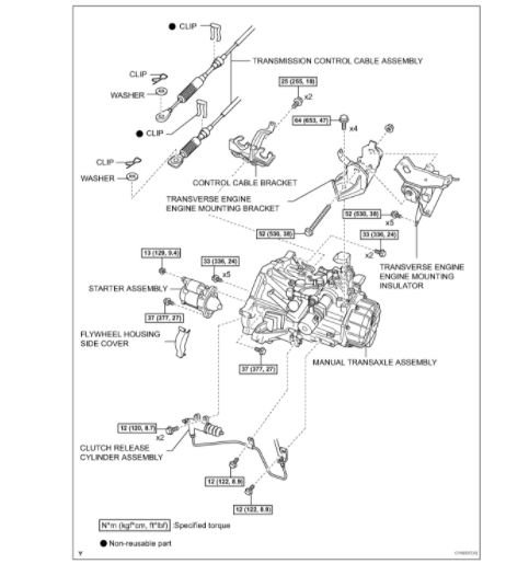

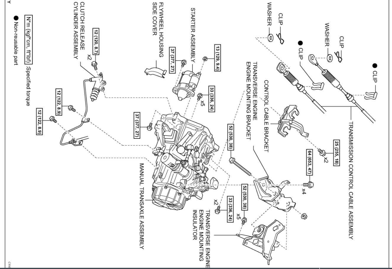

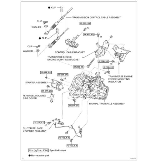

30. SEPARATE CLUTCH RELEASE CYLINDER ASSEMBLY
(a) Remove the 4 bolts, then separate the clutch release cylinder.
HINT: Suspend the clutch release cylinder with a piece of rope so as not to overload the clutch pipe.

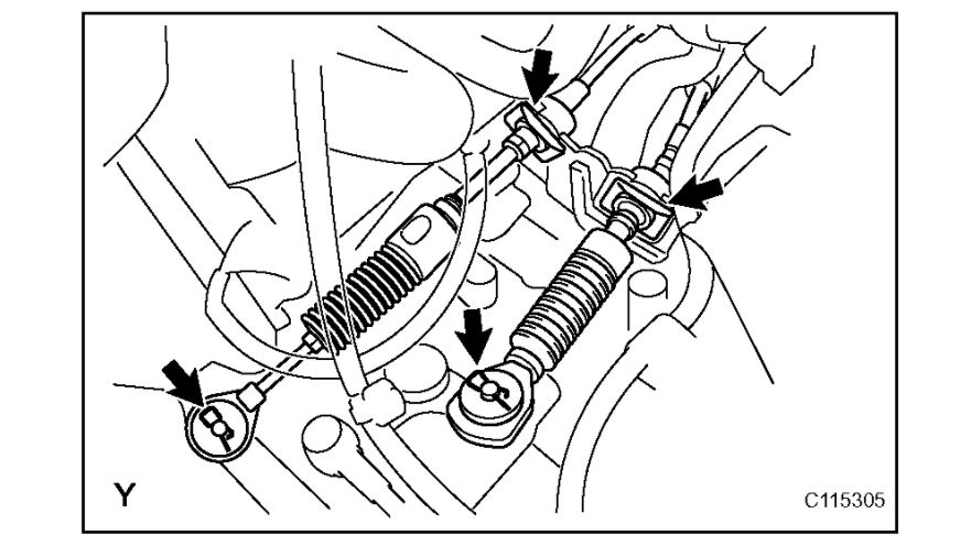

31. SEPARATE TRANSMISSION CONTROL CABLE ASSEMBLY
(a) Remove the 2 clips and the 2 washers, and disconnect the 2 cables from the transaxle.
(b) Remove the 2 clips and disconnect the 2 cables from the control cable bracket.

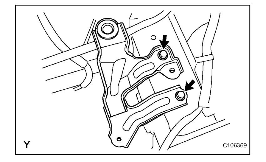

32. REMOVE CONTROL CABLE BRACKET
(a) Remove the 2 bolts and the control cable bracket.

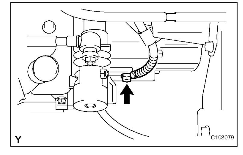

33. DISCONNECT WIRE HARNESS
(a) Remove the bolt, then disconnect the wire harness.
34. DISCONNECT CONNECTOR
(a) Disconnect the back-up light switch connector.
35. REMOVE STARTER ASSEMBLY

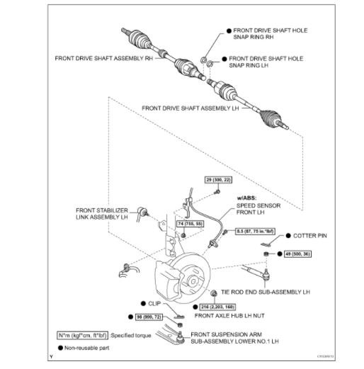

36. REMOVE FRONT AXLE HUB LH NUT
37. REMOVE FRONT AXLE HUB RH NUT
HINT: The removal procedure for the RH side is the same as that for the LH side.
38. SEPARATE SPEED SENSOR FRONT LH (w/ ABS)
39. SEPARATE SPEED SENSOR FRONT RH (w/ ABS)
HINT: The separation procedure for the RH side is the same as that for the LH side.

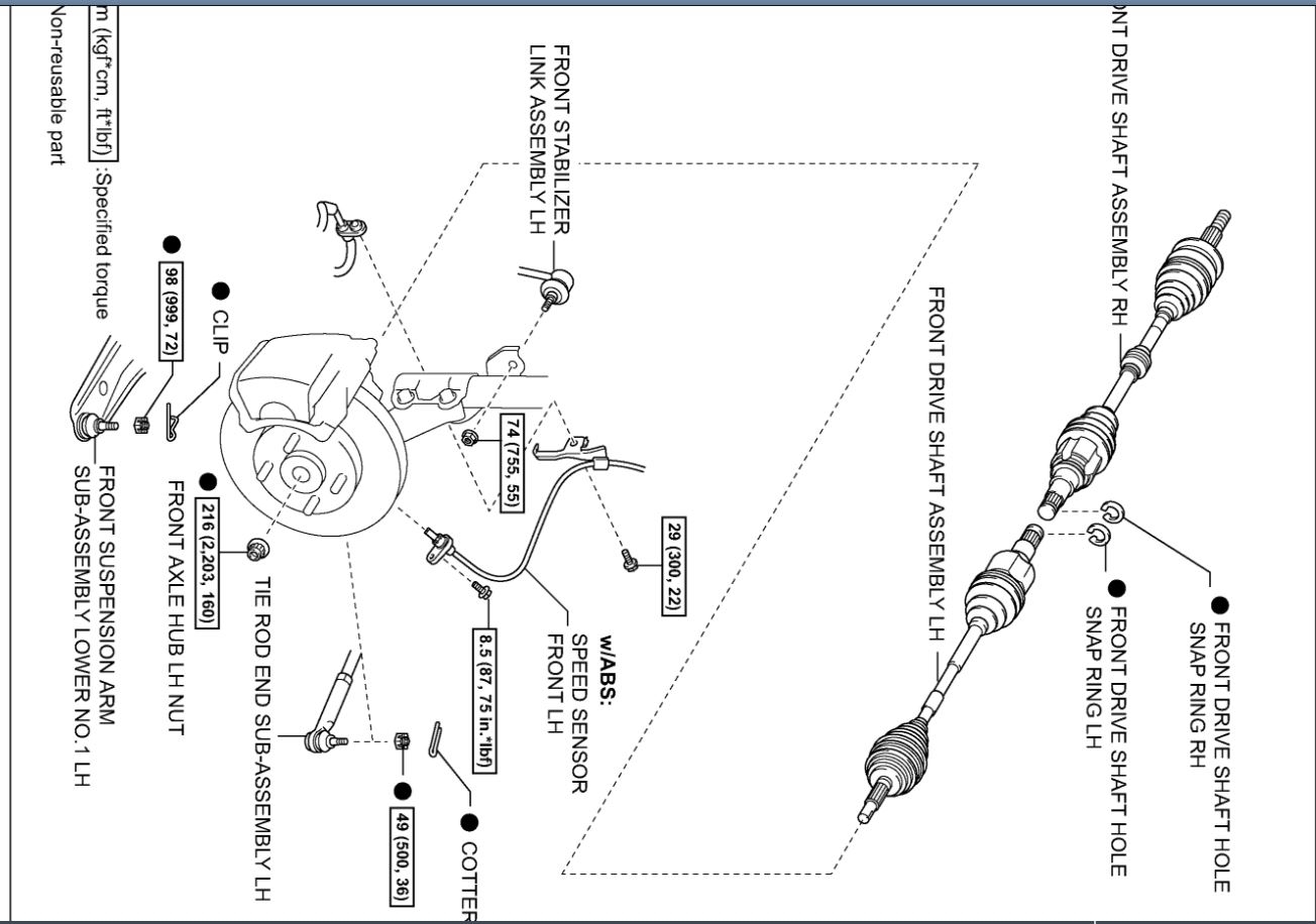

40. SEPARATE FRONT SUSPENSION ARM SUB-ASSEMBLY LOWER NO.1 LH
41. SEPARATE FRONT SUSPENSION ARM SUB-ASSEMBLY LOWER NO.1 RH
42. SEPARATE TIE ROD END SUB-ASSEMBLY LH
43. SEPARATE TIE ROD END SUB-ASSEMBLY RH
44. SEPARATE FRONT STABILIZER LINK ASSEMBLY LH
45. SEPARATE FRONT STABILIZER LINK ASSEMBLY RH
46. SEPARATE FRONT AXLE ASSEMBLY LH
47. SEPARATE FRONT AXLE ASSEMBLY RH
48. REMOVE FRONT DRIVE SHAFT ASSEMBLY LH
49. REMOVE FRONT DRIVE SHAFT ASSEMBLY RH

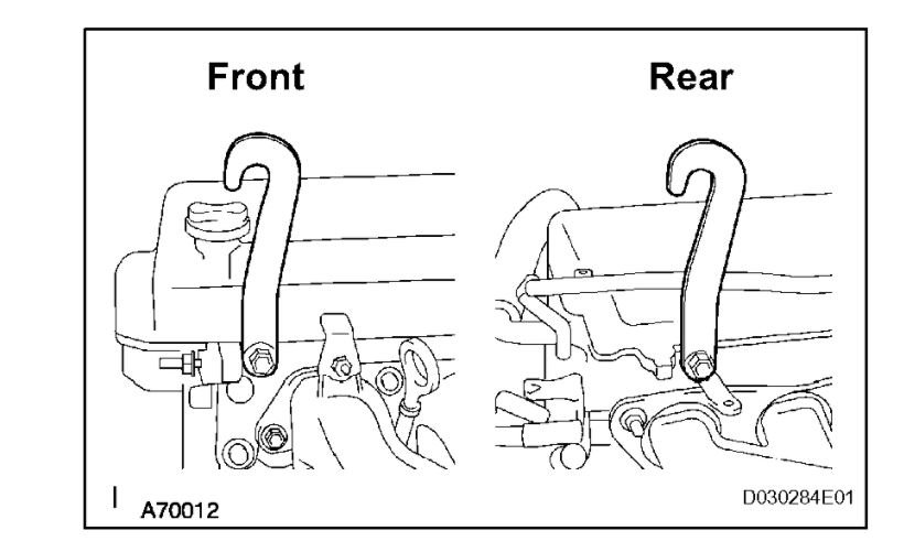

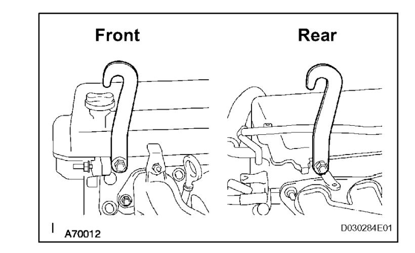

50. SUSPEND ENGINE ASSEMBLY
(a) Install the 2 hangers in the correct direction.
(b) Attach the engine chain hoist to the hangers.
CAUTION: Do not attempt to hang the engine by hooking the chain to any other part.
Parts No.:
Engine Hanger: 12281-21010
Bolt: 91642-81025
Torque: 40 N*m (408 kgf*cm, 29 ft.*lbf)

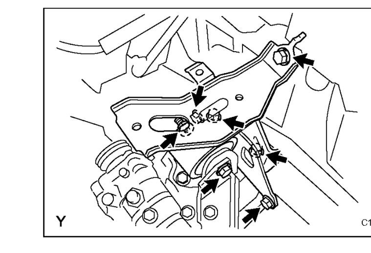

51. REMOVE FRONT SUSPENSION CROSSMEMBER SUB-ASSEMBLY

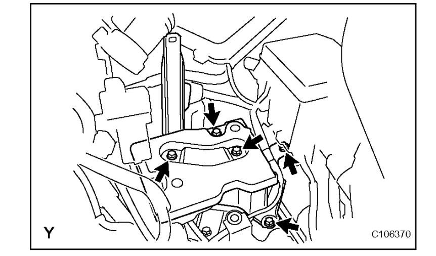

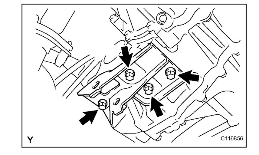

52. REMOVE TRANSVERSE ENGINE ENGINE MOUNTING CONTROL BRACKET
(a) Remove the 4 bolts and the engine mounting control bracket.

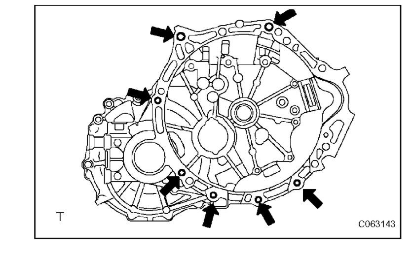

53. SUPPORT MANUAL TRANSAXLE ASSEMBLY

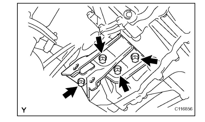

54. REMOVE TRANSVERSE ENGINE ENGINE MOUNTING INSULATOR
(a) Remove the bolt and nut, then separate the engine mounting insulator LH.
(b) Remove the 5 bolts and the engine mounting insulator LH.

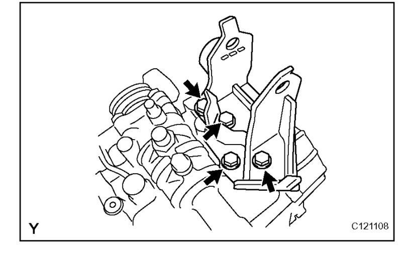

55. REMOVE TRANSVERSE ENGINE ENGINE MOUNTING BRACKET
(a) Remove the 4 bolts and the engine mounting bracket LH.
56. REMOVE MANUAL TRANSAXLE ASSEMBLY
(a) Remove the 7 bolts and the manual transaxle.
Mar 23, 2021 at 11:56 AM
05ACURATL
  • 37 POSTS
Hi Roy,

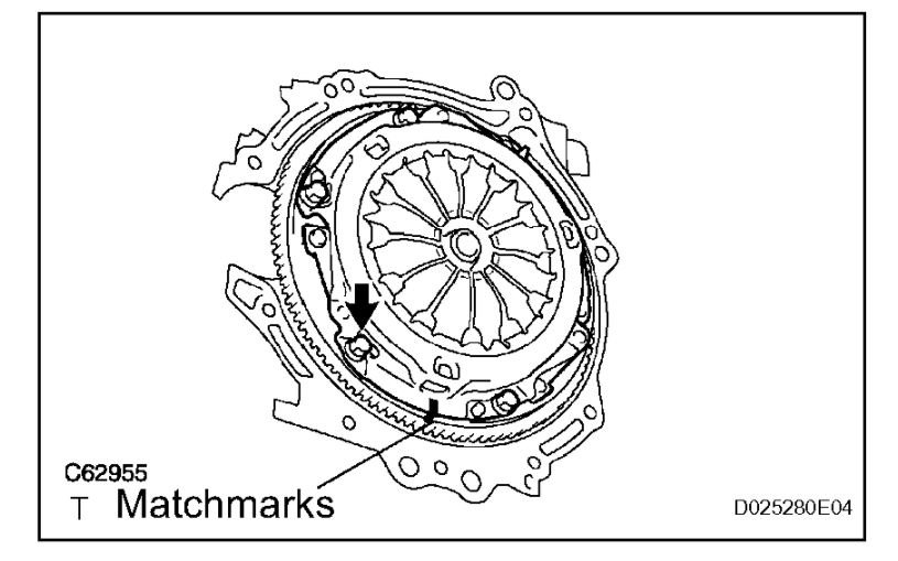

Thanks. The first 7 pictures that have torque specs are not readable. I tried zooming in but it makes everything pixelated. Could you please reupload higher resolution pictures? Also, do you have the instructions for replacing the pressure plate, flywheel, main seal, and rear seal? thanks
Apr 5, 2021 at 1:44 AM
Okay, I attached larger pictures for you. Use a laptop or desktop to view. It will not be that visible on a phone.
As far as the pressure plate, the instructions are already posted in the previous answers.
The rear main seal requires the removal of the flywheel to access the seal. You can remove and install the seal once the flywheel is removed.
Install the flywheel when the seal is replaced and torque to 80 pounds on the bolts.

thanks Roy. Is there a specific sequence for removing/installing of the flywheel bolts?
Apr 10, 2021 at 8:26 PM
No, just install all together and tighten each one to about 25 pounds. Then do the final torque. I just go around the circle.
