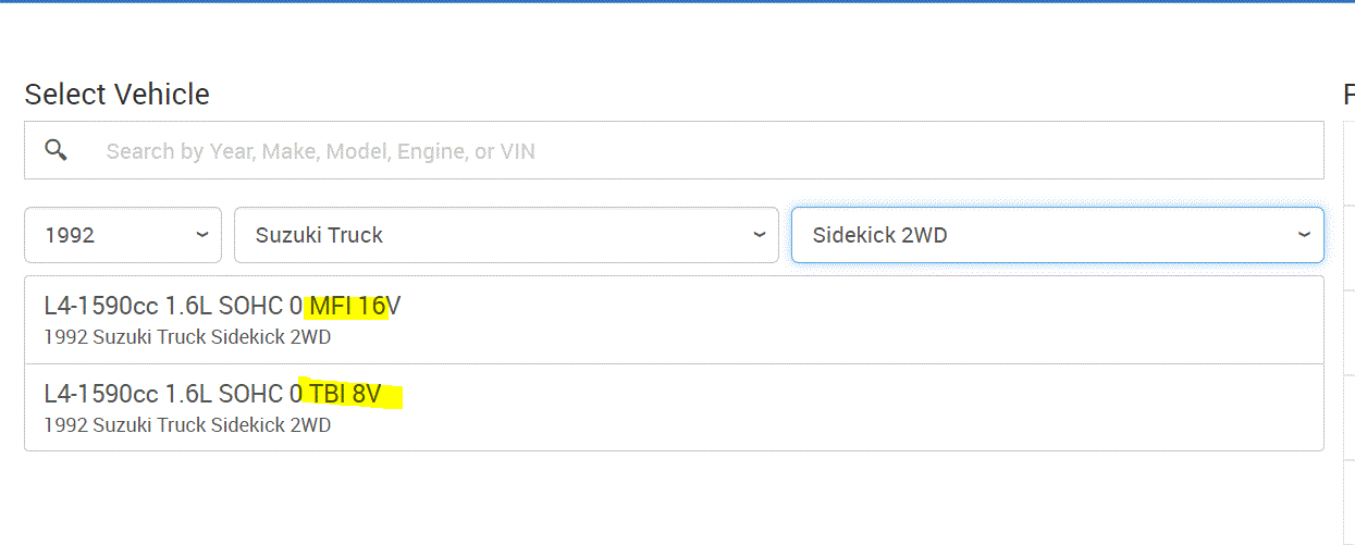

It has carburetor. Branded also as Suzuki Sidekick, but has G16A (non-fuel injected) engine.
Jul 25, 2021 at 9:31 PM
  • 110,194 POSTS
When I look up a 2002 Sidekick, I get two options, TBI or MFI. See pic 1 below I even went back to a 1990 and it shows TBI.
