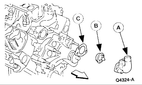

Thermostats are always installed with the bulb end facing the hot water side. On the 302 engine it should be inside the intake with the pointed end facing the radiator. If it is installed backwards but seems to work then you have an odd issue.

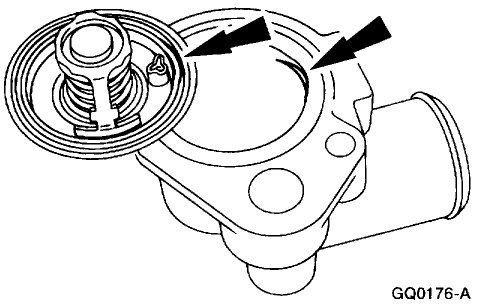

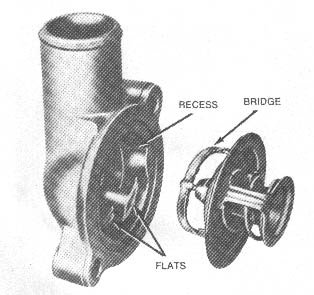

There is a special note. Caution: It is critical that the water thermostat be correctly aligned, to provide coolant flow to heater.
To prevent incorrect installation of the water thermostat, the thermostat housing contains a locking recess into which the water thermostat is turned and locked. Install the water thermostat with the bridge section in the thermostat housing. Turn the water thermostat clockwise to lock it in position on the flats cast into the thermostat housing.

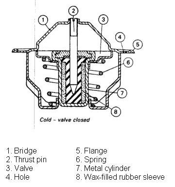

Yep, and the bridge section is the end opposite the wax pellet and return spring. With the 5.0 in question they have very weak heater core flow and if the spring seat support is in the wrong place it blocks water flow to the core enough that you will get "no heat" complaints.

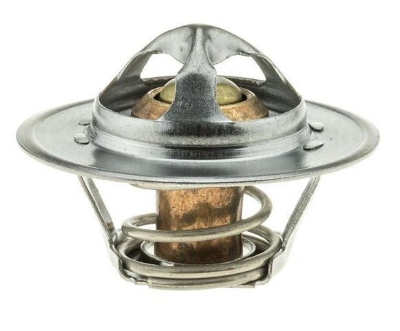

The odd reason is this one goes on opposite no odd issue. First thermostat I bought had a little brass bobble thing I clipped off to make it fit snug only after I saw diagram of backward installation. They have corrected the problem new thermostat has no brass deal and it fits snug. I saw diagram of it going in backwards.

I do not see how it can even work if it is installed the wrong direction. That is what the warning note is about. The wax pellet/spring has to face the engine. If it does not the hot water which comes up to the thermostat cannot actuate it because it will be in cold water on the radiator side.
