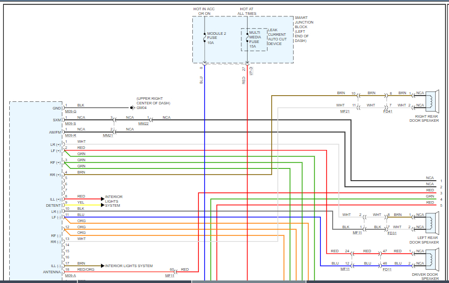

What is the simplest way to install a line-out converter pack sni-35 to car listed above base model?

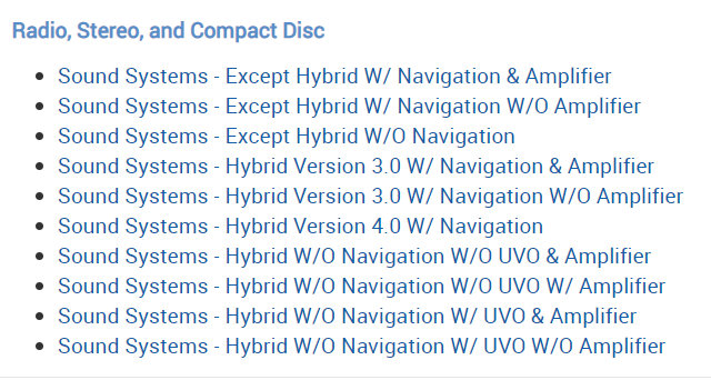

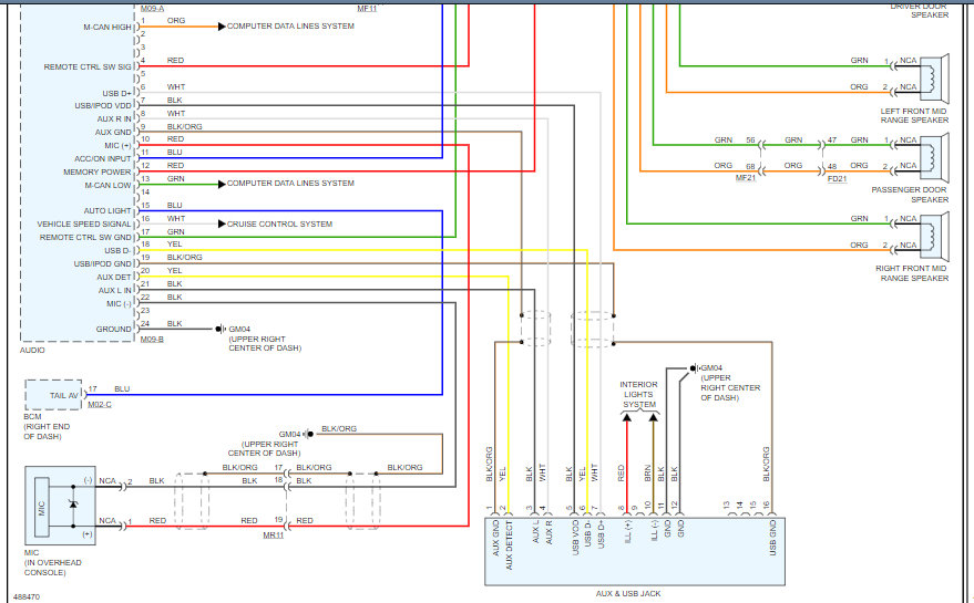

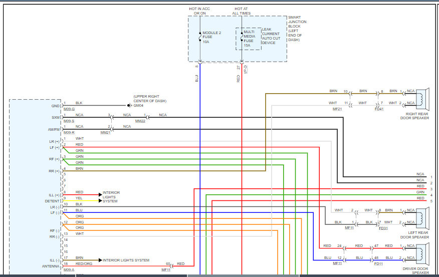

Hello, I'm Danny.
Did you sni-35 come with a wire color diagram? I would be happy to help match to your existing audio system. I've attached pictures below of the audio system available for your car and an audio wiring diagram. I based the diagram on a non-hybrid, non-navigation system. Get back to us and we'll go from there. Hope this helps and thanks for using 2CarPros.
