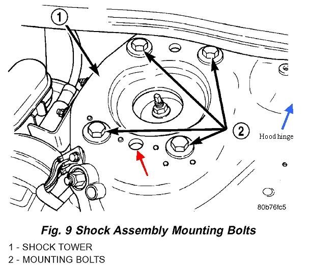

On all the applications I’ve seen the cam bolt is installed in the upper bolt hole of the lower strut mount. However my strut has only one lower mount bolt location. My question is, if using the cam bolt in that location will I still get the desired effect? I have only just ordered the parts so maybe I’m missing something. Thoughts?

You have the wrong strut design for a cam bolt. Those are for the design GM and Chrysler used throughout the 1980's and 1990's that had two lower mounting bolts. GMs needed to have one mounting hole elongated, then an aftermarket bolt could be installed. They didn't make their cars alignable from the factory. Chrysler's mostly came with the cam bolt already in place. A very few models, such as the Dynasty, needed to have one mounting bolt replaced with the cam bolt, but the hole in the strut was already elongated.
Camber is adjusted on your model by loosening the four upper strut mount bolts next to the hood hinge, then you slide that mount left or right to make the adjustment. Often there will be a white plastic pin in the center, front of the mount, that has to be removed the first time camber is changed. Those have a rounded top that causes a flat blade screwdriver tip to slide off. Instead, just use a small screwdriver and punch it into that plug, then use that to pop it out. That plug can be discarded. My nifty red arrow in the drawing is pointing to where that plug is recessed inside the hole.

Thank you Caradiodoc, very helpful. Still, I’m a little confused why “carparts.com” is sending me a camber bolt for my make and model.

There's another Stratus model listed, a coupe, that I'm not familiar with. If that is like the two Sebring models, one is built by Mitsubishi and is totally different than the more common domestic model. They do show a special bolt for the coupe, but in ten years at the dealership as a suspension and alignment specialist, I never installed one of those.

Yah, I’m sure there was an inaccuracy in the website make/model fitting information. Thanks again Caradiodoc.
