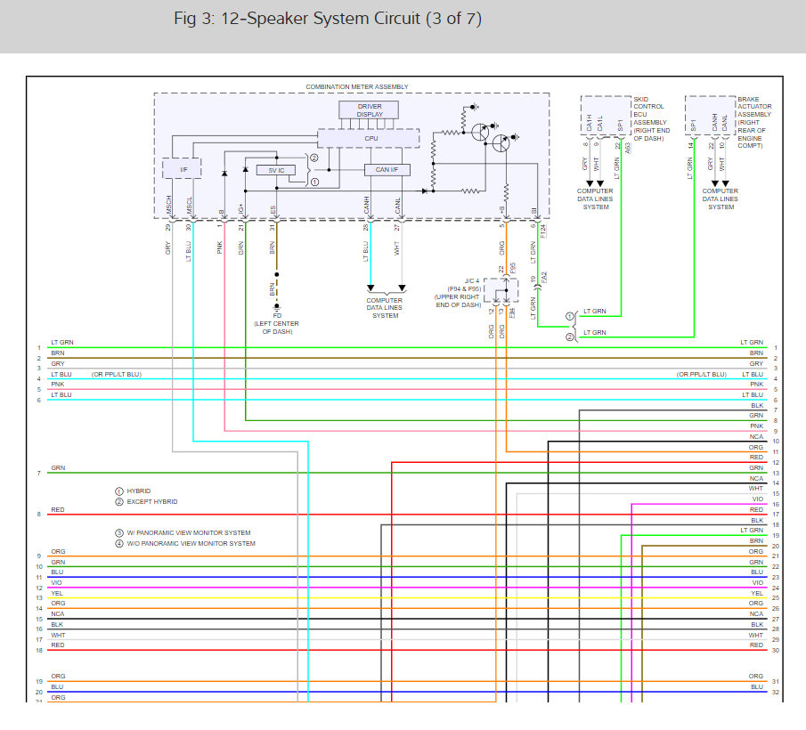

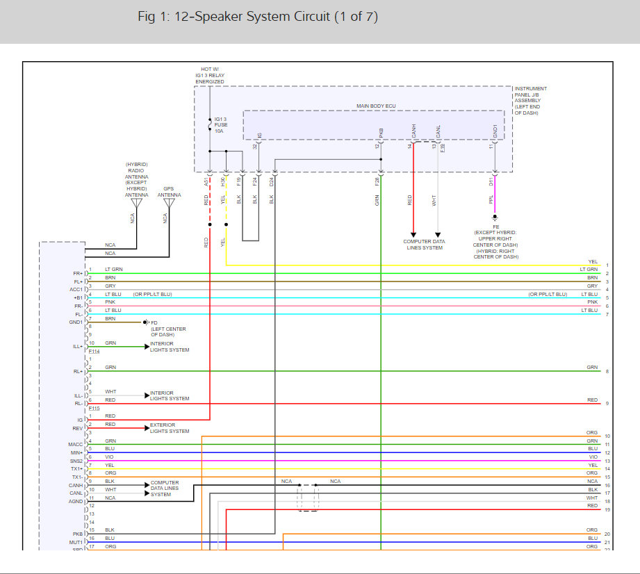

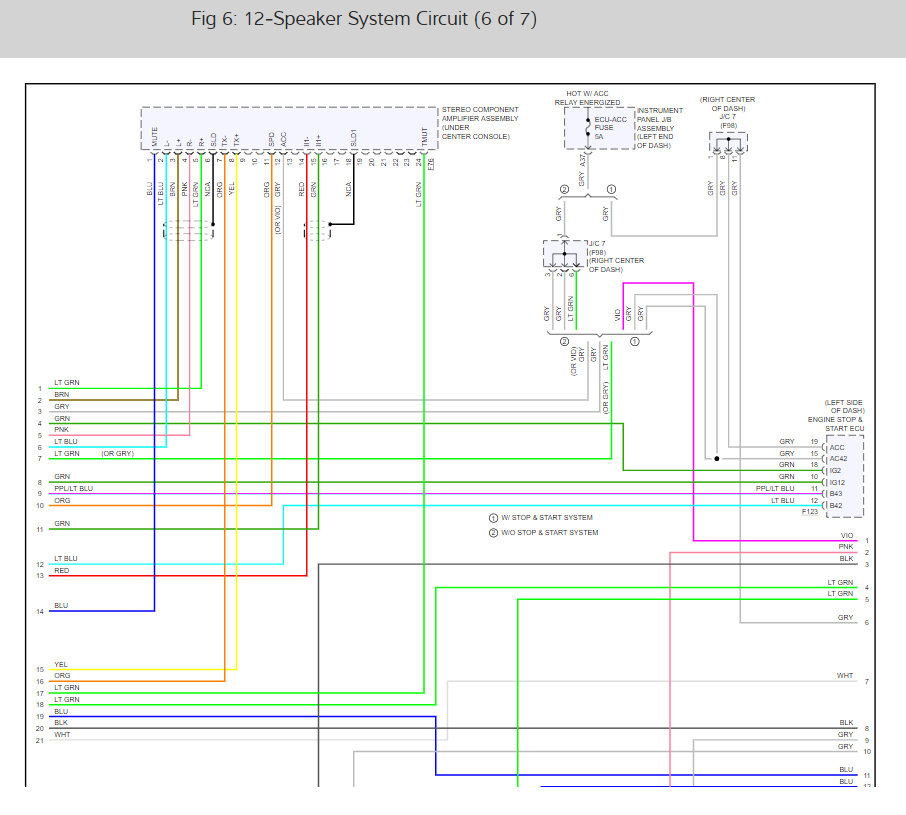

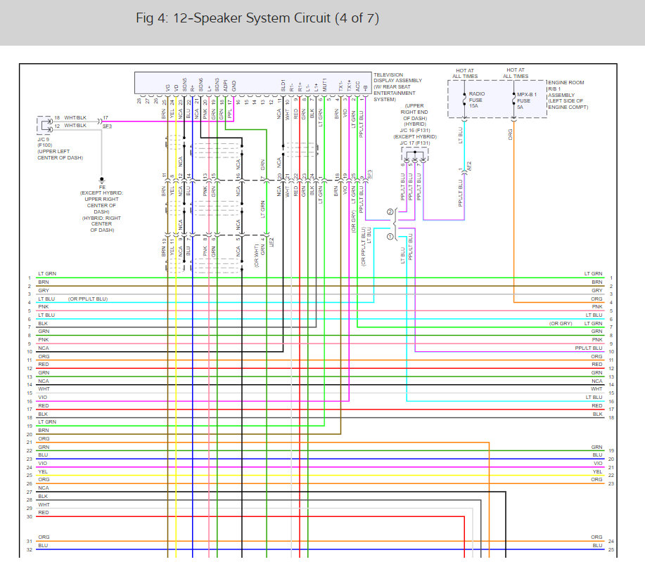

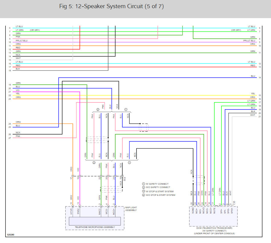

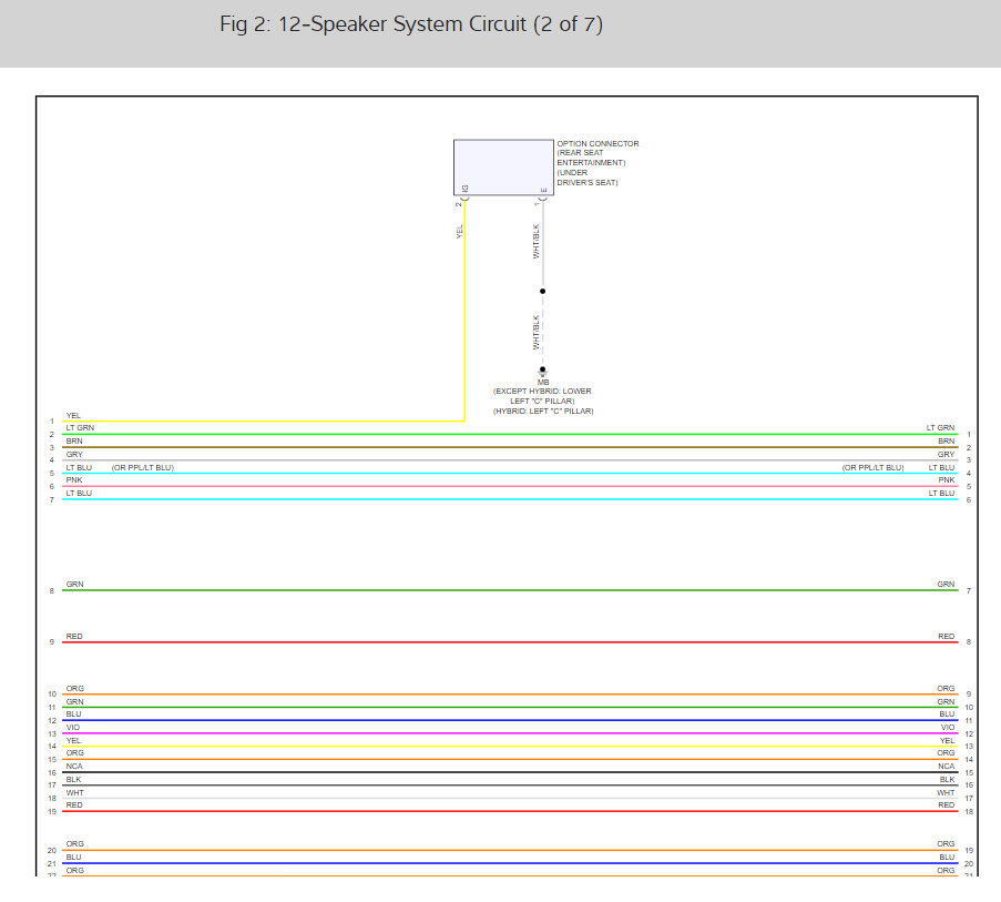

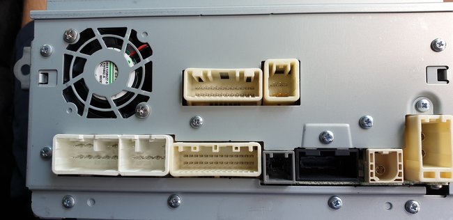

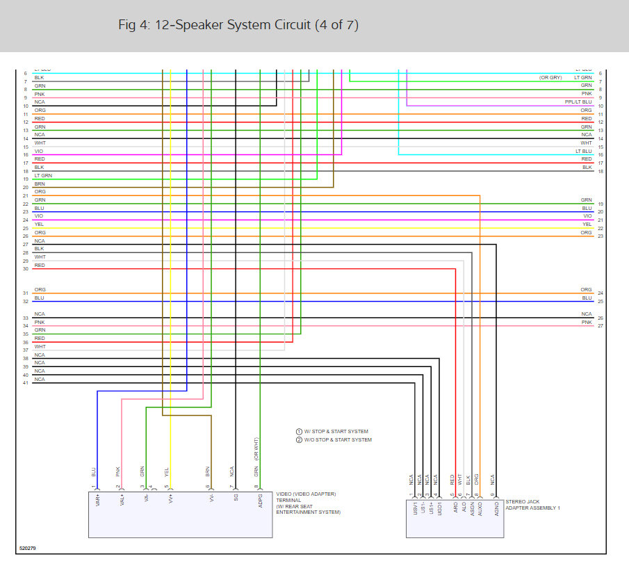

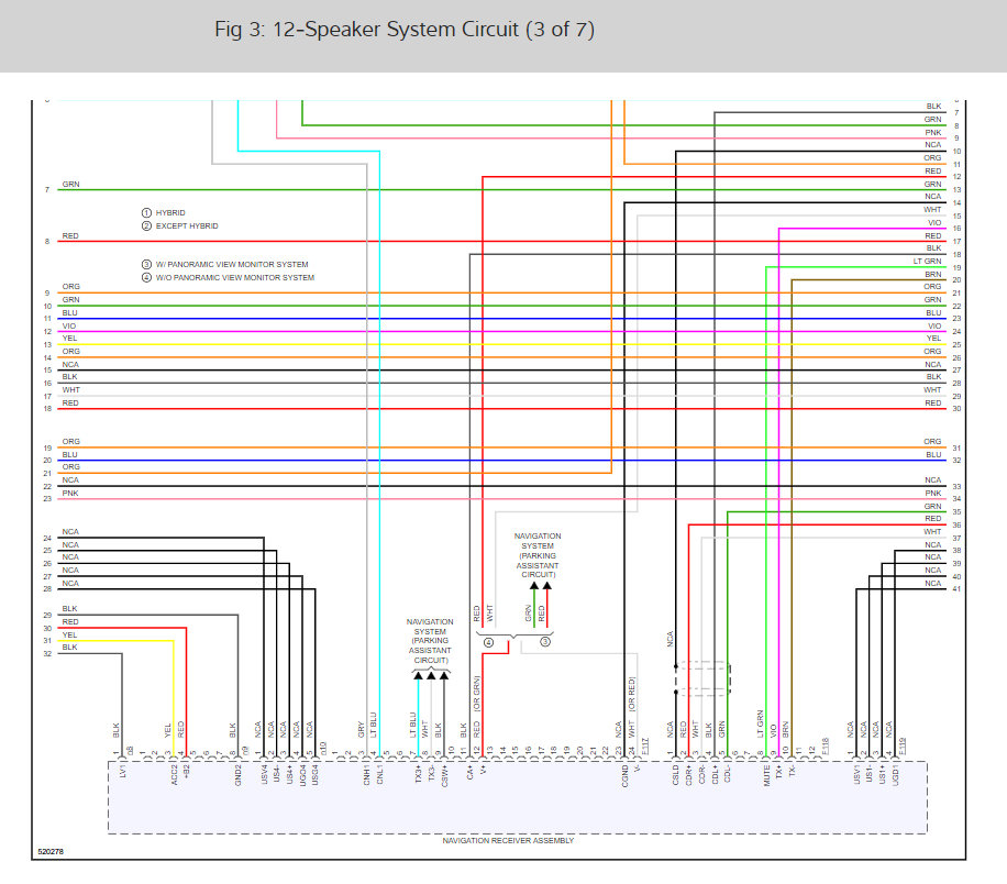

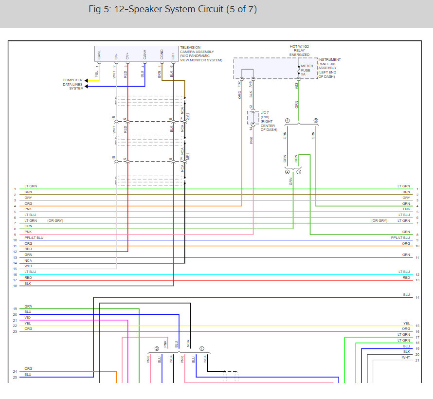

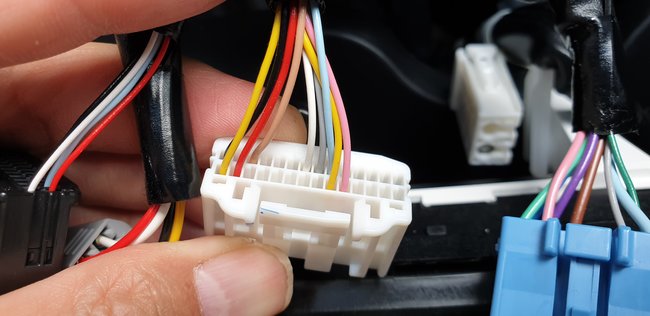

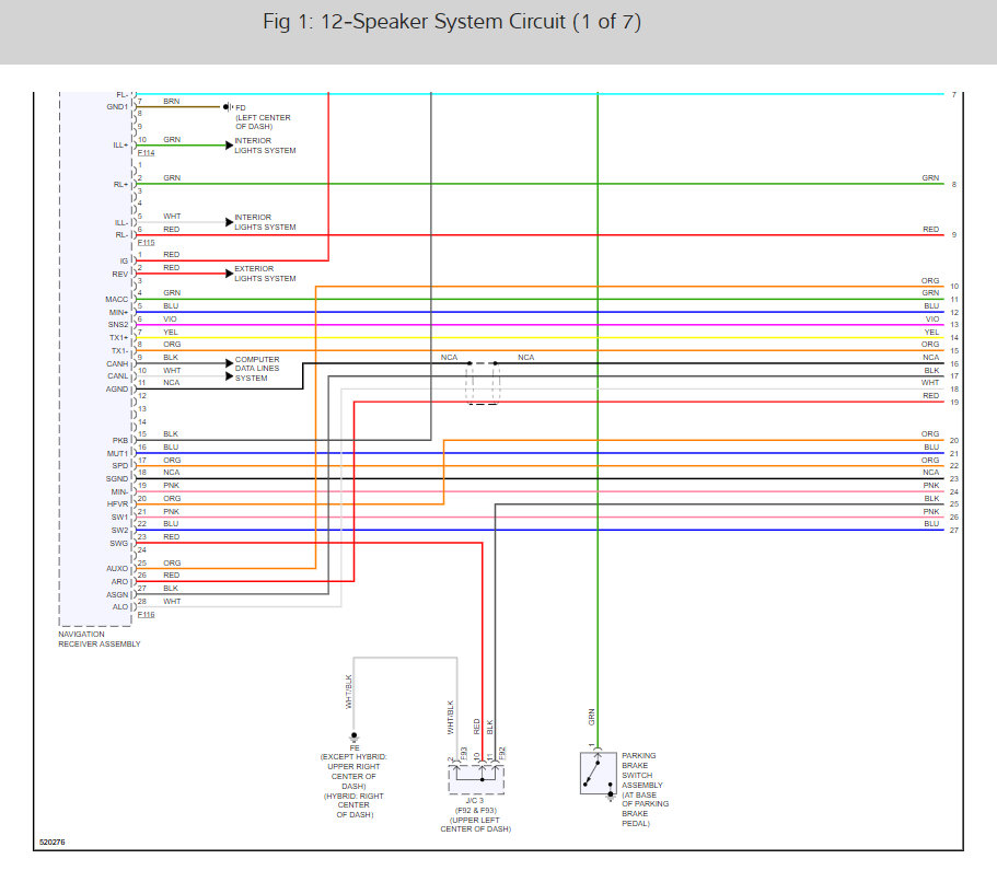

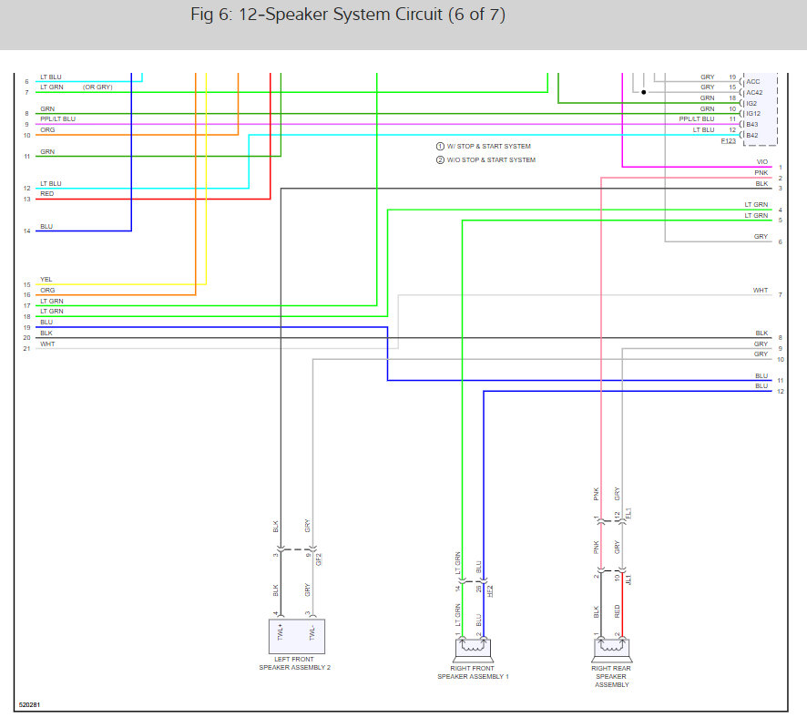

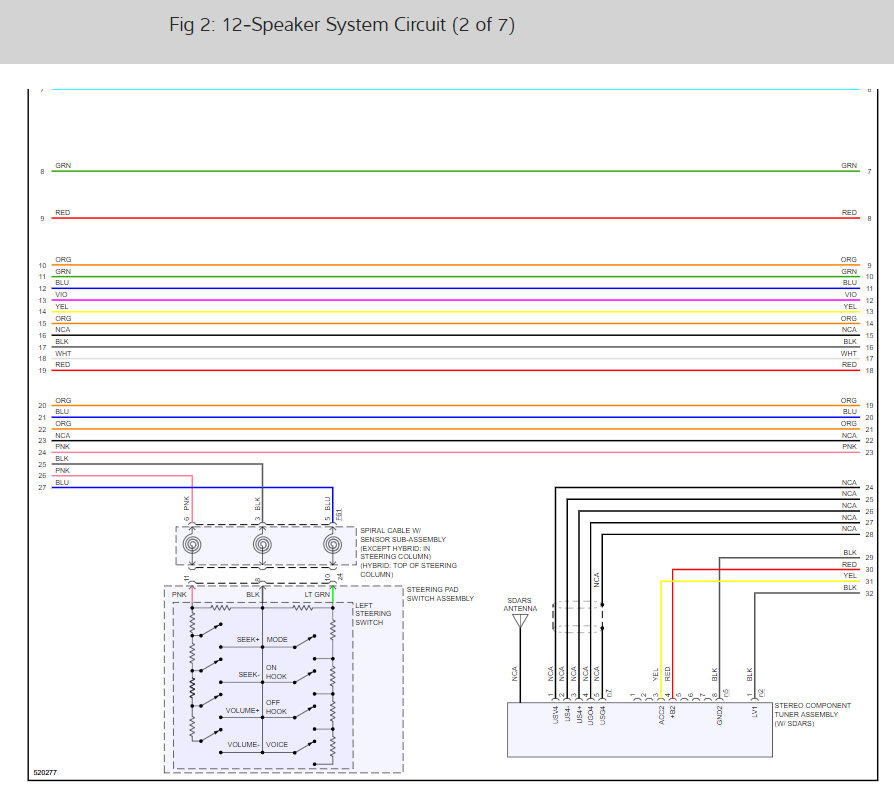

I am installing an Alpine iLX W650 into my car but have stumbled into some difficulties with understanding the wiring harness, especially the 28 pin and the 24 pin ones.
Would you happen to have a pinout diagram for this?
Much appreciated Sir.

Here are the radio and speaker wiring diagrams for the 7 speaker system (below) along with a guide to check the wiring:
