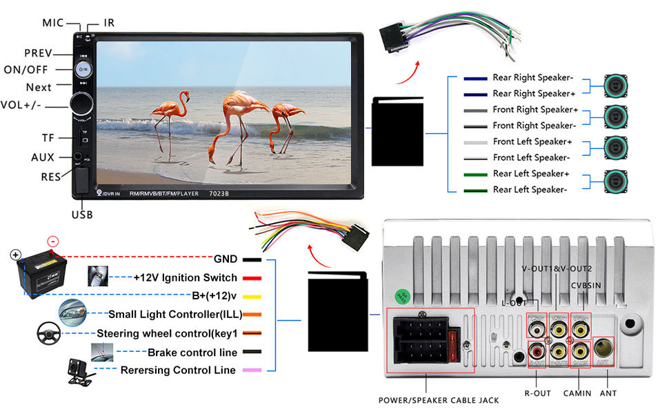

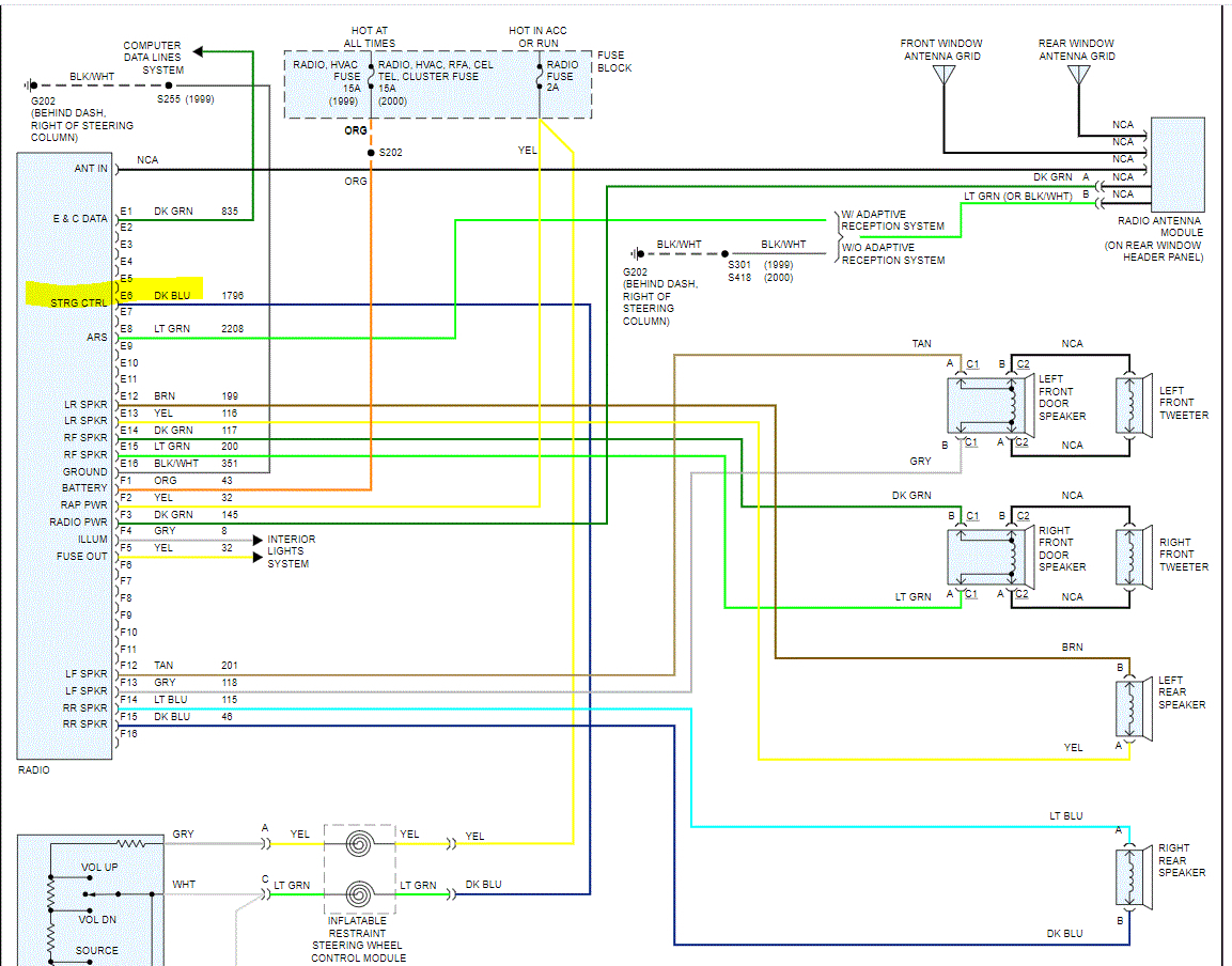

Which wire in the radio harness controls the steering wheel controls? I have wire for it in my aftermarket radio but cant locate it in my car
Aug 18, 2021 at 5:31 AM
FLEXINGTON RUGER
This is the radio I am installing.
Aug 18, 2021 at 5:33 AM

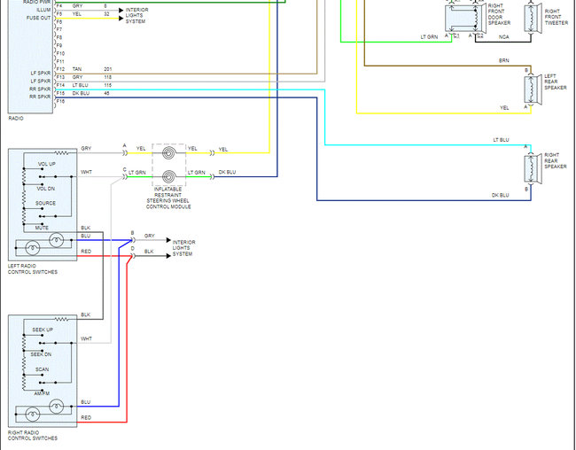

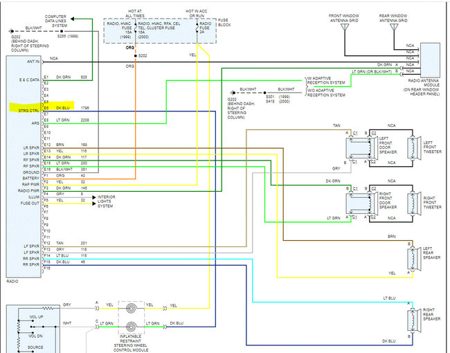

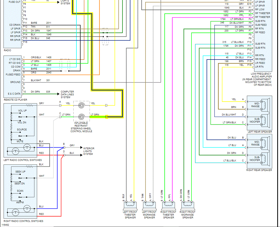

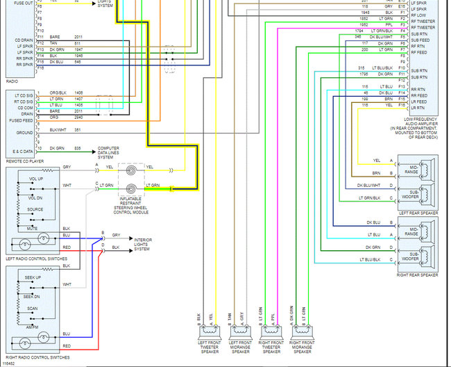

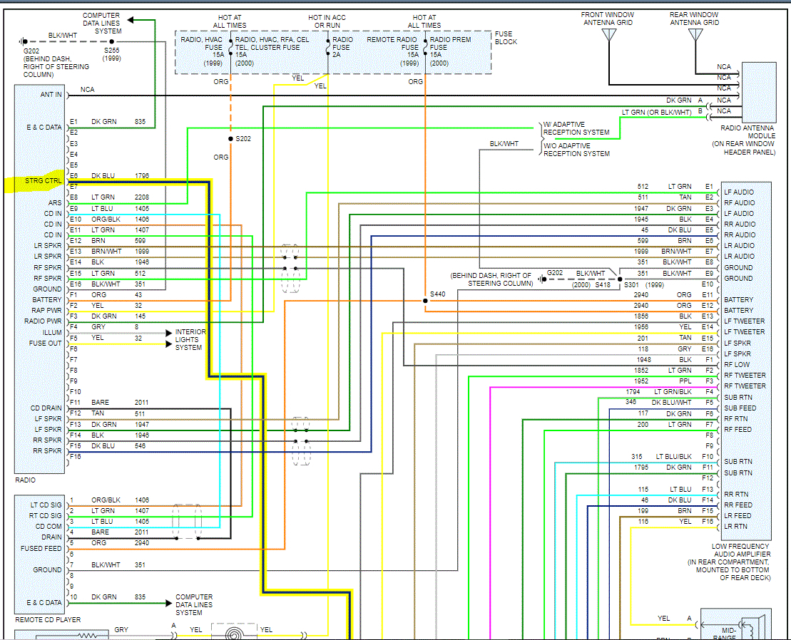

I attached the wiring schematics below for the two radio options the vehicle came with. One had a power amp and the other didn't. Note that each system was one page long. I had to cut each in half to make them readable for you. I did overlap each so you can follow from one to the next.
The first two pics below are for the OEM system that had the amp. The last two are for the one that didn't.
I added both so you have them in the event you need to identify other wires. Also, from what I'm seeing, regardless of which system you have, the wire should be dark blue.
