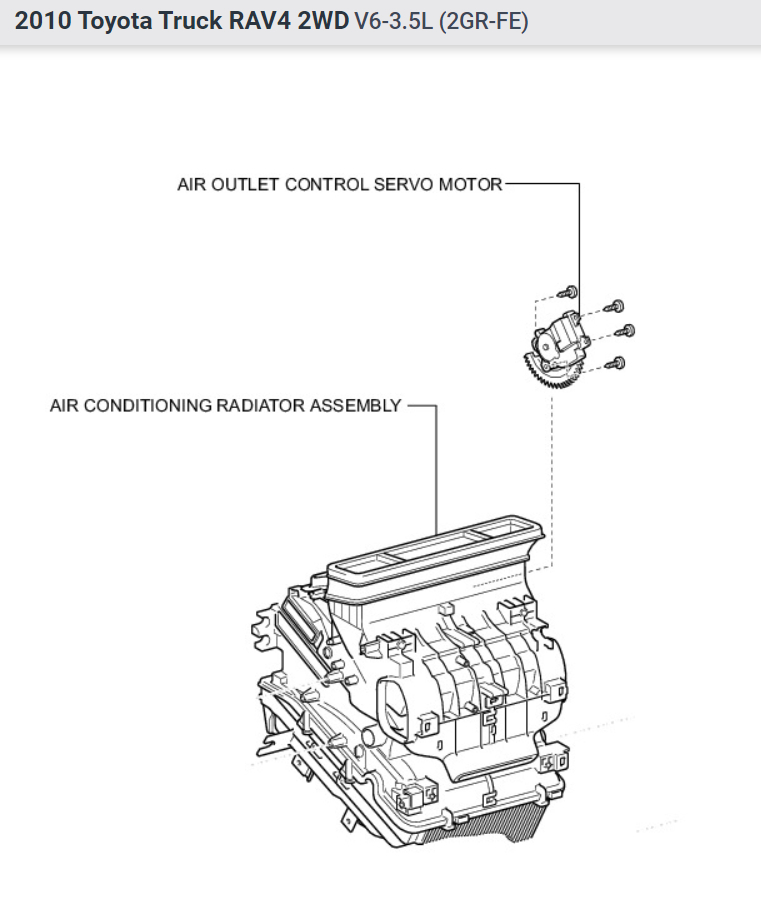

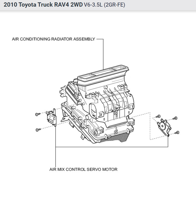

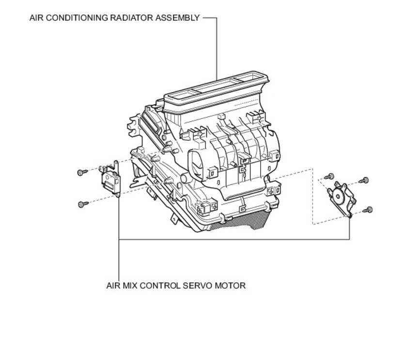

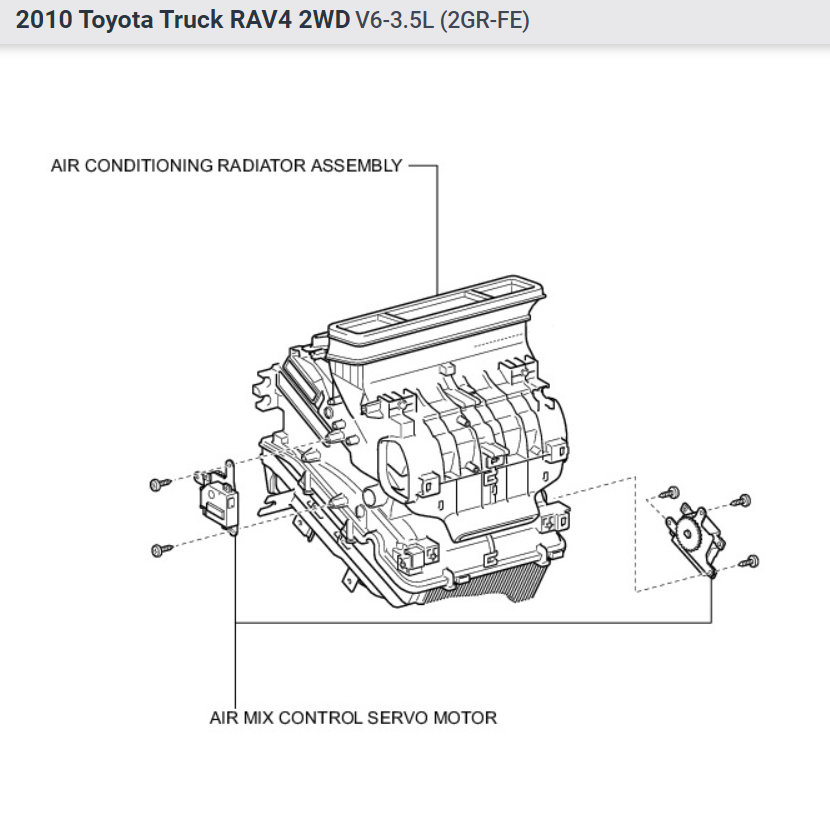

I have the actuator out. my question is, do I need to line the gears up when I install the new part? And if I do need to how is it done? Okay, I have the actuator in and it s working. I compared the 2 gears and saw where they matched up, but I m still not getting hot air out of the passenger side air vents! What else could it be? I did check with the dealership and they told me there was only one actuator in a 2010 Toyota Venza. I get lots of air out the vents just not hot. thank you, Nancy B
Jan 30, 2021 at 9:03 AM
  • 54,840 POSTS

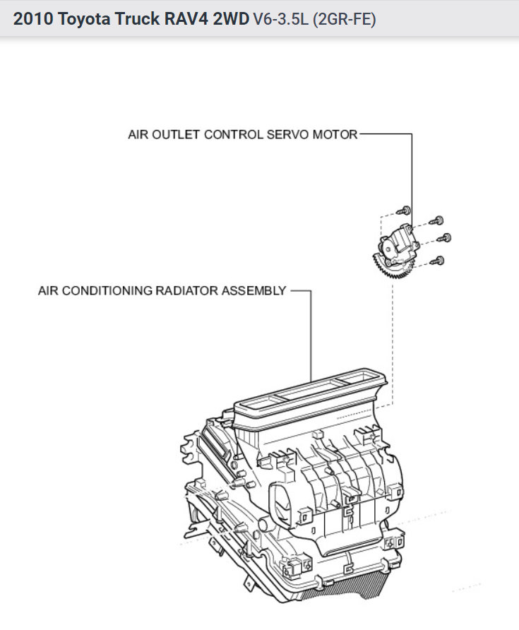

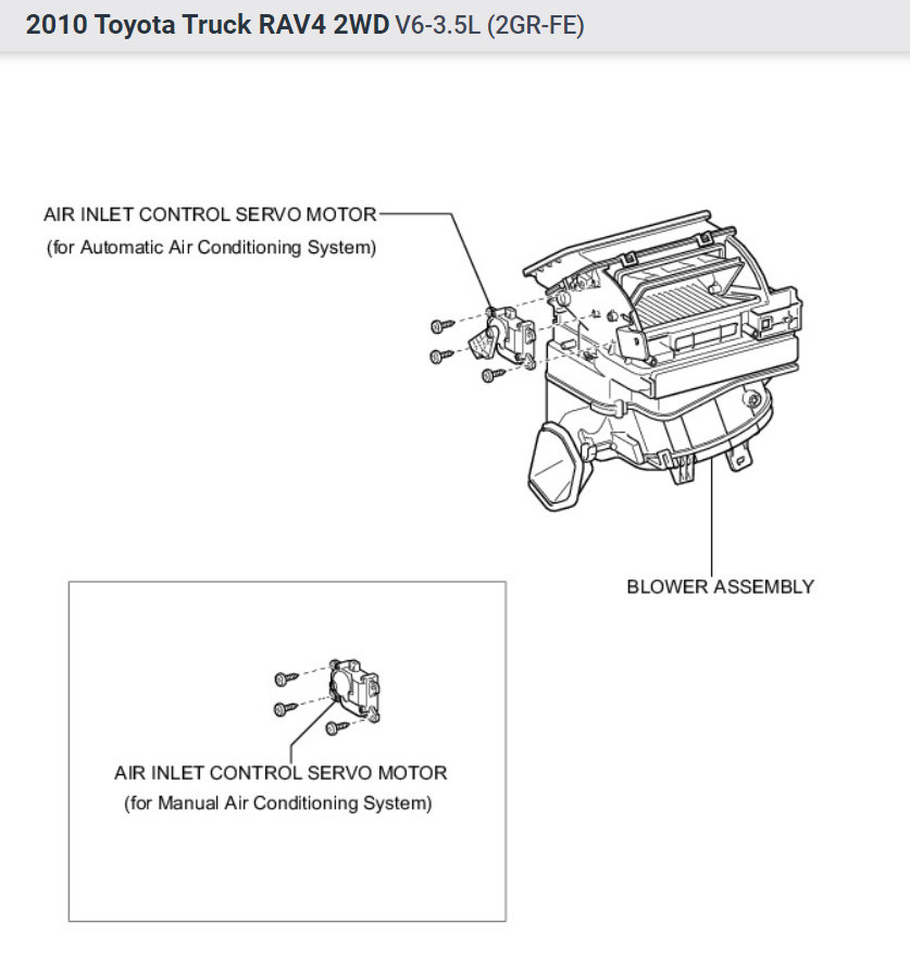

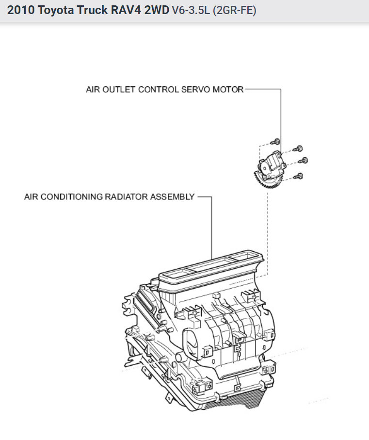

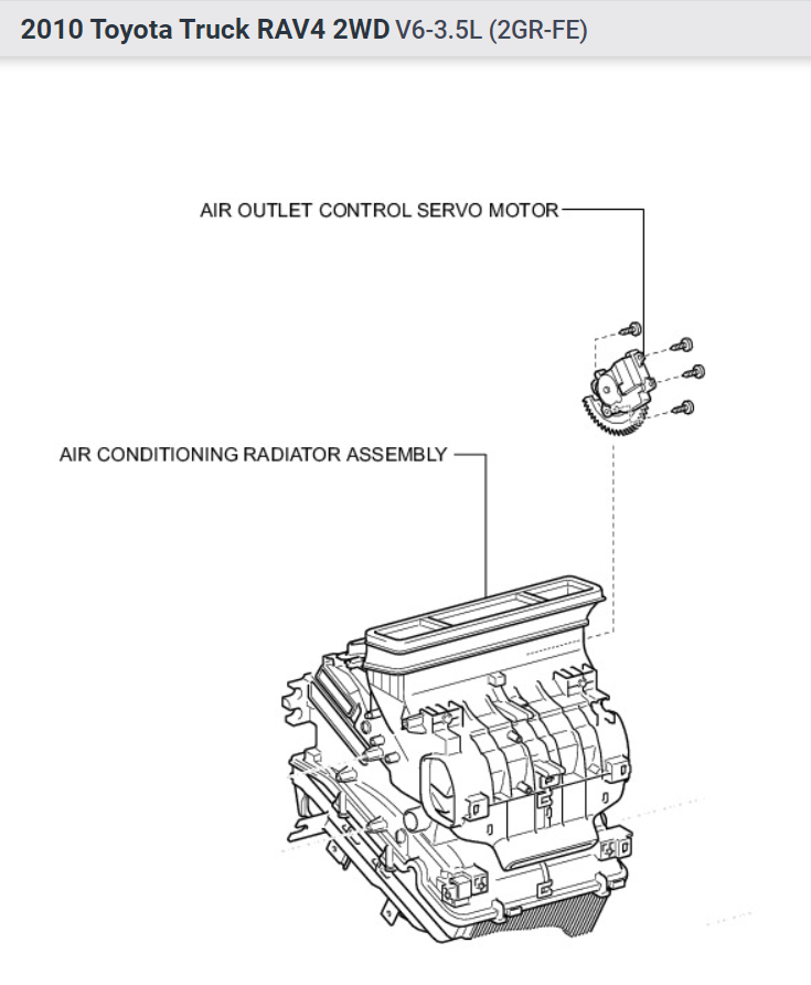

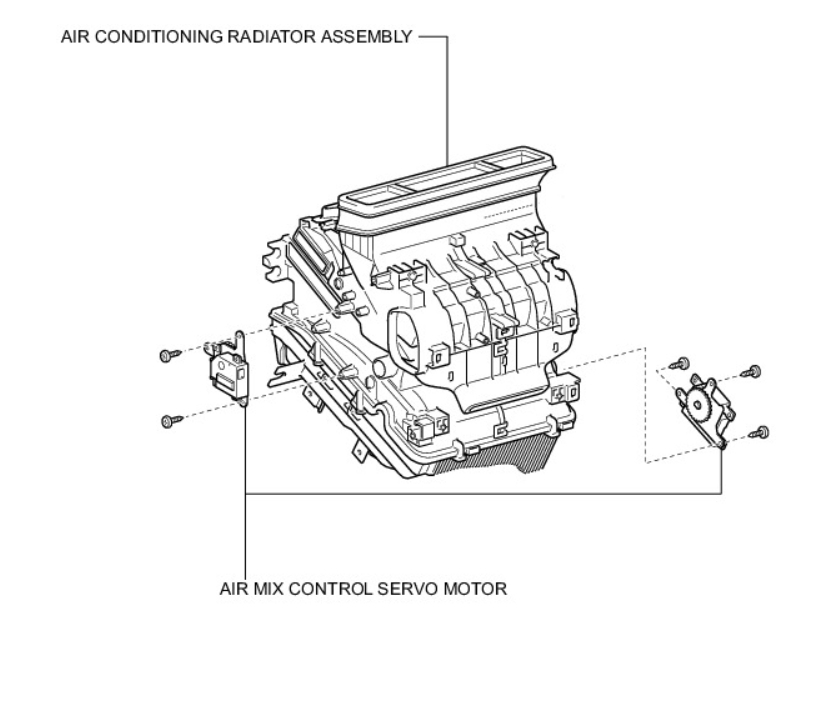

Can you please shoot a quick video with your phone so we can see what's going on? that would be great. You can upload it here with your response. Here are the blend door actuator installation instructions in the diagrams below.
