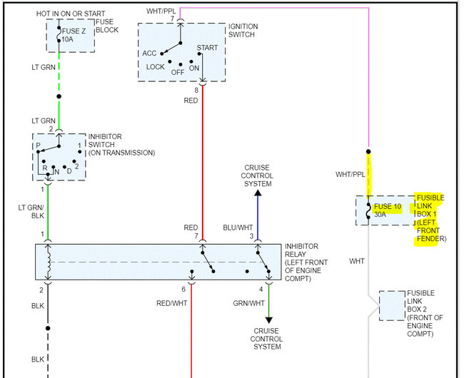

Now the starter won't crank to spin engine. Installed a new distributor, started for about 2 seconds, engine stopped.

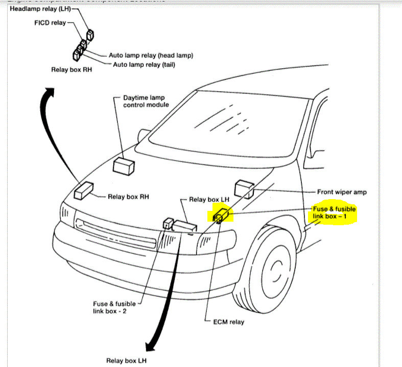

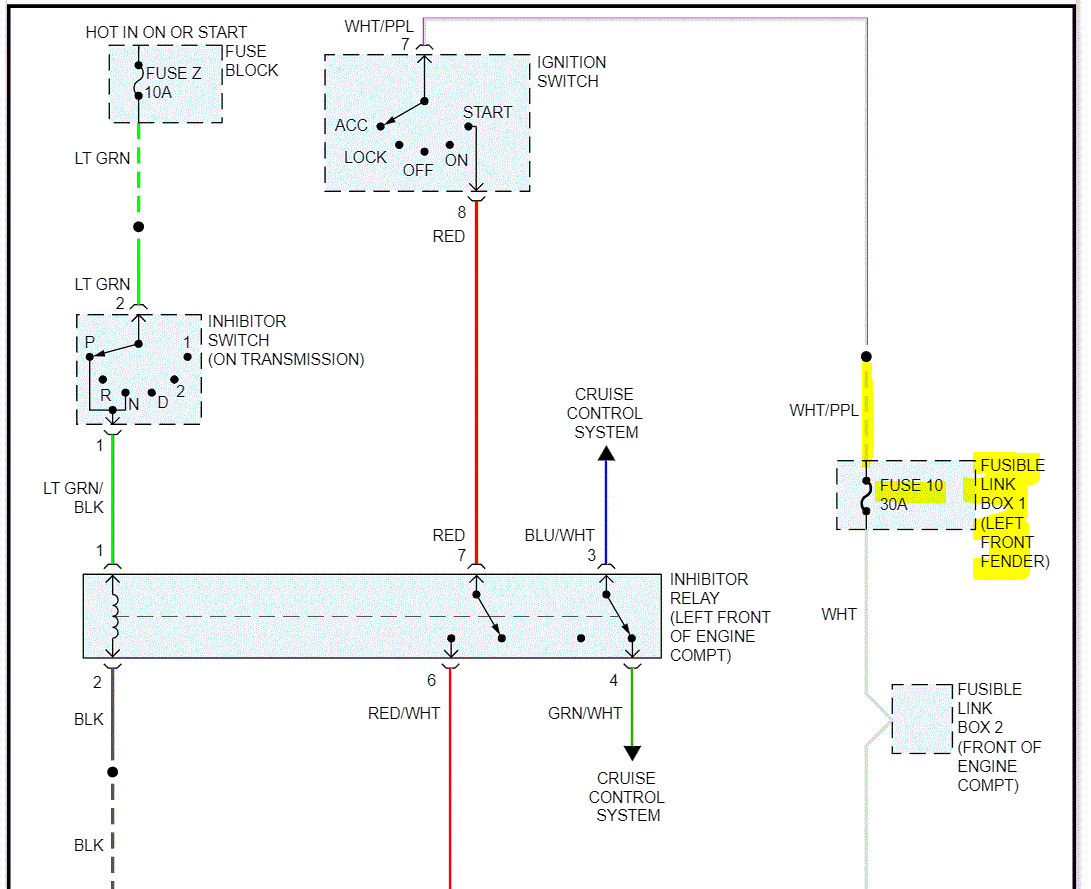

I attached the wiring schematics below. Also, pic 3 below indicated which fuse box to check. Check to make sure fuse 10 is good and there is power to and from it.

I do not hear the solenoid or starter make any noise at all and most of the dash lights go off completely when the key is tried. seems like a short at starting motor. checked the 30 amp fuse at battery, that's okay.. checked fuse panel in the vehicle, okay.

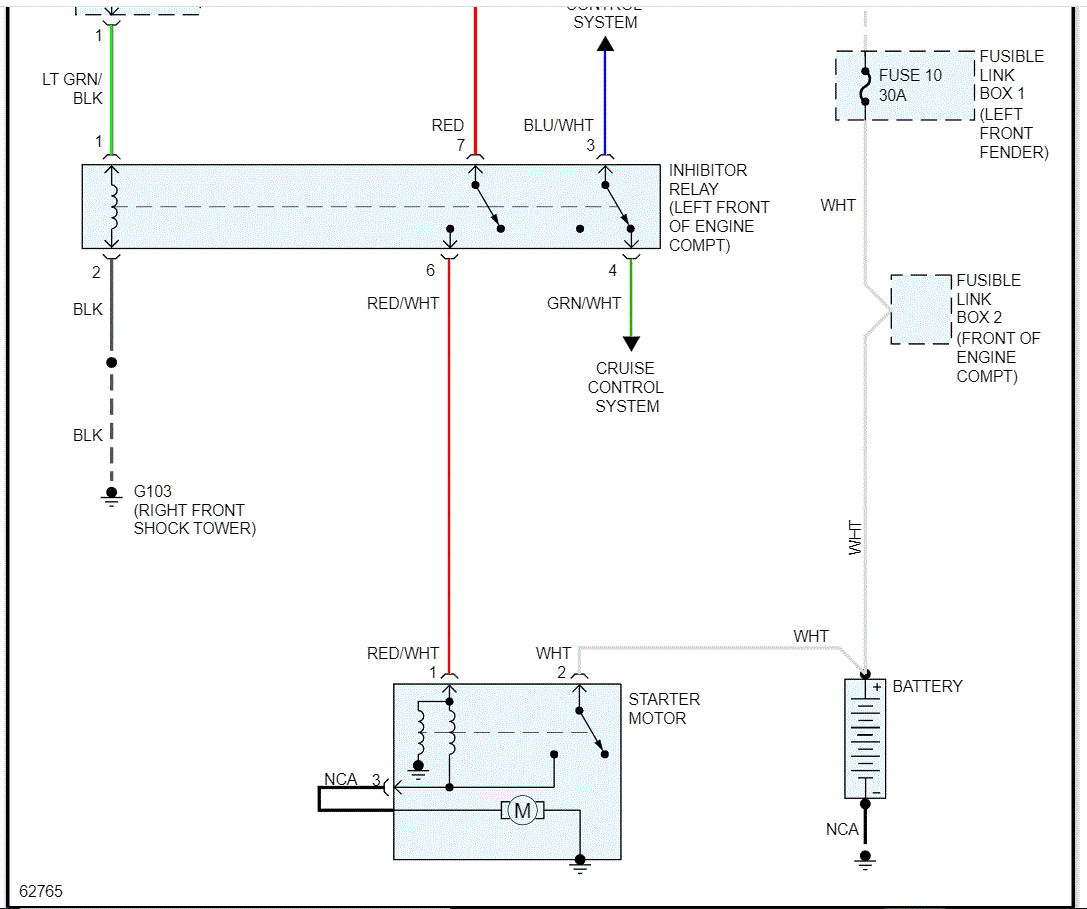

Since all power supplies are good and the battery is good, here is what I need you to do. At the starter, there will be a red wire with a white tracer. That wire has no power to it until the key is in the start position.
Have a helper turn the key to the start position while you check that wire for power. If it gets 12v, chances are the starter itself is no good. Also at the starter will be a heavier gauge wire that should have 12v at all times, so be careful not to short anything to it. Also, it may be a good idea to confirm that wire has power as well.
