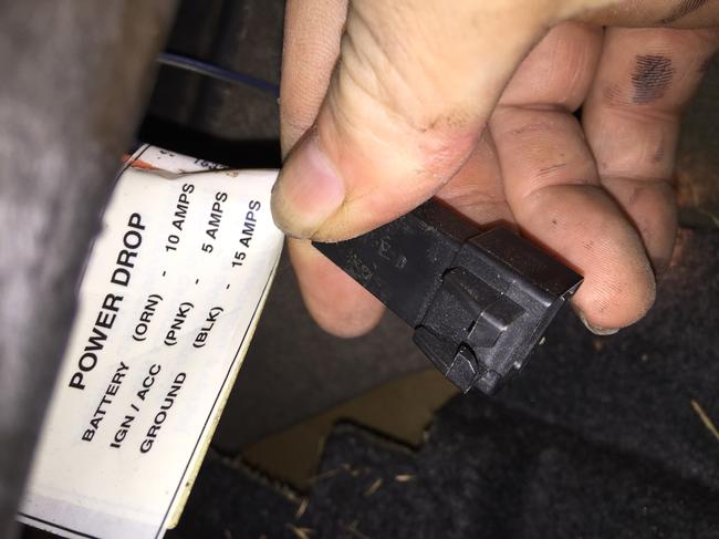

I installed a new blower fan in my Grand Prix, without any problems with the blower. However, I immediately realize that the radio would not go on and power locks did not work. The next morning I realize the rear defroster did work, either. I have check the fuses all three of problem systems that are fine. I went ahead and replace the fuse, but no luck. There is a wire harness behind the glove box that seem to no had a place to plug it in to. Could that be the problem?

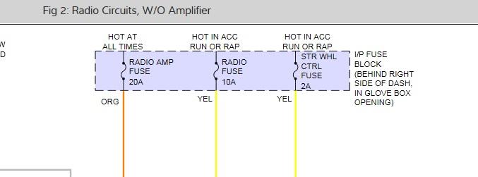

Here are your radio fuses w/o amplifier. Notice one fuse is hot all the time, the other two fuse circuits goes hot with key on. Use a test lite to check for voltage.
If you want diagrams for other circuits, I can do that also.

New blower works fine. Prior to installed it the radio, power lock, etc worked. The resistor still need to be replace, but some other time. I check voltage, the radio fuse had current when on, but the radio amp does not on or off. I do not recall any wires I plug, but I do have huge hand and might one out accidentally and reconnect it incorrectly. Any thoughts?

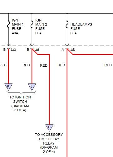

The fuse that had no voltage, that gets voltage from ignition main fuse 2, under hood fuse block.
That is for rap. May stay hot for a while after key is off, usually not very long. We may be wasting our time, checking that fuse.
