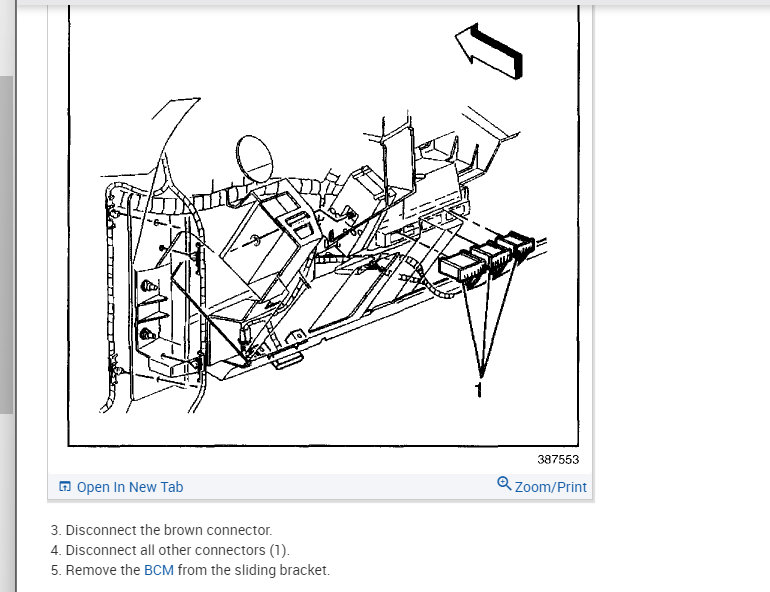

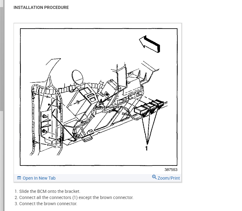

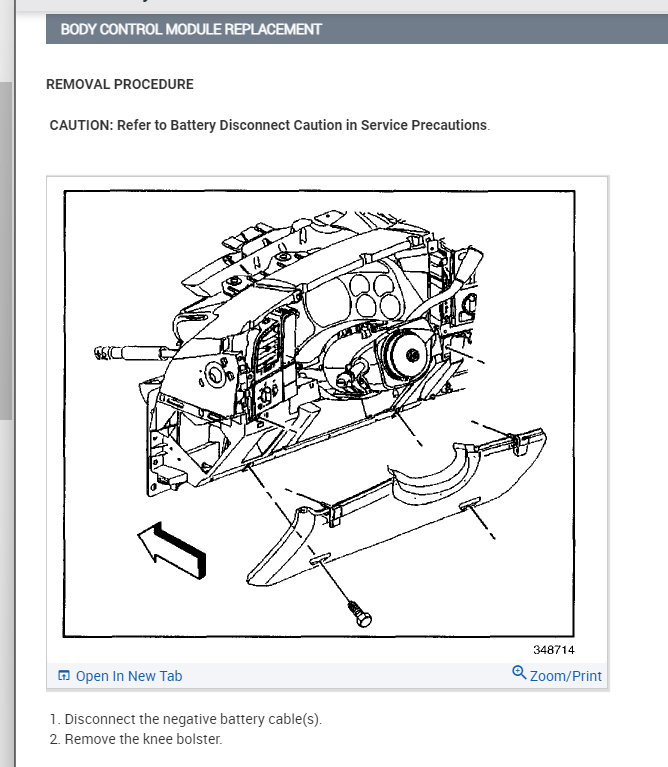

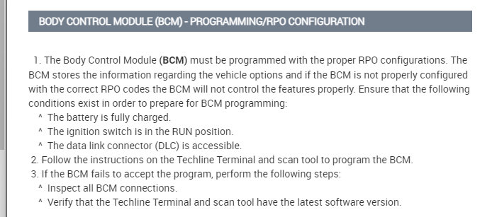

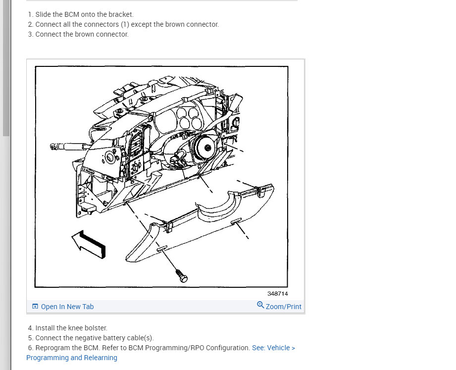

I bought a new body control module made by AC DELCO I need to know I can install it and how to program it to learn or work right. Without taking it to the dealership for on the vehicle flalshing
Mar 19, 2017 at 2:14 PM
Unfortunately, we need to download to the BCM how the vehicle is equipped for it to operate correctly. Otherwise, the BCM will not know how the vehicle is equipped and it will not run any of the functions.
Here is a guide that will help with this:
https://www.2carpros.com/articles/how-to-replace-a-bcm-body-control-module
Plus, please see the info below from the manual on how to replace and program the module.
Let us know if you have other questions. Thanks
